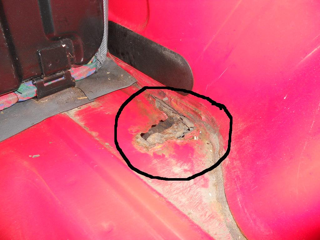

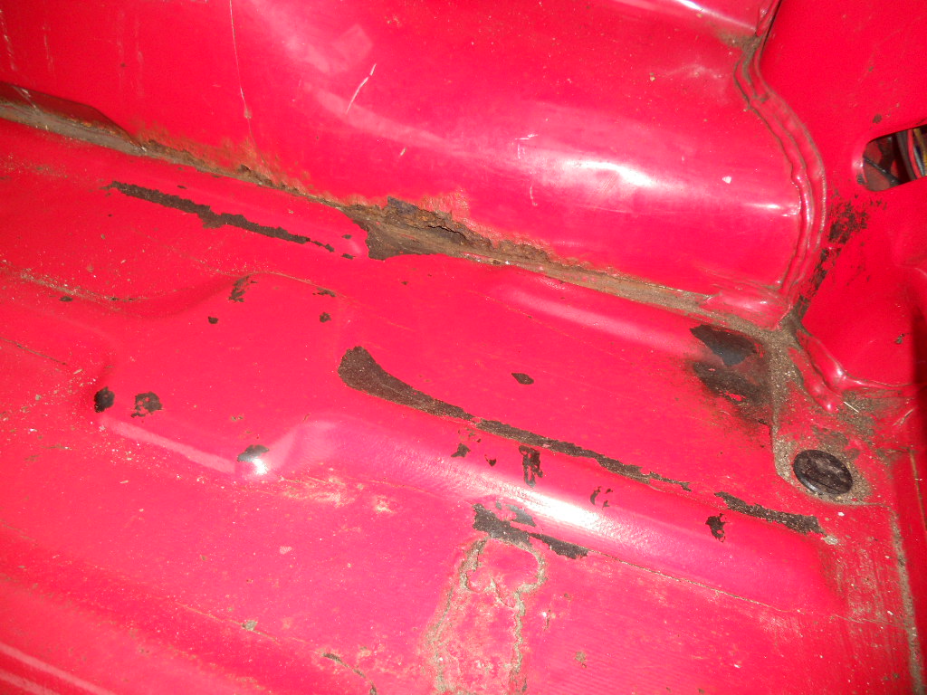

Whilst I am waiting to make my plans regarding the welding, what can I be doing to stop rusty areas getting worse, other than rub them down and treat them? Would it make sense for example where the boot floor meets the inside wall of the boot and is rusty, to cut the rusty bit out to stop it spreading, or is that best left to whoever is doing the welding?
I think it depends on how long it will be before you get the welding done. Any longer than three months and you may find a coating will start to fail before then.
Anyone doing the welding would probably want to cut the areas themselves so I'd advise having the work done ASAP. In the meantime Bilt Hamber do a cavity wax that creeps into welded seams so would probably give you the best protection in the meantime. It's called Dynax S50 and can be bought directly from their website.
It will need to be thoroughly cleaned off before welding mind, a welder might prefer it if you used a weld through etch primer.

Errrrrrr. I meant like in this area circled, or the seam odf the boot floor to the side wall .
Regarding the sills - the outer sills are mainly ok. It is the inner sill where it joins with the floor on the n/s that is worst. I wasn't planning on chopping the whole sill out and then just leaving it. I am just trying to do what is sensible quickly to stop the rot spreading where I can.
