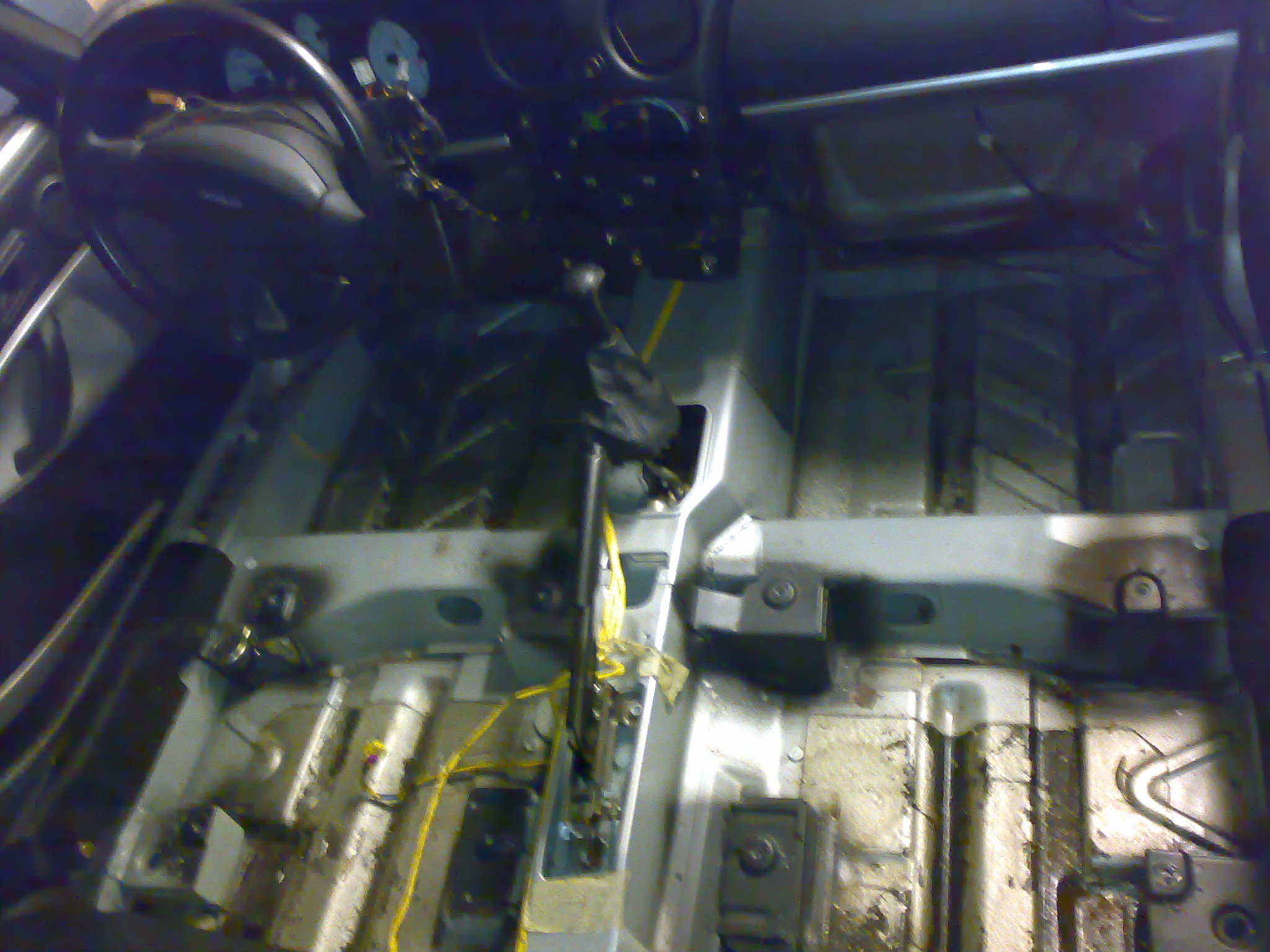

Ok thanks, here is a pic of the interior as it stands, sorry about the poor quality.

At the very front of the drivers footwell is soundproofing which goes up the bulkhead and a few inches onto the floor area.......lift it up and check for any rust under it, I found a few patches of surface rust under there which I had to treat to ensure no further corrosion.
Ok will do, thanks again. Funnily enough the drivers side was as dry as a bone, however the passenger side was soaked.
