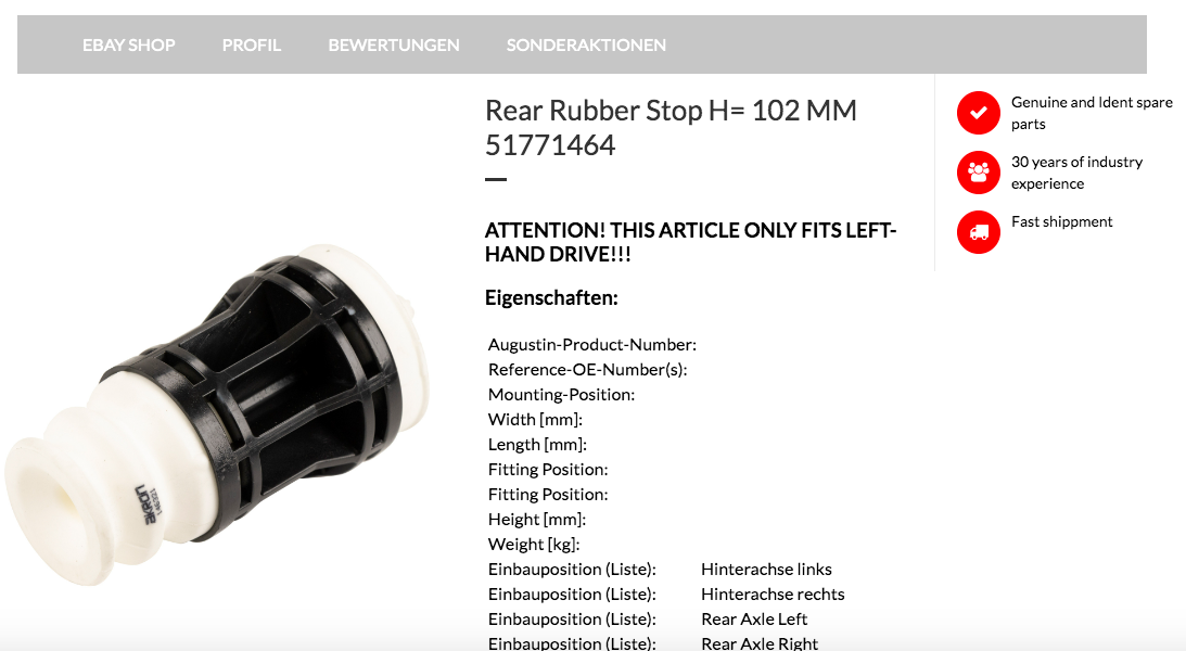

Are these the correct ones?
S4P8572 Rear Bump Stop

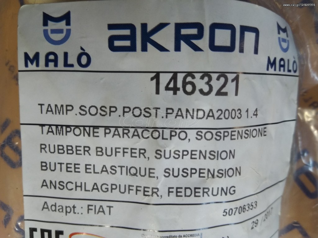

50706353 looks correct alternativeI still can't find the paperwork for my replacement bump stops, but my son's 56 plate 100hp had ORIGINAL IMPERIUM 25866 bump stops fitted about three years ago.
They are still going, so outlasted my Genuine FIAT ones that had been on a shelf for at least 5 years before they got fitted.
However the cross-reference part number shows as 50706353.
Where are you finding 50706353 for 16 euros? Best I can see is for 35 euros in Greece.
