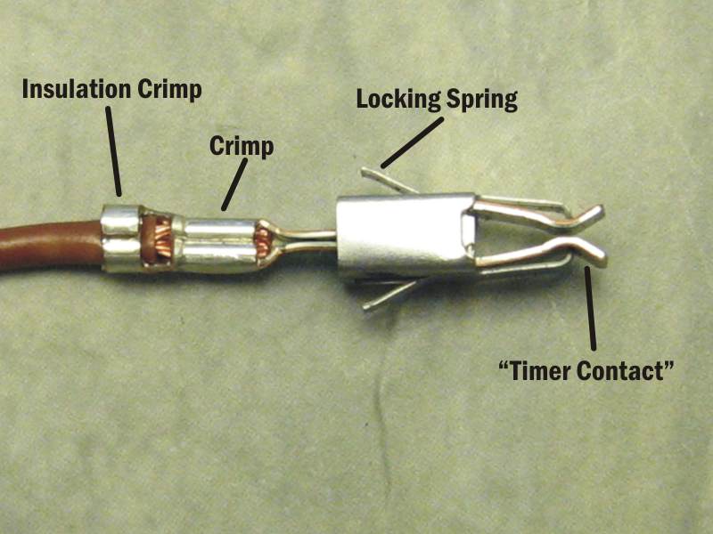

What tool crimps these junior terminals

The crimpers that others have shown are NOT the correct type of crimpers for timers like the one shown. They are showing you the kind for the cheap barrel crimps that you find at any automotive supply shop.
I use this kit:
amazon.com/Tool-Aid-18920-Ratcheting-Terminal/dp/B0002STTTI
This kit has a set of dies with it that will work, to a point. There are several different sized dies at the OEM level since there are different sized wires, I suspect at the OEM level, each wire size has it's own die, where as this kit the dies work a range of wire sizes.
No clue where you guys are, I'm guessing not here in the United Stated of Awsome America, but surely you would be able to find that same kit in your country.
If you've got a source of the bare terminals at a good price, then you've got a major leg up on my, sooner find priceless diamonds in my back yard than affordable bare terminals here.
Hope this pointless rambling (but useful info) is put to good use.
