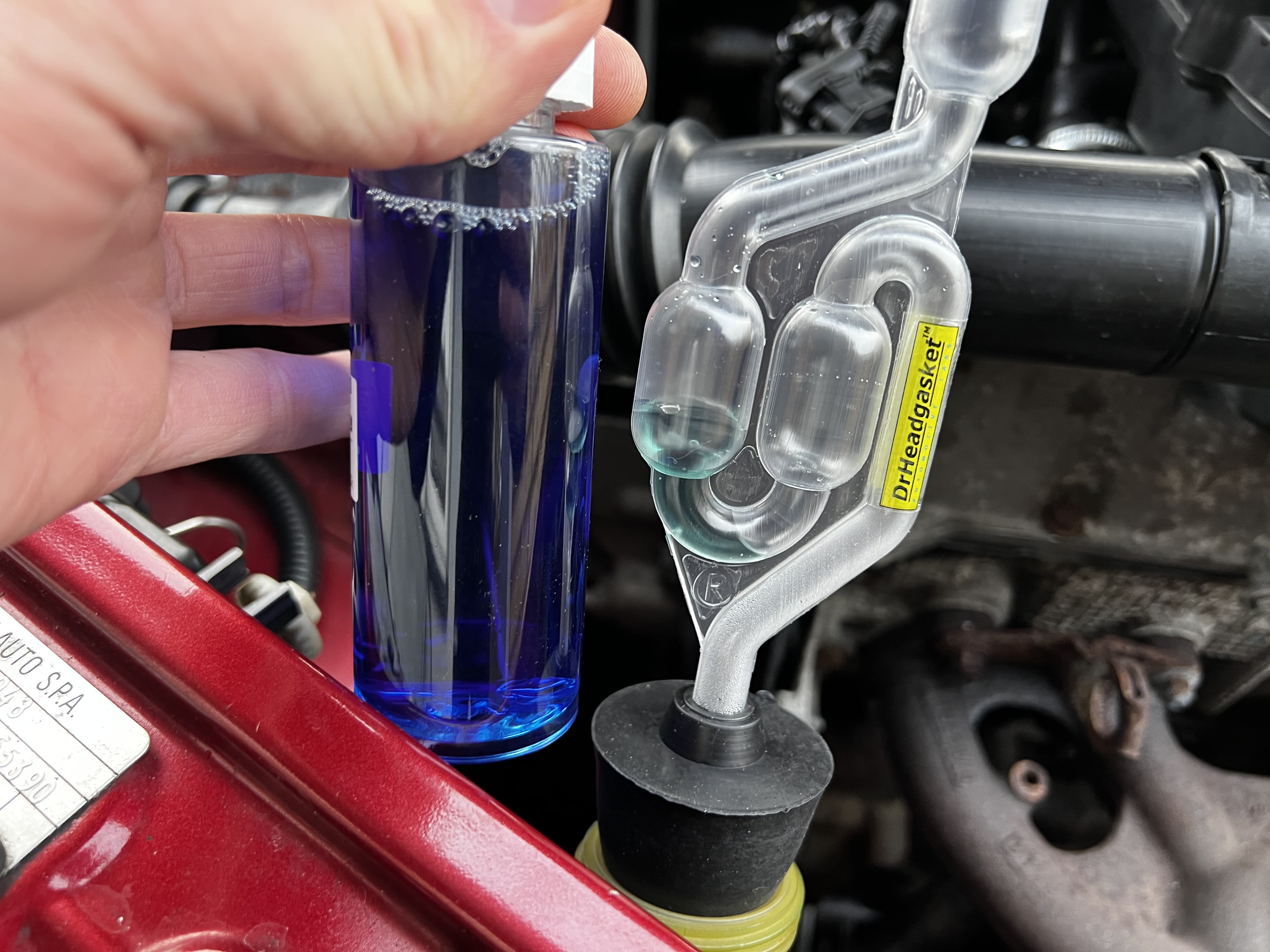

Small update just done combustion leak test and results ok (I think lol) it’s saying if there is any leaks on head gasket that fluid should turn yellow… it’s from eBay called dr head gasket
