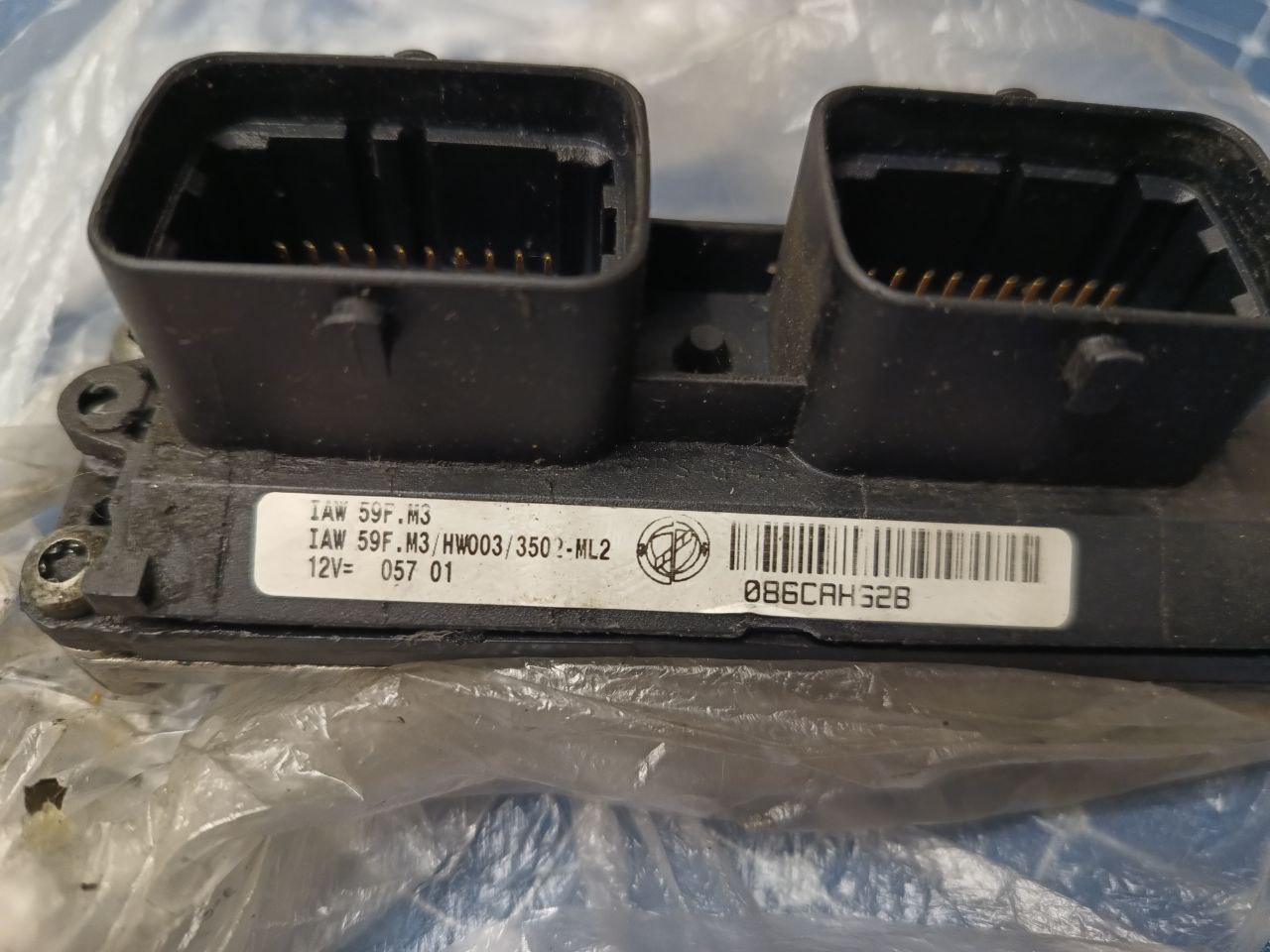

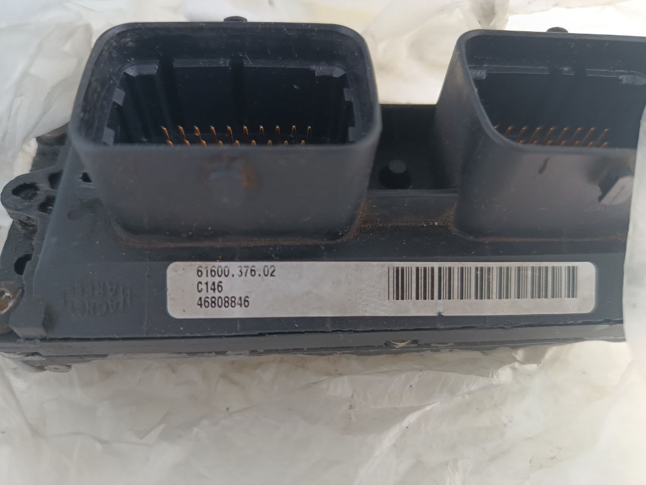

I also need to replace mine, but I'm somewhat confused... Here is mine:
Which numbers here HAVE to be the same, which ones can I just ignore and which ones can be replaced by others? You mentioned that HW003 can be replaced by HW303, which is better, but what else should I look for?
Still one left from the buyer I bought mine from. It needs to read IAW59FM3 and then hw303
