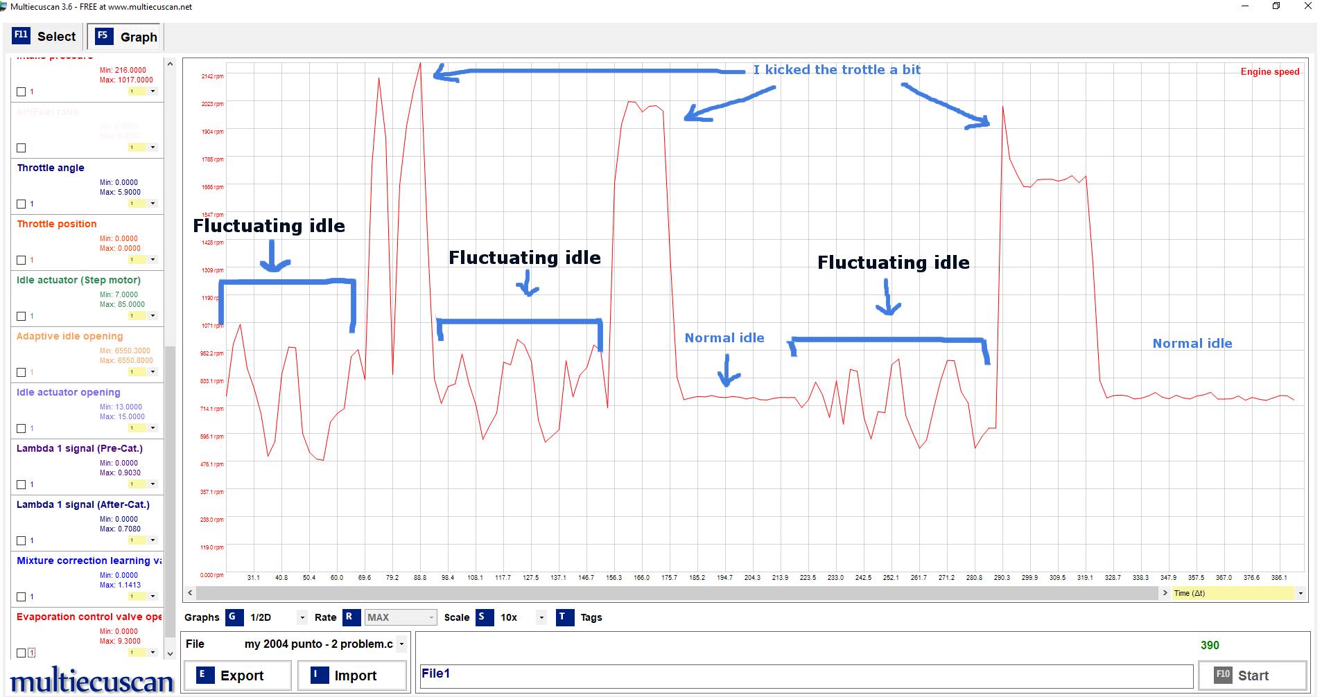

For your original problem, idle shaking, here is the solution:
