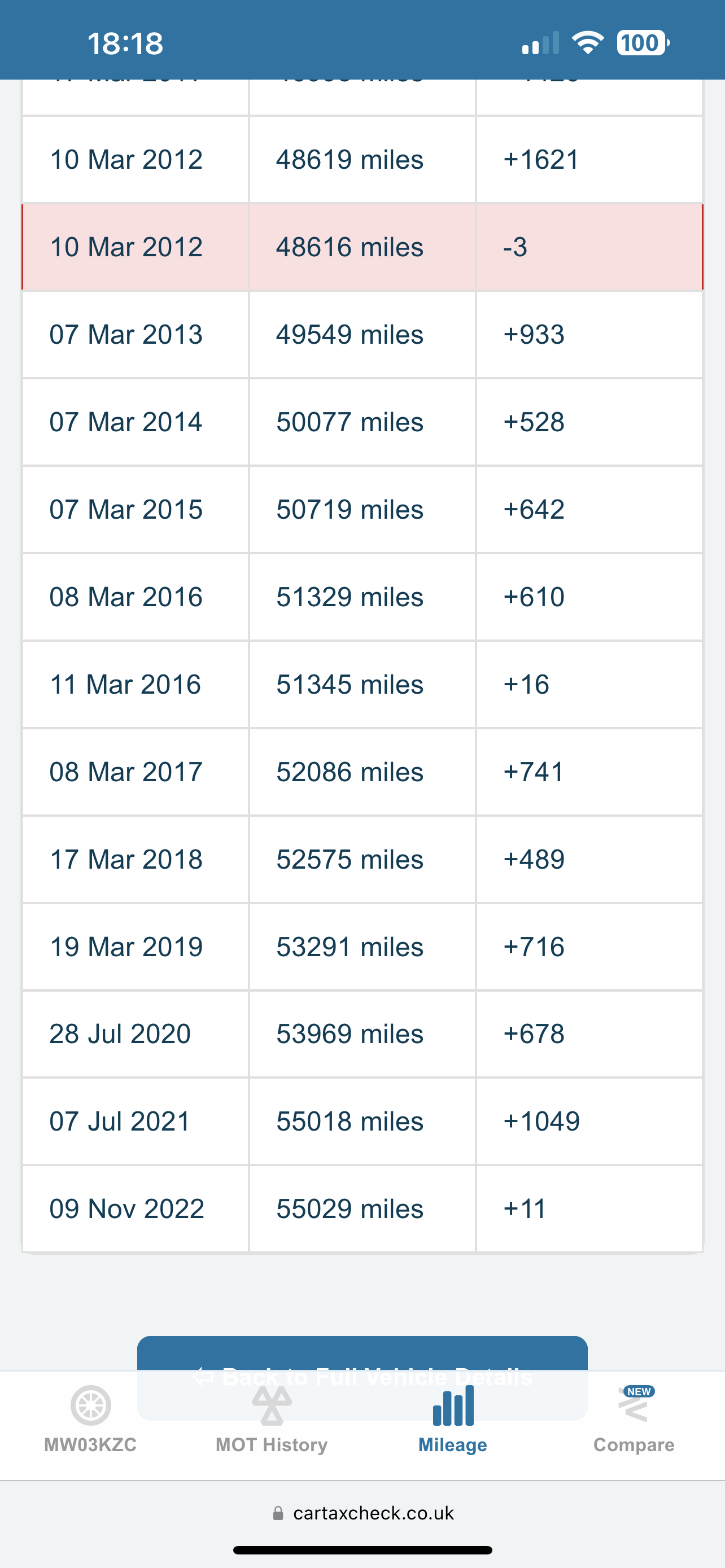

That’s makes sense, the previous owner an old man, if you go through Mot history looks like he was literally going only church and shopping… šŸ¤·šŸ»ā€ā™‚ļø
For some reason there is an negative value in 2012 for some reason šŸ¤·šŸ»ā€ā™‚ļø

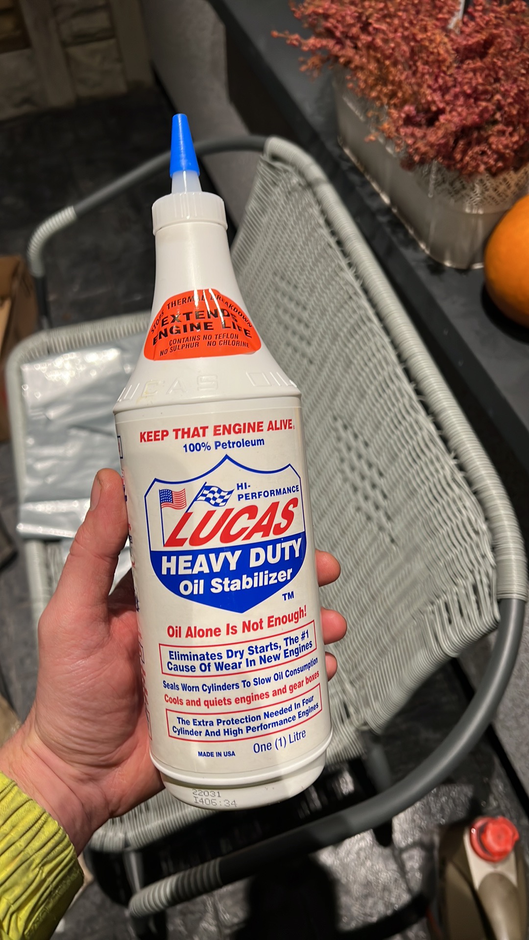

That’s the oil I bought:

We use that in our knackered tractors and dumper, no way would I stick it in a daily driver, especially not in winter…it’s so gloopy it doesn’t circulate till very warm which, if you want an additive to work, you want to make it work from start
So you recommend to drain it and refill with just oil? To be honest the guy from car parts shop told me to add whole bottle at once so if engine need 2.8l oil minus 1 liter of that Lucas stuff I added there is only 1.8 liter of oil and rest is that Lucas stuff. It’s sticky as hell…
It’s only knocking when it’s warm properly tho
I’d drain all the oil and filter, put engine flush through it, refill with correct oil…if you want to stick an additive in then pick one that works throughout the temperature range or is recommended for cold starts (as in environment)
We use the lucas stuff in big old tired engines, we also use their hydraulic conditioning/leak fix stuff as, as you know, farmers like to get every last value out of something, but only if it doesn’t cost a kidney
