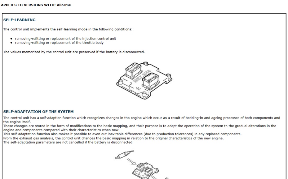

The document, shared here in the forum, says the ECU implements the self-learning mode when the throttle body is changed. So, has it already taken place?

Not sure why disconnecting the battery could be a factor, since the Bosch Motronic says the data is kept even after the battery is disconnected.

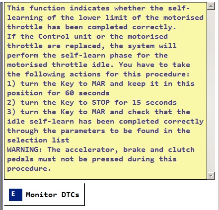

Today I noticed that MES lists this procedure to trigger the self-learning of the throttle body
  1. Turn the key to MAR and keep it in this position for 60 seconds;
  2. Turn the key to STOP for 15 seconds;
  3. Turn the key to MAR and check that the idle self-learn has been completed correctly through the parameters found in the selection list. - Using MultiEcuScan. Warning: Pedals must not be pressed during this procedure.
