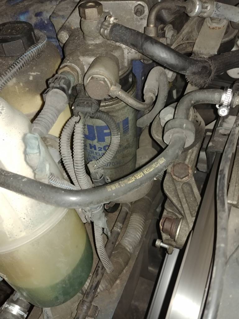

The fuel filter does look pretty old from the outside appearance and there may be a slight weep of diesel on the top there.
How awkward are they to change? Do you take the housing off the bulkhead to improve access? Does it have a lift pump to help purge the new filter of air or do you just have to fill the filter as much as possible with new diesel? 20190117_193701.jpeg
From what I've seen, there are quite a few variations of filter fitted to Multis. You should find a drain-off on the bottom of the canister; perhaps also a wired sensor that is supposed to detect moisture in the fuel and subsequently fire up the warning light on the dashboard, that's famous for going off in error because of a short in the wiring...
They are awkward to change, mainly because it's tight for space underneath them. It's often easier to unbolt the mounting casting from the bulkhead so that you can tilt the whole set up.
Measure the canister that's on there and then go online for a replacement. Also check what the connector at the bottom of the filter looks like. I've bought filters of the wrong size before now because I relied on the online product selector gizmos, only to find the filter wouldn't fit.
The Liquid Moly stuff is also good for dispersing any water in the fuel, so I'm told, so might be worth using even if you do take the injectors out for cleaning.

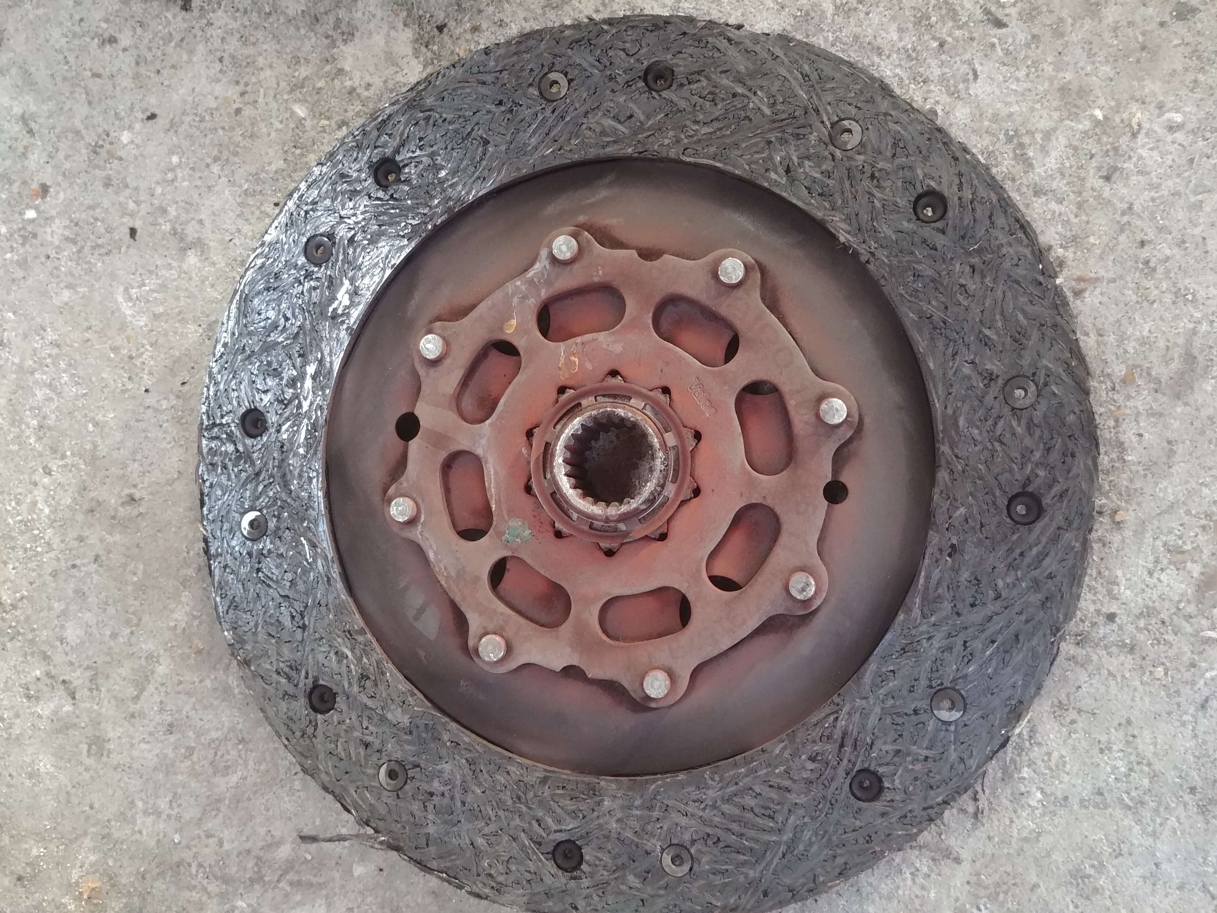

The loss of power issue hasn't returned, I changed the fuel filter and filled with the liqui moly injector purge stuff that WMF recommended. The MAF has been left disconnected and in summary it was going quite well - albeit with a slipping clutch.

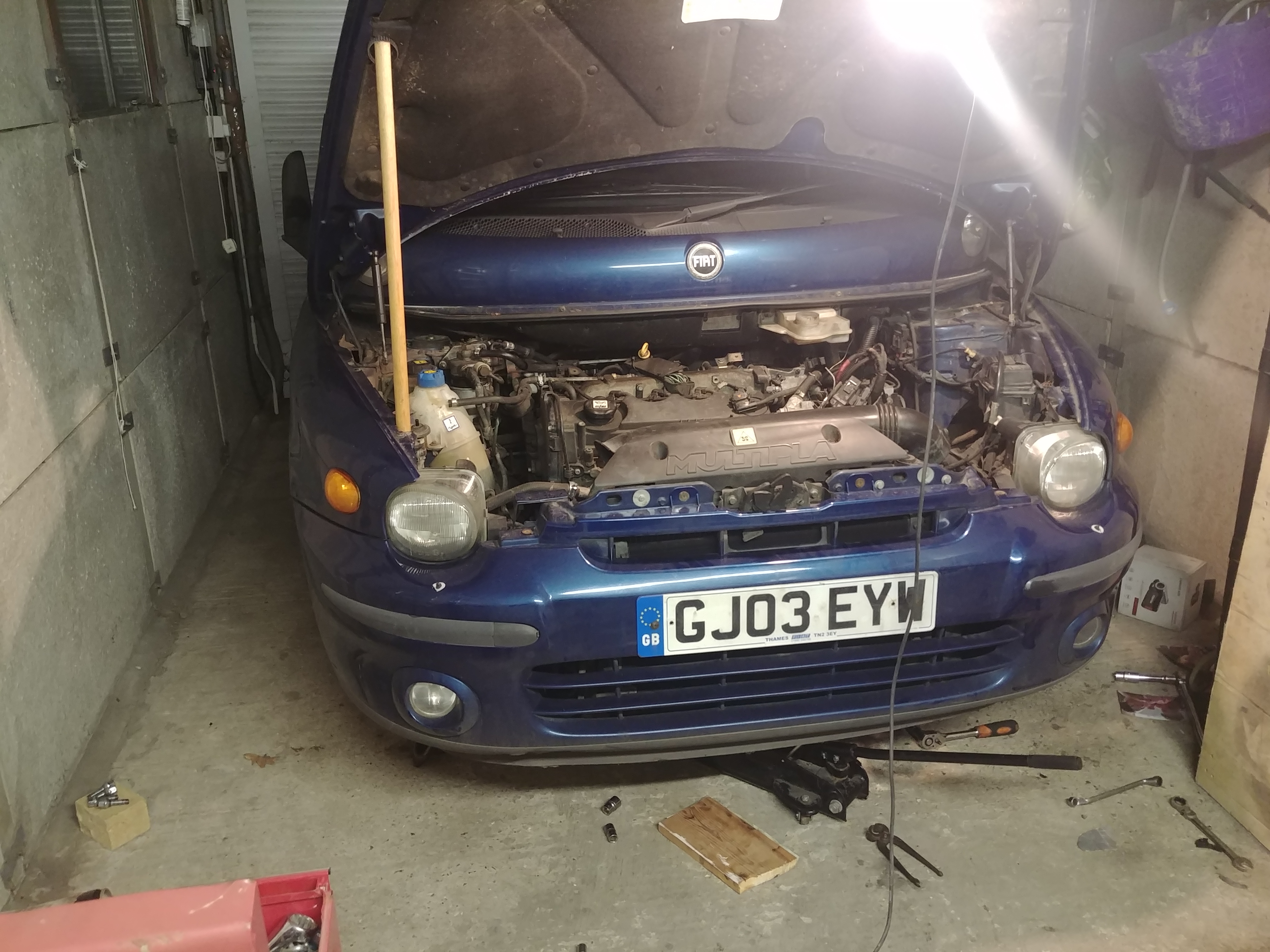

So I bit the bullet and swapped the clutch for the Mintex clutch I bought off ebay for £35. Put in some Comma gearbox oil (just under 2 litres) and splurged a whole can of brake cleaner. £60 worth of bits and 14 hrs to fit! I was on a go slow.

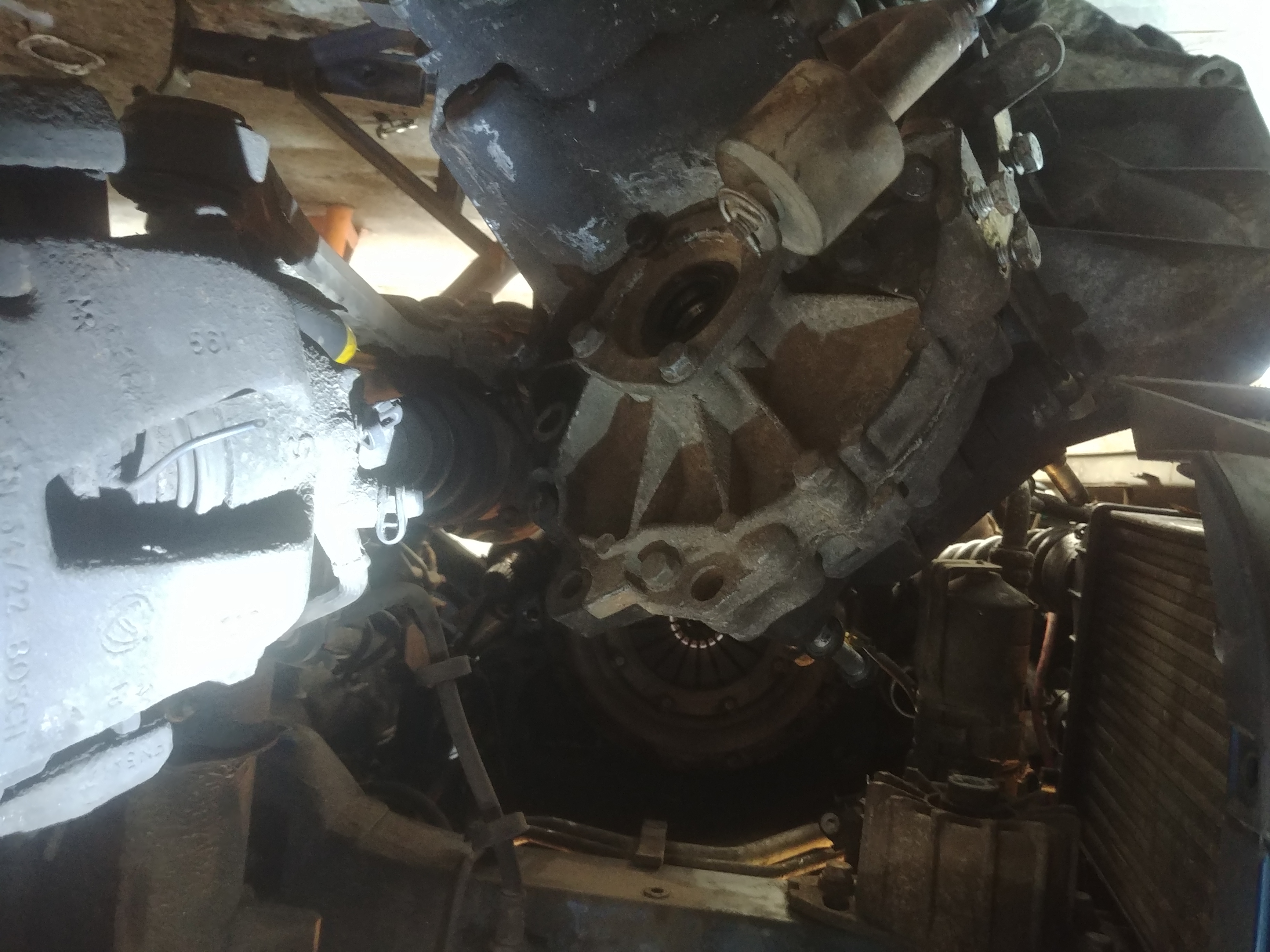

This is my second multi clutch so I was hoping to do it faster but I came across 3 stumbling points:
1. Lifting the gearbox back into place on my own. I tried to pull it up from above with both arms in the space made by removing the battery tray and airbox. It was nearly impossible, in the end a wooden lever under the box allowed me to lift it in baby steps, with a chain to support it from above when I needed a rest or a think.
2. The race of the centre bearing carrier on the offside driveshaft was mis-aligned with the bearing housing. I overcame the issue by reconnecting the rear lower engine mount and playing around with a jack under the sump and a crow bar on the driveshaft. Eventually it slid into place.
3. As I couldn't slide the offside driveshaft back it was impossible to put the offside lower ball joint back into the bottom arm. Anyway, once I got the centre bearing done it was relatively easy. It's another job where you need two sets of hands - one set to pull down the bottom arm and another set to manoeuvre the hub back onto the bottom ball joint.
So that was finished on the weekend so I've driven about 250 miles on the new clutch now. It has loads of bite as it first engages and doesn't slip at motorway speeds any more. I have the wider coupe alloys fitted at the moment so it hasn't managed to lose traction yet.

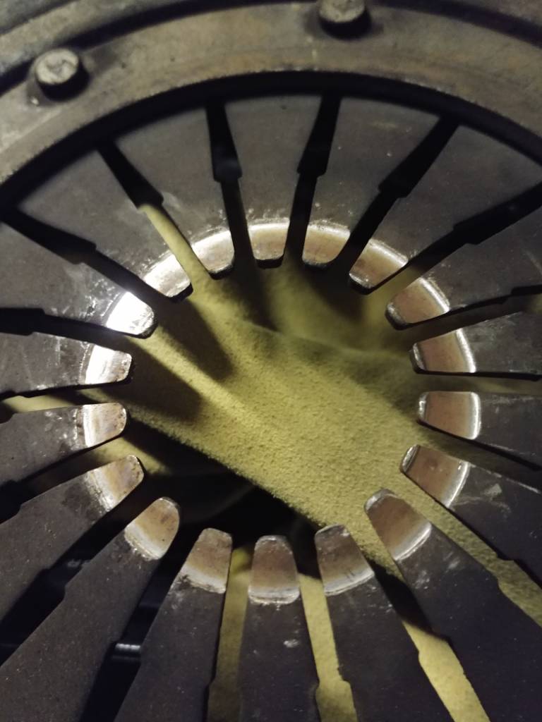

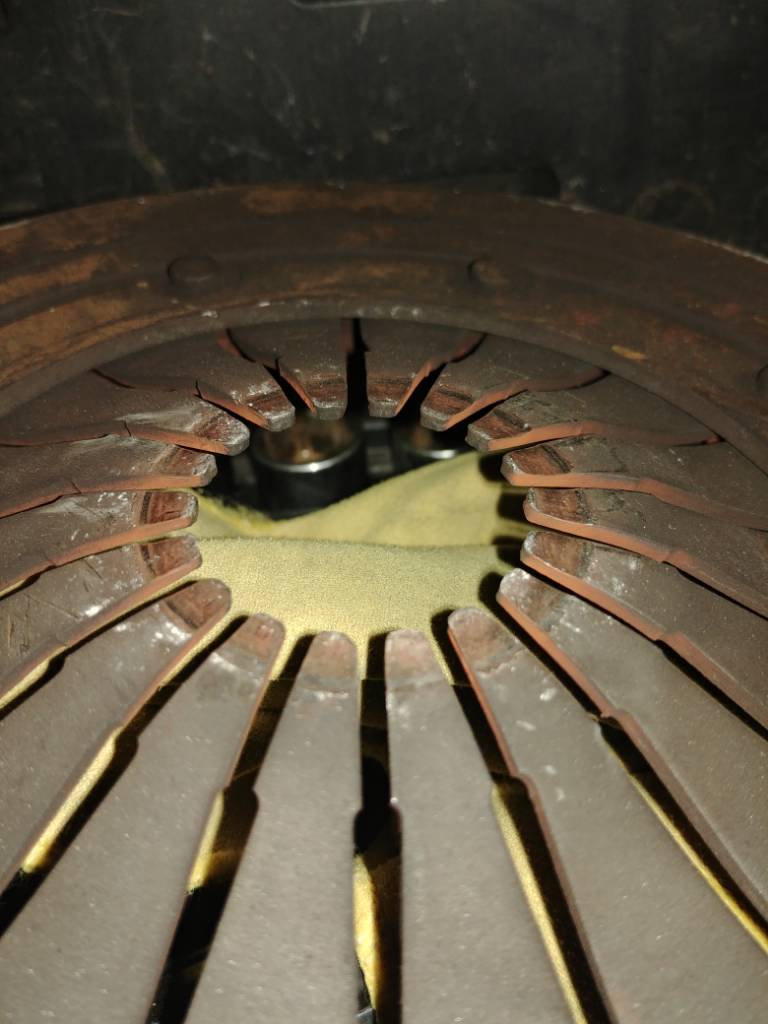

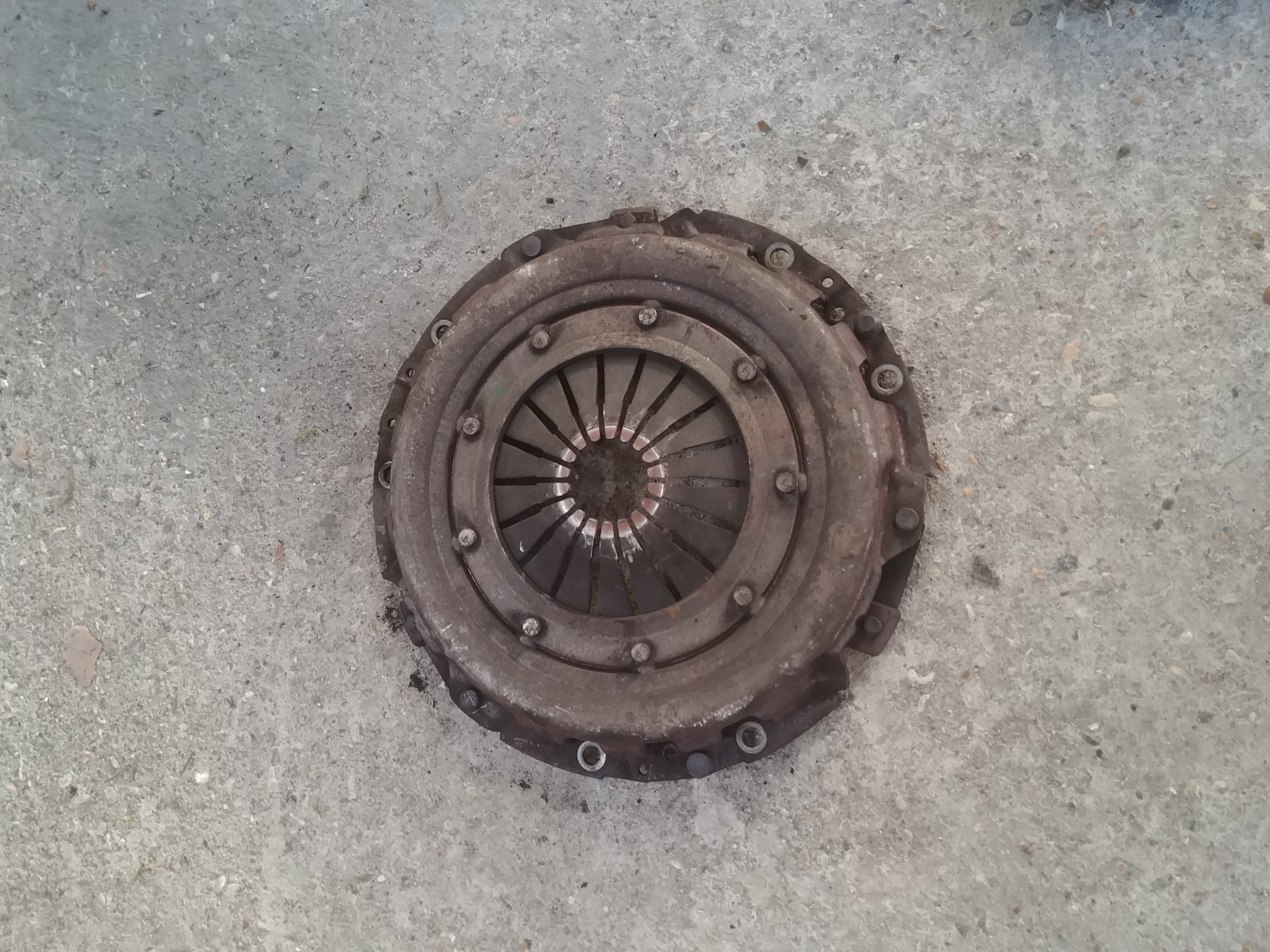

Nice to see it's back up and running (y) Any close-up pictures of the condition of the fingers on the out-going clutch and the condition of the guide tube that goes over the gearbox input shaft?
What is Galletto 1260?!
yes i'll grab a close up of the pressure plate tonight, in general the front face of the fingers where they contact the release bearing were worn.
The guide tube, do you mean the stainless tube over the base of the input shaft of the gearbox? If so it looked ok - but no pictures i'm afraid. do they wear?
Yes, that's the one. It holds the release bearing concentric to the clutch fingers and doesn't usually get replaced. On many other cars, it's supplied as part of the clutch kit, but not on the JTD for some reason. As I mentioned in another (or this?) thread, I've my suspicions that wear of the guide tube may, at least in part, be responsible for premature wear of the clutch, especially the release bearing.

Hi WMF, not sure what you wanted to see?View attachment 198228View attachment 198229
Just wanted to see how bad the wear was. It doesn't look too bad at all in this case. I've seen them where the fingers were worn away to less than half of their original thickness. Was the release bearing still running freely?
I'm not sure how a worn guide tube would affect the wear of the fingers. Because the fingers are rotating, even if the release bearing was allowed to stray off-centre or to start pressing at an angle to the input shaft axis, the wear pattern on the fingers would still be even all of the way around. I guess the outer diameter of the groove witness would increase?
There are several 'modes' in which the clutch can fail on the JTD. If you're getting clutch slip in 3rd and 4th gear under full throttle, then it's fair to expect the problem to be a worn friction plate. However, a lot of others seem to go TU because one runs out of clutch pedal travel - it gets very difficult to get the car into 1st/2nd/reverse. If that's the case, I don't think the problem is a worn friction plate; it's more likely down to a knackered release bearing and/or worn fingers, or air trapped in the clutch hydraulics. Equally if the clutch hydraulics are not allowing the release bearing to fully retract, the guide tube is worn and making the release bearing stick (or the driver has a nasty habit of resting their foot on the clutch pedal all the time!), this is the more likely mode of failure. The hydraulic set-up on RHD Multis isn't adjustable (unlike the cable arrangement on LHD ones), so doing something to correct the problem is difficult.
