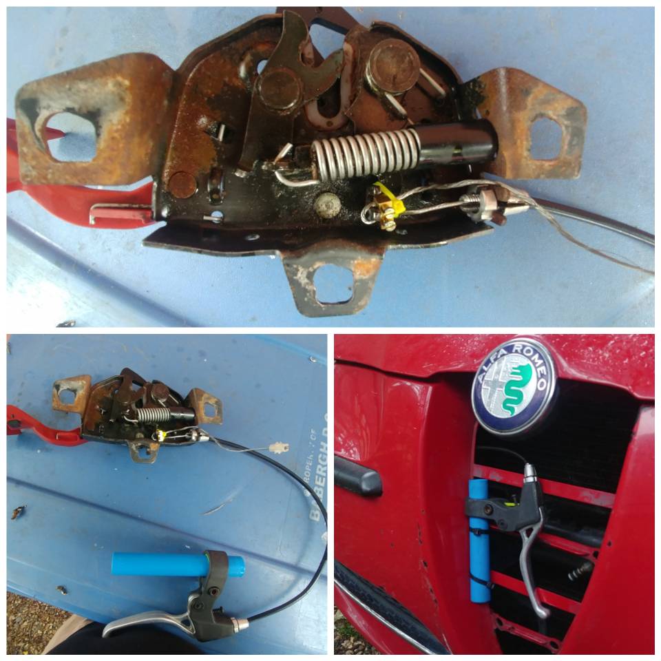

No Multipla news - it's going great. However the Alfa 147 is doing typical Alfa things. The battery strap retaining bolt had sheared so I had to remove the whole battery tray and grind off the remains of the stud. While I was there I discovered much more rust around the top of the front strut towers. This is a 2005 car! Also, typically the bonnet release cable broke, I was inventive with the fix and my lads brakes are now 50% less effective. inCollage_20190706_184927350.jpeg

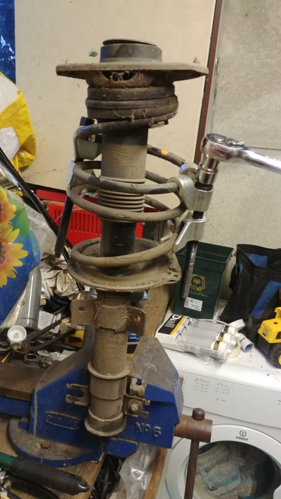

As for the spring compressors, treat yourself to one of these kits, or similar, if you haven't already got one:
https://www.ebay.co.uk/itm/Fork-Strut-Coil-Clamp-Spring-Compressor-Macpherson-Tool-Set-Kit-Auto-Garage/254290651831?hash=item3b34e76ab7:g:rh8AAOSw7OFdI~pR
I bought a Vida XL set a few years ago, which looks identical, but their prices have shot up. As a result, I can't vouch for the quality of the one above. BUT - this type of spring compressor makes a job that puts the fear of god into us mere mortals into something of a doddle. Almost a pleasure, in fact. At no point do I think "If this lets go, I'm toast....", and as long as you keep the main screw well lubed with lithium spray grease, it also requires very little effort. You can halt the movement of the spring with very fine control, which allows you to get the rubber seats that line the spring pan into exactly the right position.

Springs compressed, strut dissassembled, springs compared.

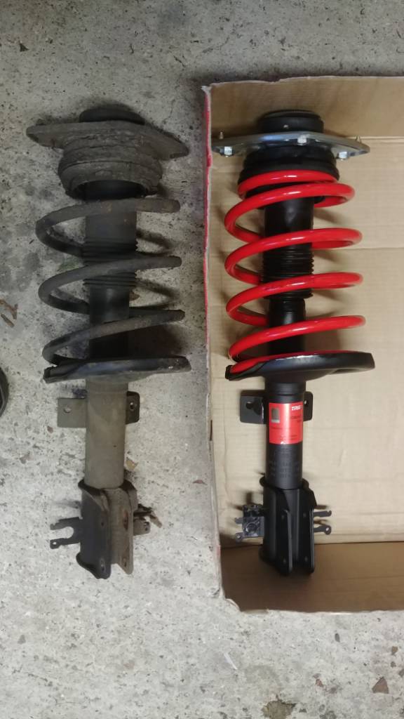

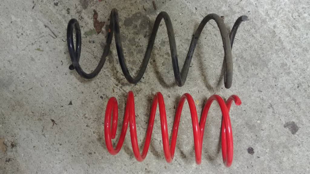

Substantial difference in free length (correct term?) and wire thickness is a good mm larger. Shock wasn't bad at all from my rudimentary test but I have new to fit anyway. I'll try to assemble the whole shock this side and compare to the stock passenger side in a future post.

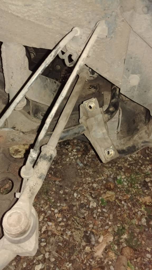

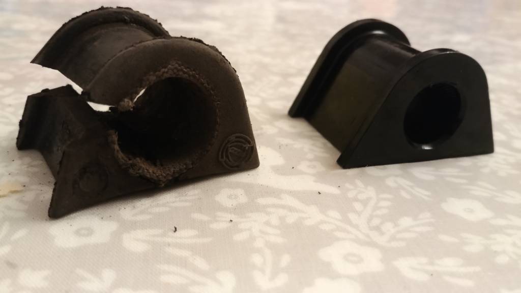

More progress last night. One shock fully assembled and looking resplendent. Passenger shock off car. Both drop links now removed - total PITA. Also unbolted one anti roll bar bush - definitely where the squeaking from inside the car was coming from. The bush was loose on the shaft (snigger) so that the whole bar can slide about and rotate freely. Have some bits coming in the post to sort this.

Yep, that's the ones. If you look at them closely, you'll probably find that they're a very hard plastic, as half-rounds. I thought they were metal, and welded on, until one fell off of mine :( I don't know how Fiat fix them on. Presumably they were trying to avoid welding, as that would add undesirable local stress to the surface of the bar which could lead to fractures.
Good ok, well I have at least one side still present! The paint has worn off the ARB where the bush sits and it's nicely polished. The bush was very easy to slip along the bar. I've ordered some new ones.
https://www.superflex.co.uk/proddetail.php?prod=SF475-0022K
I went for 18mm without actually measuring the bar. You've got to drill out the sort of rivet/welds that hold the metal parts of the bush together then presumably grease up the bar and slide the bush over from the drop link lug as there isn't a split in the picture on the superflex website.
In my head I thought the mk2 Eleganzas had thicker ARBs - may be that's the 19mm and the mk1s had 18mm.

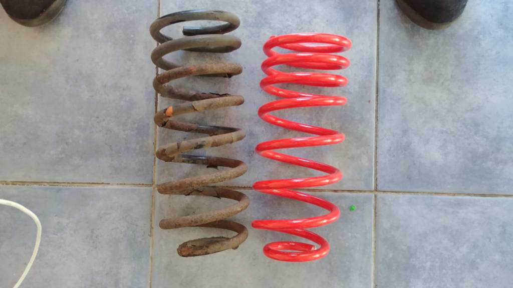

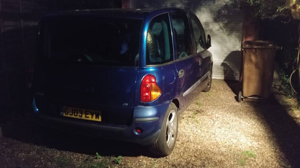

Nearly done the rear, I took out the shock bottom bolt and jacked the rear way up. Levered the spring out with a crow bar. Took the oportunity to roughly derust and paint the end stops and surrounding area of the subframe. The nearside was in much better condition and still had plenty of black paint on. I wonder if it's because it's near the exhaust so dries out more frequently(think WMF has mentioed this before?). Wrestled the new springs in with the crow bar and dropped it back on its wheels.
Typically I've lost a washer or two from the shock bolts so will have to scrounge some from work today. Doesn't look much lower in the pic but I'm pretty sure it is.
I can see much easier over the roof now. To be honest this wasn't about being all stancy pants, I was trying to get stiffer springs and reduce body roll. Still have to do the timing belt and water pump then I can sell the Alfa and get this back on the road. May even treat the Bug to an air con regas and wheel alignment.
