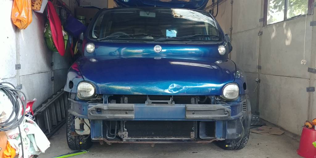

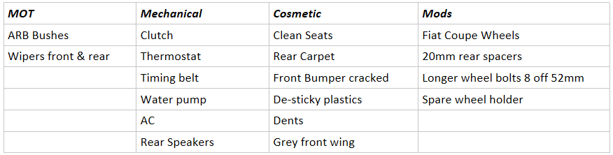

To do list on #3 (Double Ugly):
Drive home from Kent was in the dark and raining - well known best condition to buy cars in.
It was quickly apparent that the wipers were awful, the tyres though new had limited wet performance (Wind Galops anyone? me neither), and the clutch though providing forward progress was slipping during every gear change. It's not slipping up hills but i'm guessing it would fail the dealers 'clutch up in reverse with handbrake on and see if it stalls' test.
Vincenze recommended the timing belt be changed as a precaution and from previous experience i'll do the water pump at the same time.
The temperature gauge didn't go above 1 bar which is normally a sign of a stuck open thermostat but i might plug in Multiscan ECU to double check any other sensors. That's about it mechanical wise, the rear speakers were a bit farty and it'd be nice to have AC one day.
Outside the paintwork needs a proper cut and polish, and generally every panel has a dent somewhere but i'm not too fussed. Front bumper is cracked though and though i initially was going to live with the mis-matched front wing i've sourced a replacement in the right colour so happy days.
Inside its going to need totally stripping, cleaning and refitting. A tin of paint went over on the rear carpet so i've got a replacement coming from the local Fiat breakers.

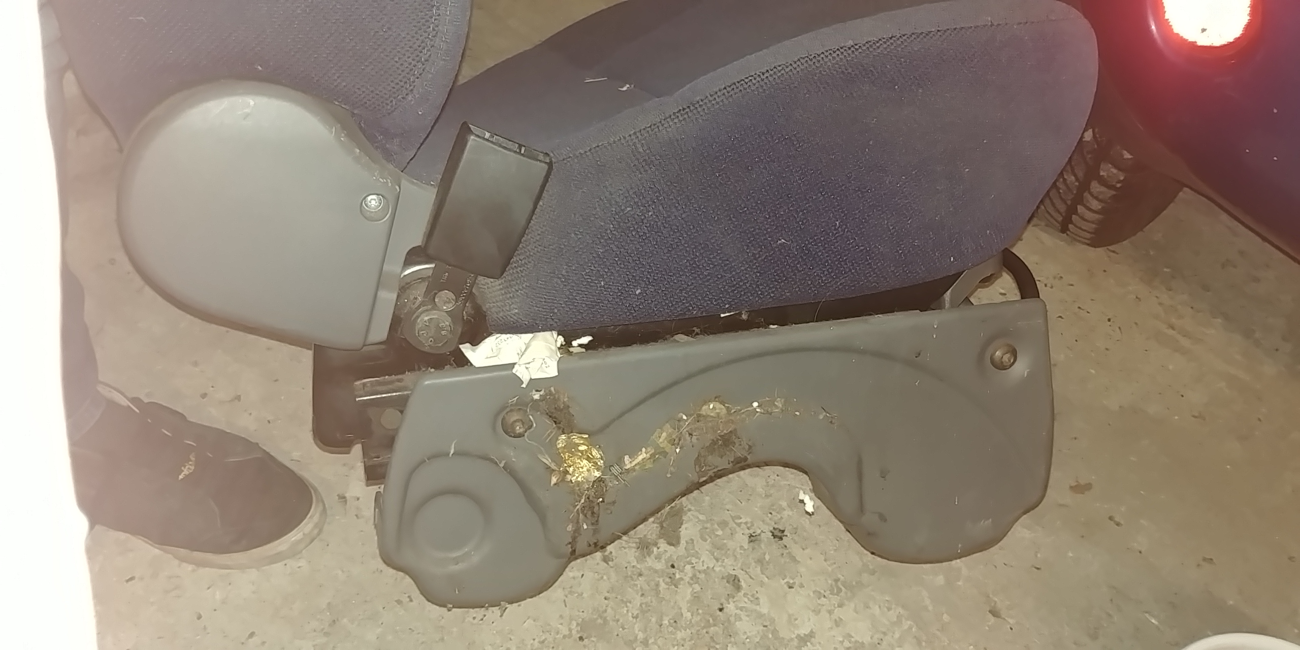

How big a job is it to get the seat covers off? Complete seat dismantle? think mine would benefit from a wash.
I did just the base. Couldn't work how to get the back rest covers off. To get the seat base cover off you need to start with the recline/fold lever. The surround is just clipped with two tangs you can see by lifting up the lever. Wiggle off the surround then unscrew the phillips screw holding the plastic cover to the lever. Once that's off you just have to push the cover down towards the bottom of the seat and release the black plastic trim all around the edges. As you release the edges you'll see the seams on the seat are held in with 5 wire rings and 2 bits of velco. Was a pain but worth it in my case. I'll take pics when doing the next one and post them here. Nice to know if anyone has got the back cover off?

Thanks widemouthfrog for the heated seat link. Now managed to get the seat back covers off too. The plastic tray on the back of the seats need to come off. There are two plastic push in screws that hold the top of the tray to the frame and then two legs at the bottom which just slide in. Had another look at the headrests and i can't work out how to get them apart so they'll be just wet-vac'd.
So two sets of covers going in the washing machine tonight leaving just the front covers to do!

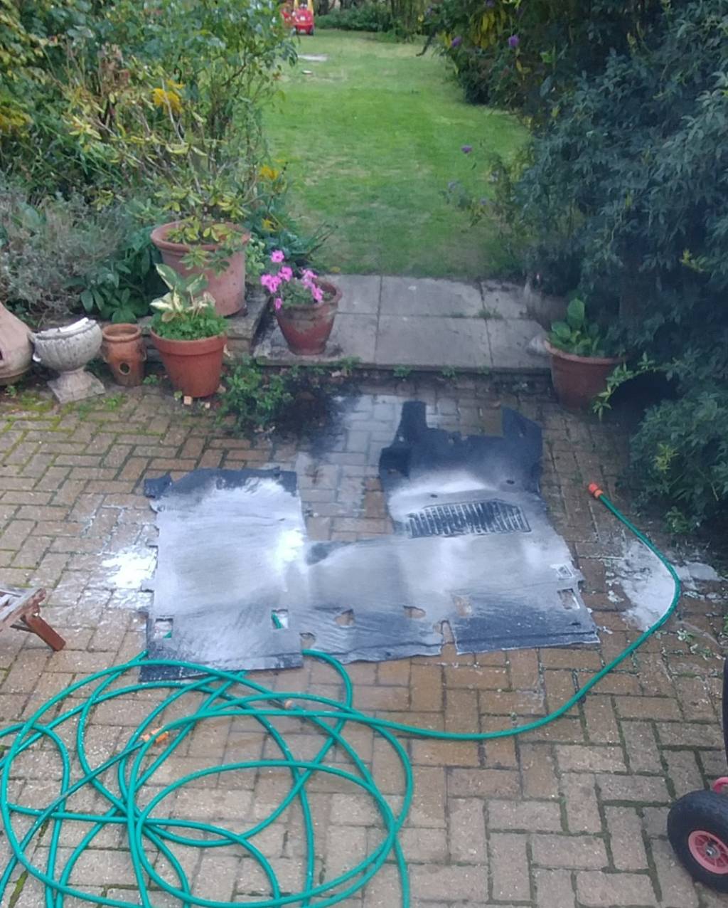

While i've unbolted the front seats it'll be a good opportunity to get the carpets out for a pressure wash.:)
Started on the front seats last night - well getting them out at least. Also unbolted the anchor points and passenger side sill plates. Everything is going to get a massive clean before going back together.
Not a lot of access for the centre seat bolts so i just plus-gassed them front underneath and will have a go another day. Don't need it out to replace the carpet but the seats needs stripping down and cleaning like the other 5.

You need to take off the side panels from the centre seat to get at the bolts... Allen key towards the rear and a philips up front... bolts are real accessible then.
Marty.

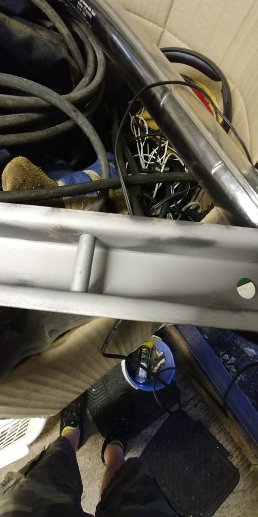

No its ok, I've been in this position before but others havent. Yes the side panels are also ducts to take heating/cooling to the rear - clever! They're held on with two phillips screws and a 13mm nut on a stupidly long thread which you need a skinny deep socket to reach. I used 1/2 inch. Then the seat itself is 6 16mm bolts. I used 5/8ths - i was in an imperial mood for some reason.

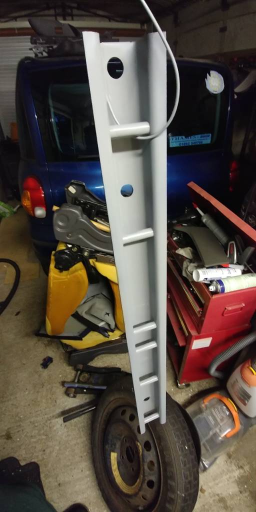

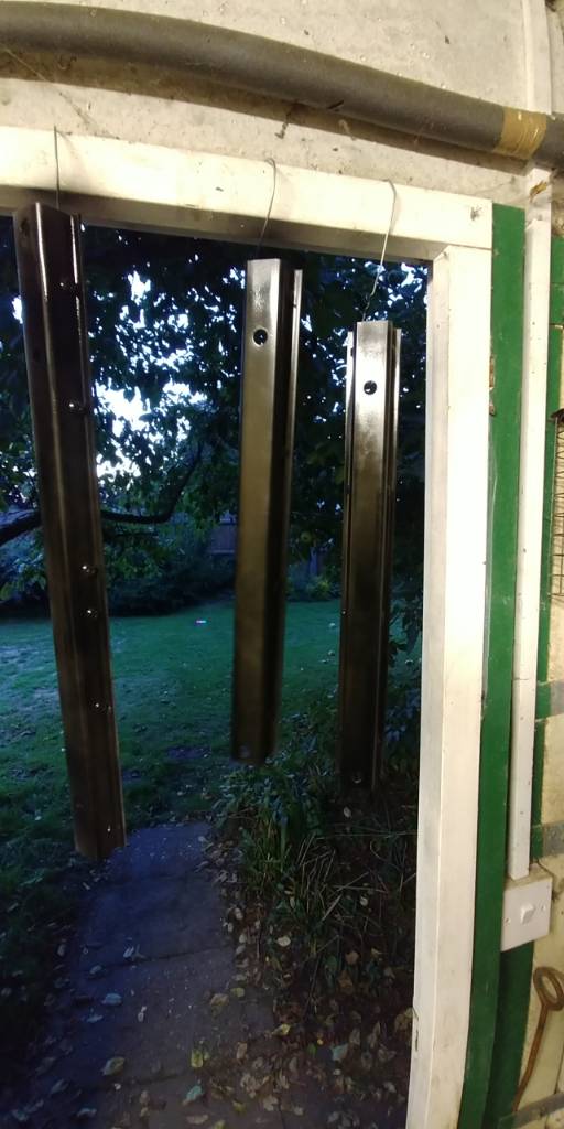

Guy at work shot blasted the floor brackets for me and i started to put paint back on. Typically ran out of satin black...20180910_192858.jpeg20180910_193711.jpeg20180910_193637.jpeg
