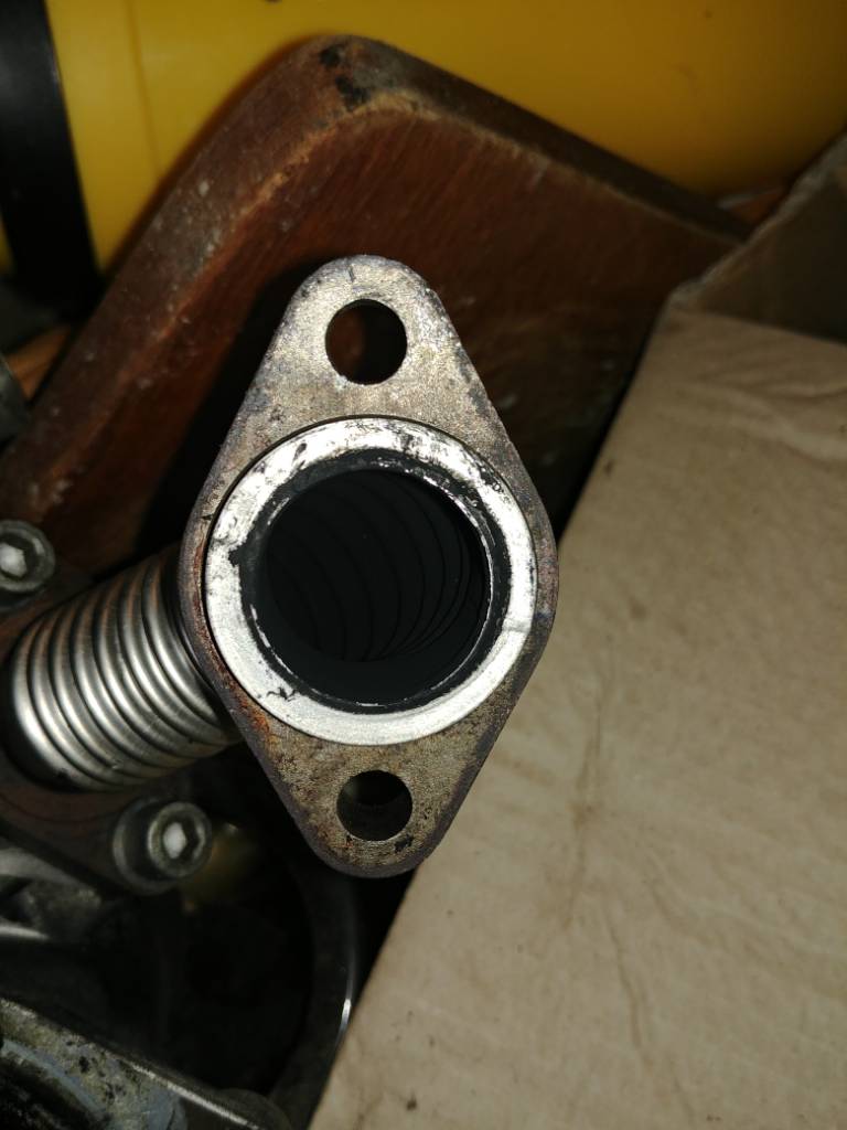

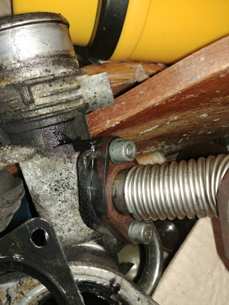

Been doing my thermostat the last few days. Spent about 4 hours in total. Didn't take many pics I'm afraid but the main pain in the arse was the EGR cooler bracket which is attached to the bottom thermostat bolt. The other bracket for the cooler is attached with two bolts on the rear of the head one accessible, one not. While the egr pipes were off I found a misplaced gasket. All looked very clean though. 20181229_181635.jpeg20181229_181645.jpeg

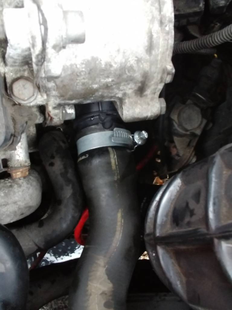

2 bars. 100% improvement but still crap. Heater is warmer but not really hot. Not sure if i can be arsed to change it all again or spend another £80 on a new thermostat so could either do the Renault 5 thermostat in the top hose thing or the winter muff.20181230_131302.jpeg
I got JBL speakers for the front off Ebay - think they were 6.5 inch diameter and some Alpine ones for rear - think the are 7 x 5 inch, I cut the middles out of the originals and used the remaining frame to mount and use as a water guard, i'm on France till 3rd but will confirm speaker sizes when I get home. You also have to crimp on new terminals making sure you get all the polarities the same, sounds crap otherwise. Renault 5 inline thermostat for me, having done an Alfa JTD i'm not going through all that again unless I have to.
There was an extra connector on the passenger front speaker, no idea what it does, I just left it disconnected and everything works, there are tweeters in the windscreen trims!!
Espace thermostat in my top hose has done the trick for almost two years now. It's a tight squeeze to get in and I even bought a new top hose just in case I damaged the old one.
I saw your post about the Renault thermostat and even saw a youtube video suggesting the same. Anyone else considering a fix for a jammed open thermostat should probably try that method instead.

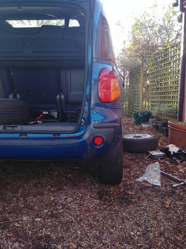

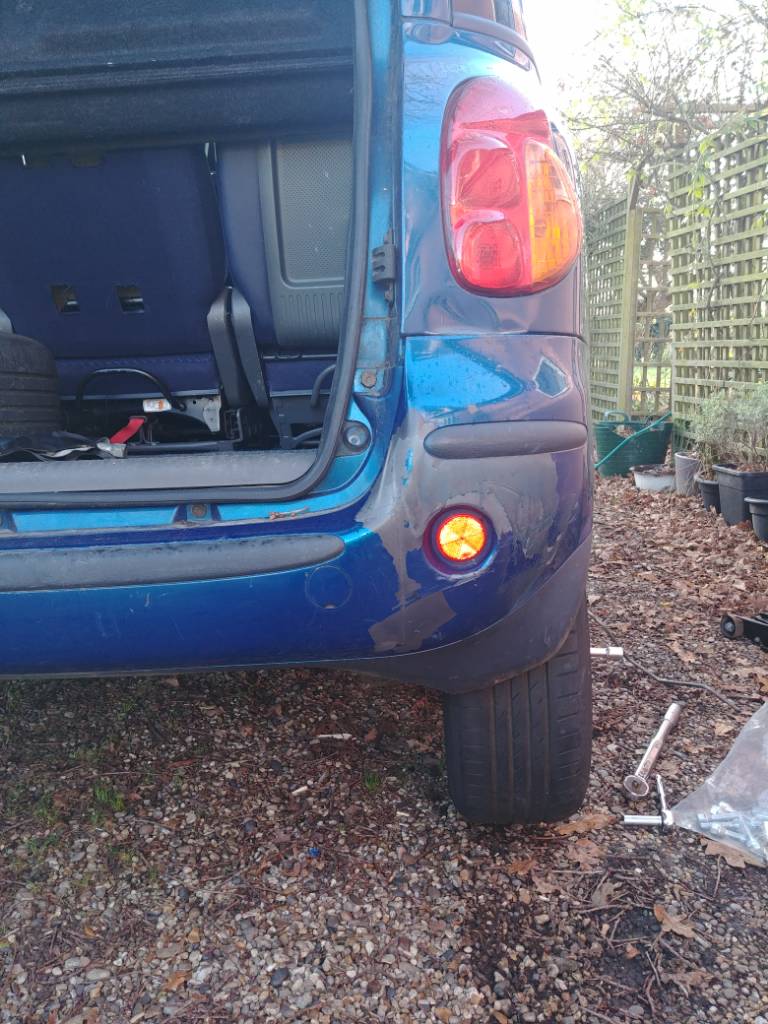

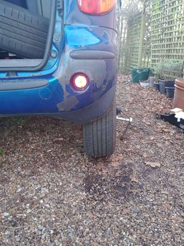

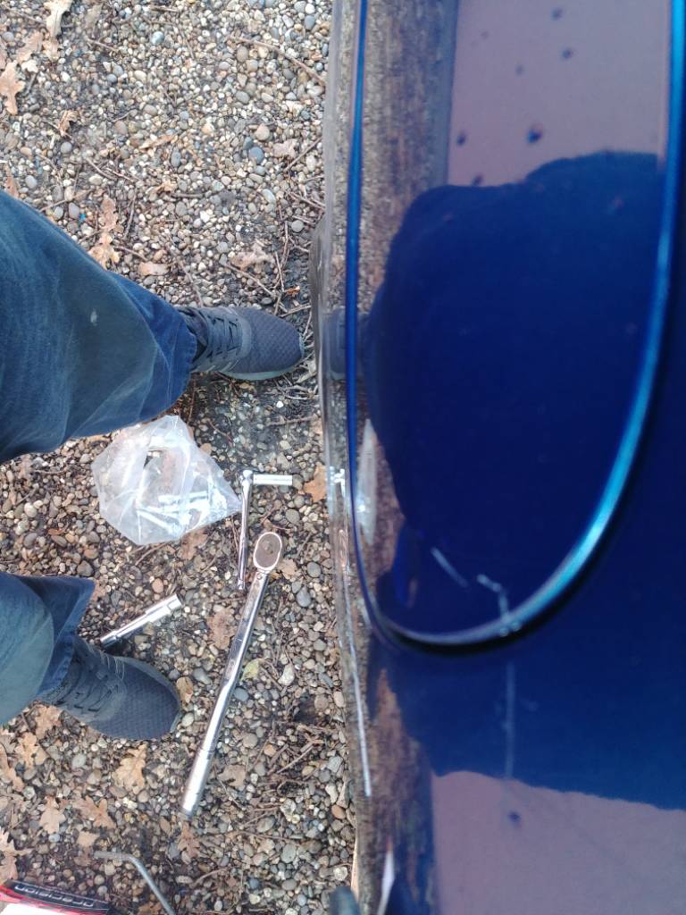

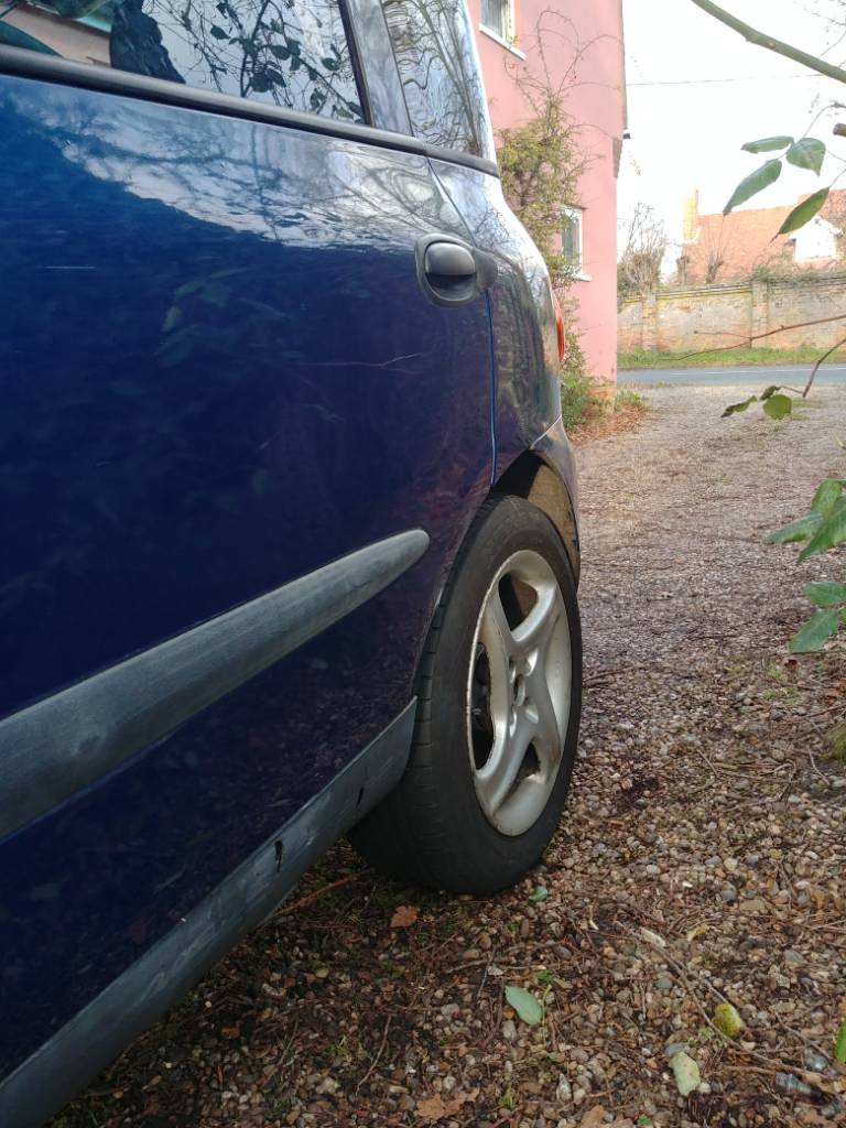

Stuck on the 16" coupe wheels, though only on the rear.
Pics:
Standard wheel
Coupe wheel
Coupe wheel with 20mm spacer
Coupe wheel with spacer at ride height.
[emoji41]
Just need to do a little bit of refurb on 2 other wheels and get some tyres then I can do the fronts too!20190102_095811.jpeg20190102_100248.jpeg20190102_100658.jpeg20190102_100945_HDR.jpeg

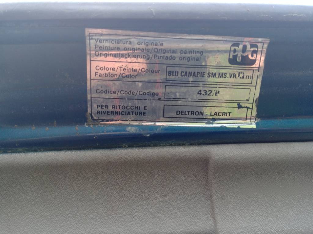

My paint code is on the boot lid to right of the lock.

Thanks for the colour code pointer. I'll go and have a look at lunch.20180710_082122_HDR.jpeg

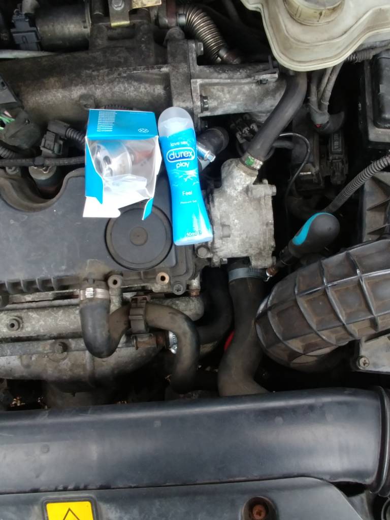

Me and the Multi have a date with this thermostat for a Renault Espace 2.0. Luckily I brought some lube.
Took about 20 minutes, 18 minutes of which was trying to push the sodding thing in the hose.

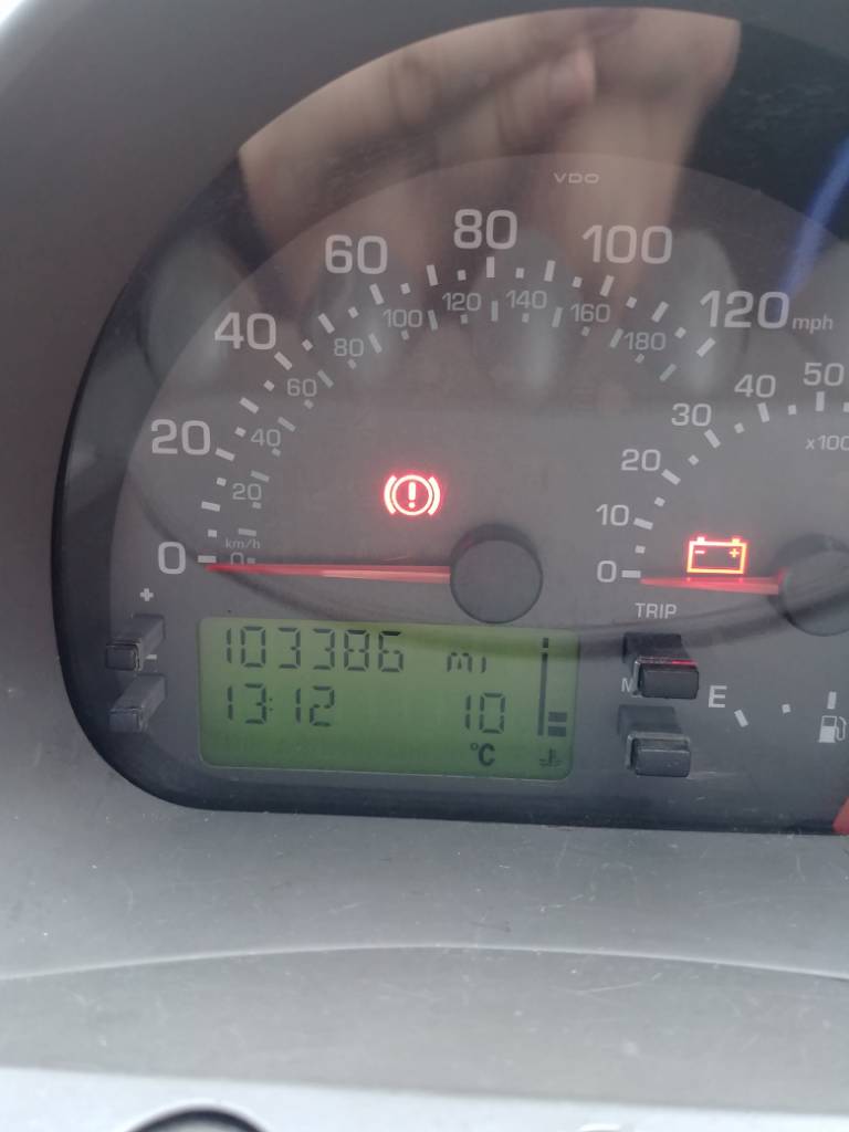

Took for a quick drive. 3/4 of a mile of enthusiatic driving up a hill got to 2 bars. Another mile or so got us 3 bars! Then on the way back the illusive 4 bars! Long cost down a hill and it didn't drop to 3. Heater like a toasty hair dryer now. Took it home, topped up fluids while idling and checking for leaks. Checked again and the gauge had dropped to 3 - fine by me. Past the new thermostat the hose was getting hot so I'm sure its opening.
What a great result for £7.
