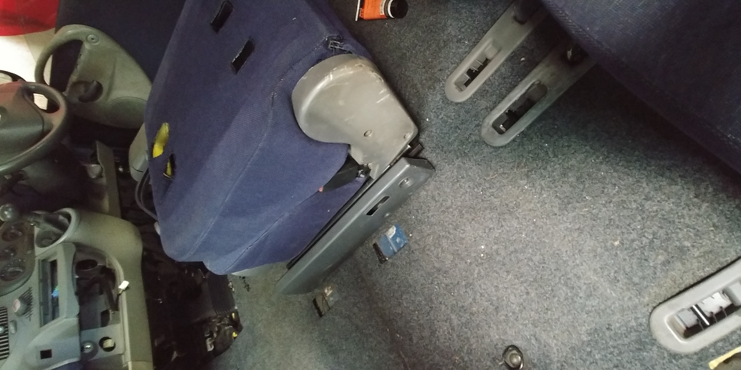

Started putting the seats back in and generally went ok. Airbag light came on though[emoji34]

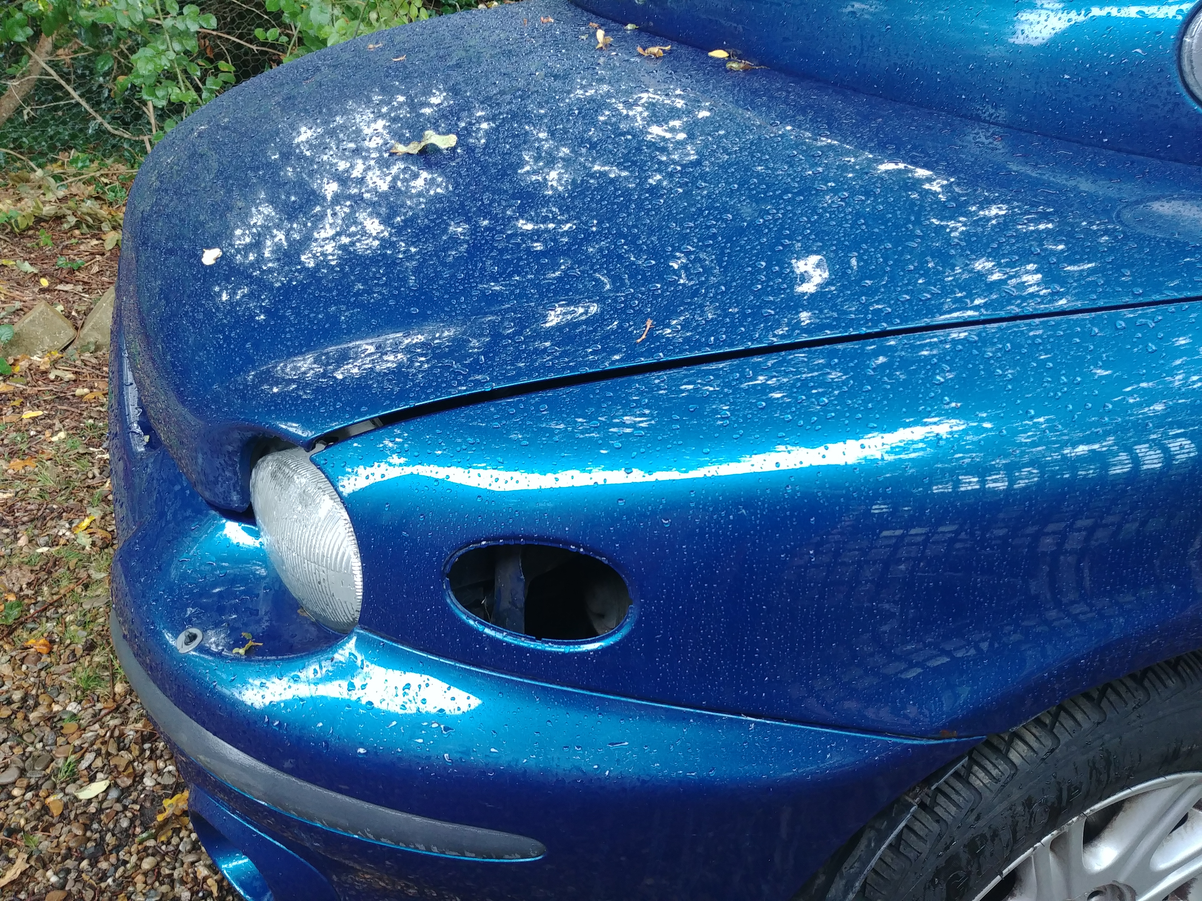

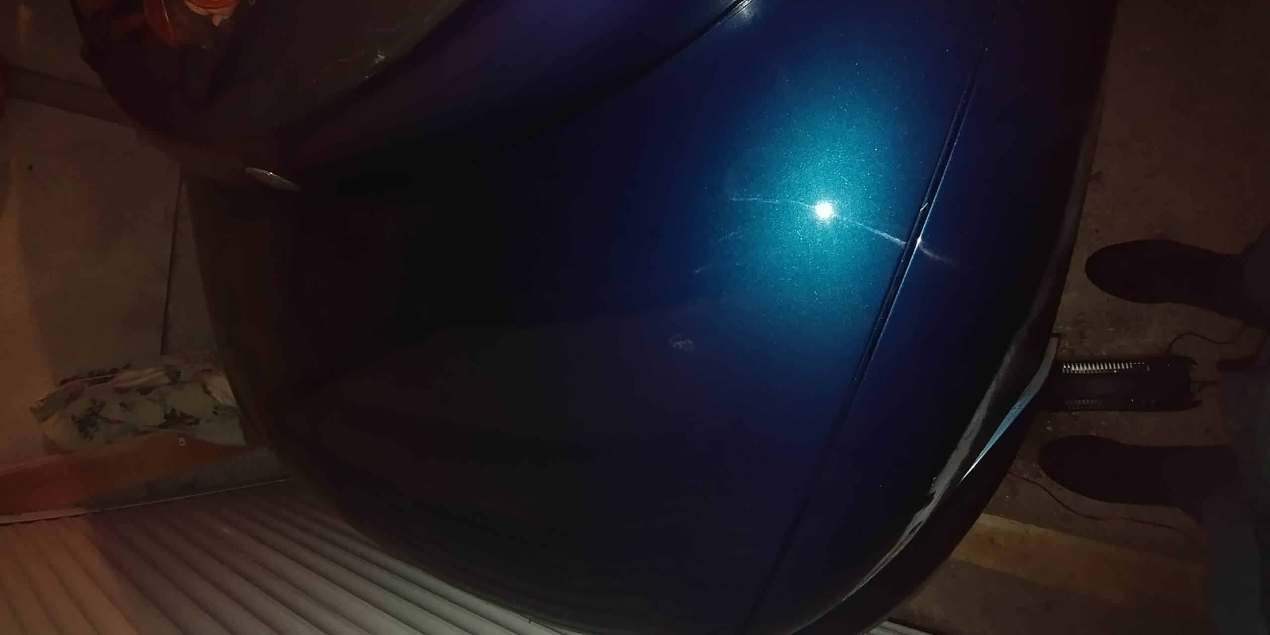

Started to do a bit of clay bar/ polish / wax. Pleased with the contrast but really she's too dented to ever look great.

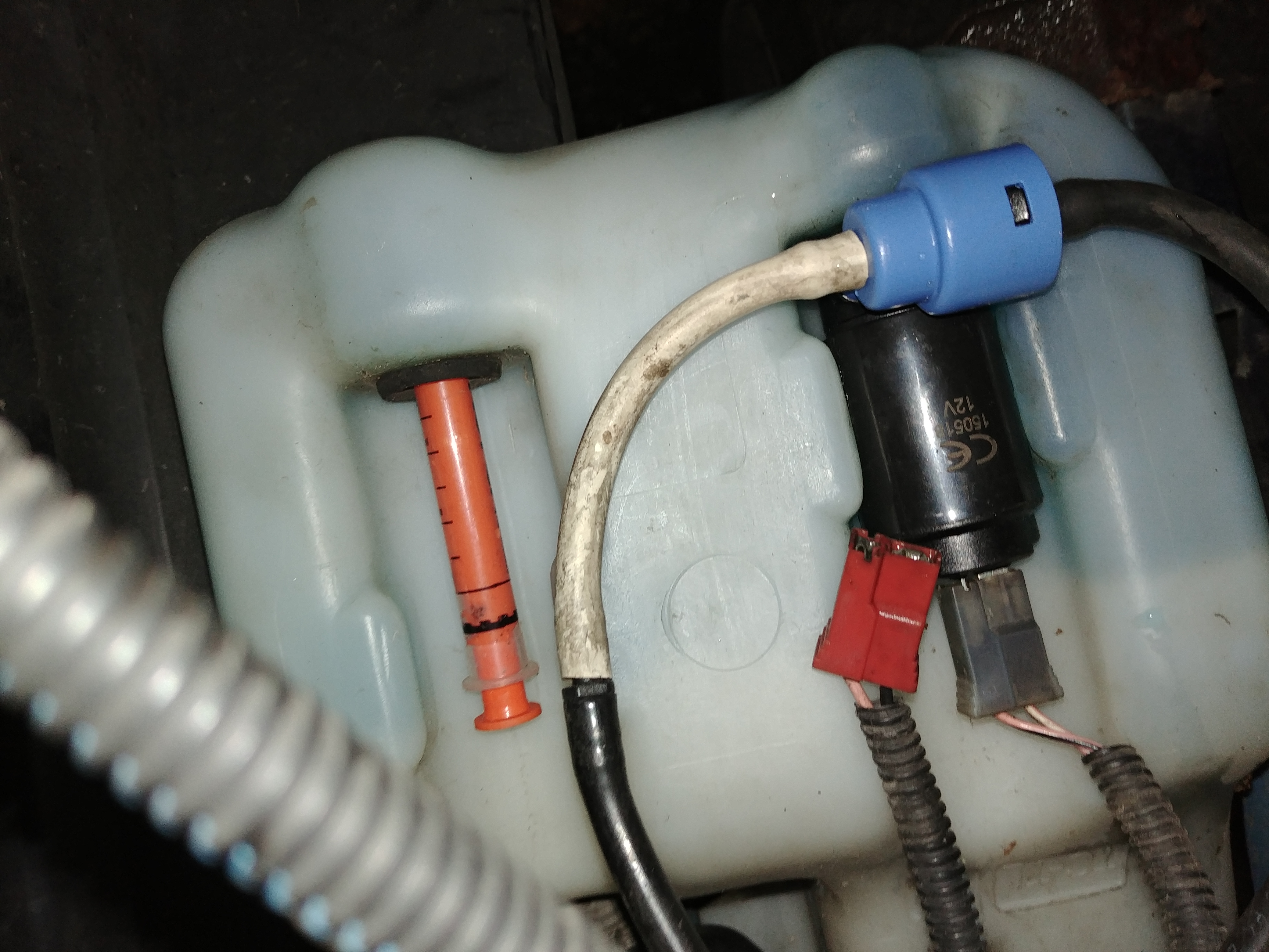

Finished putting the front wing & bumper in then found the windscreen washers didn't work. Oh well off the bumper goes again! Bought a replacement washer pump and found that the second pump had been blocked off with a calpol syringe! Perhaps I'll pit a second pump in there one day - it's only for the headlights.

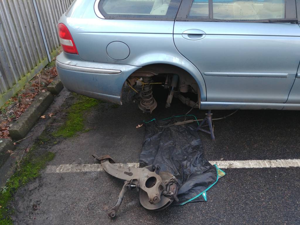

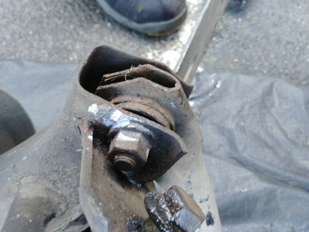

Finally I managed to immobilise the Jaguar by shearing a bolt on the suspension. Threw the Multi in for an emergency MOT to give me a back up and it only bleeding passed: no advisories! Insurance being swapped over on the weekend. Far more excited than I should be!

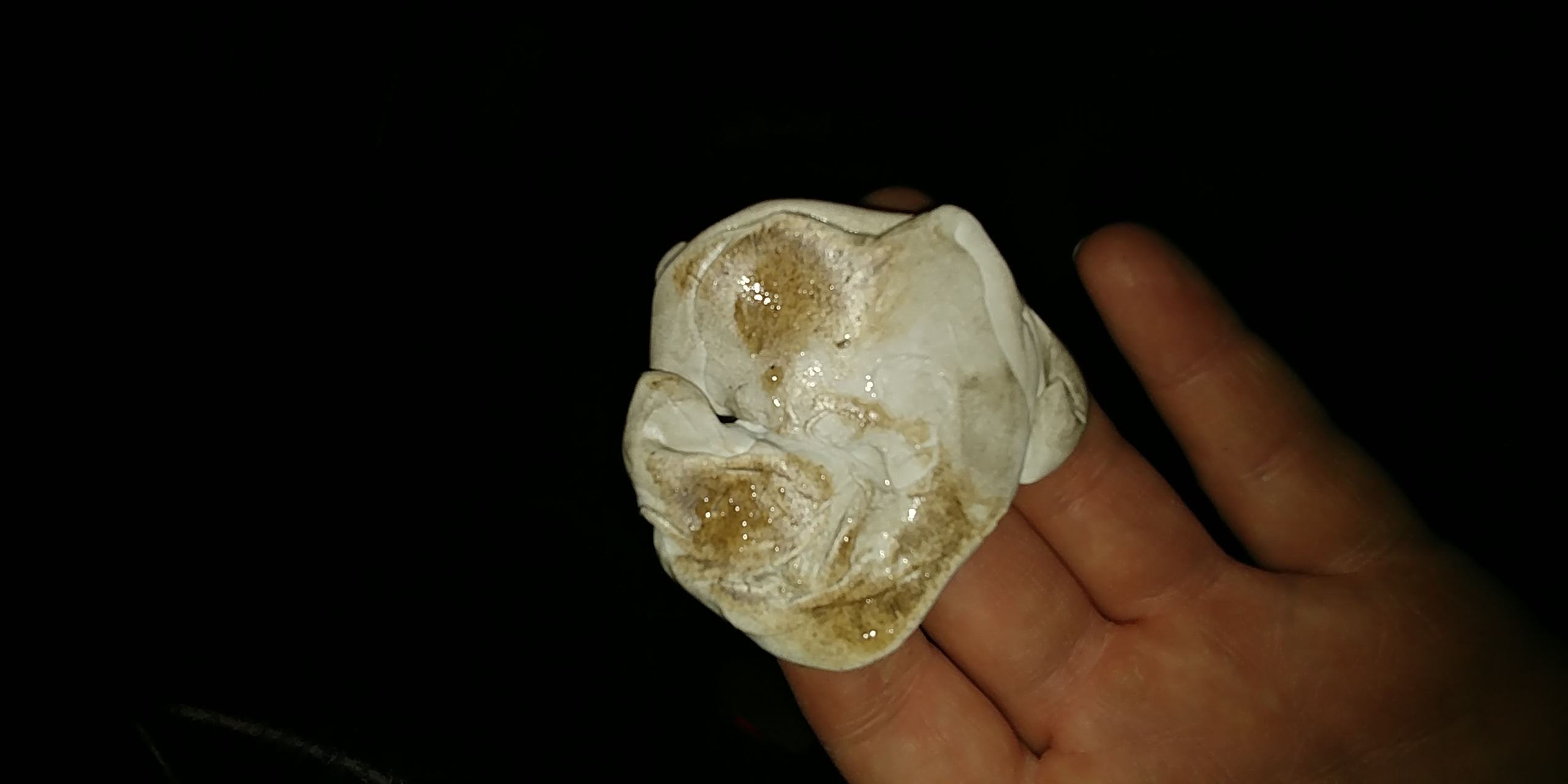

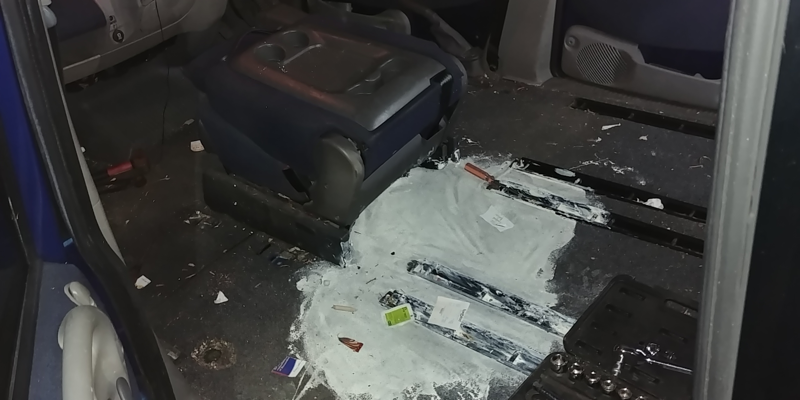

From the top - snow man massacre, replacement carpet in (middle seat did come out also), had a go at some clay bar action - this is the brown stuff from the boot lid - must be burning oil!, bonnet after a polish, now water repelent!

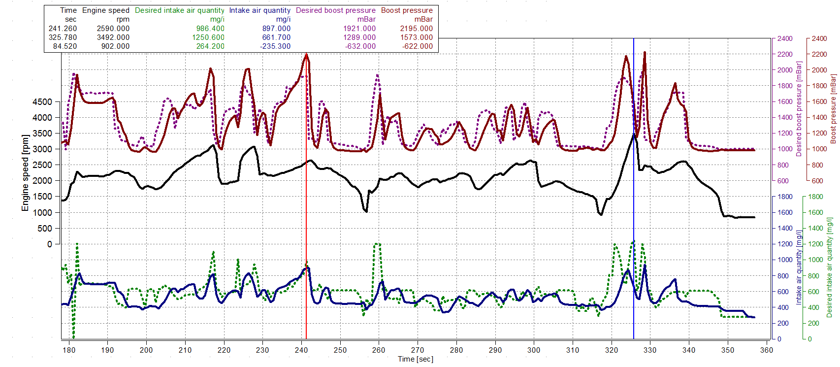

Cold running:

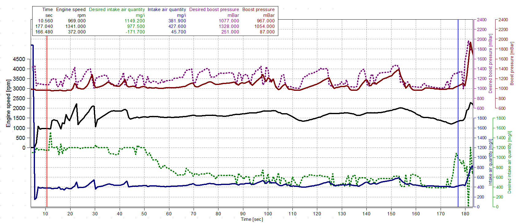

Right finally some data!
Two images below are 5 channels I recorded this morning. 0-180S shows the MAF sensor reading pretty much bugger all (Navy trace), the set point is way high (green dashed) so perhaps it’s requesting 0% EGR just after start to aid combustion stability. As mine is reading low, perhaps the EGR is stuck open. It’s also pretty reluctant to make boost (red compared to purple dashed). EGR stuck open would give this symptom too.
After 180S the MAF trace is much better. It’s not perfect but I haven’t got anything to compare it with. I think it would get closer to the peak air flow (1200mg/str) if I kept it at full pedal for longer (remember my clutch slips). Note also the boost is meeting the set point much better (it does overboost but again because I have to lift off because of clutch slip I haven’t given it a chance to control).
So why is it better after 180S? I don’t know yet. Maybe it’s 3 mins after engine start? I doubt it. Note the engine speed goes over 2300rpm for the first time at 183s. I think that maybe EGR shuts off above 2300rpm or possibly a certain torque set point and this had properly shut the EGR valve and opened the VNT. After this point either has stopped sticking and it’s responding better.
Unfortunately my laptop battery is also getting tired and will only last 5 minutes unplugged so this is all I could capture. Any suggestions or comments welcome though!
Checked the error codes obviously and got one about the pedal and accelerator being pressed simultaneously. No idea! Cleared it and didn’t come back. Also managed to check engine temp after 360s and it was up to 60 deg C so I feel less bad about driving it now.

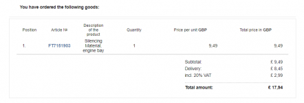

Wheel arch liner: Is this any good?:
https://www.ebay.co.uk/itm/Blic-Eng...h=item2ccf625d13:g:ybQAAOSwsZJaYDfU:rk:7:pf:0
That one's for a roundnose. Worth also checking that the seller will actaully ship larger items to the UK. I've been let down on that front before (but not this actual seller.).
Or this one, but again check with Autodoc that they'll deliver an item of this size to the UK. I've had orders cancelled by them before, because of that (they won't ship the engine undertray, for example):
https://www.autodoc.co.uk/prasco/7456440
That's a bit of a bargain though! UK delivery is about £8 I think.

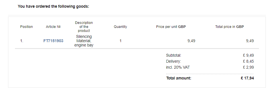

Awesome thank you! £18 delivered!:p Hope it fits.

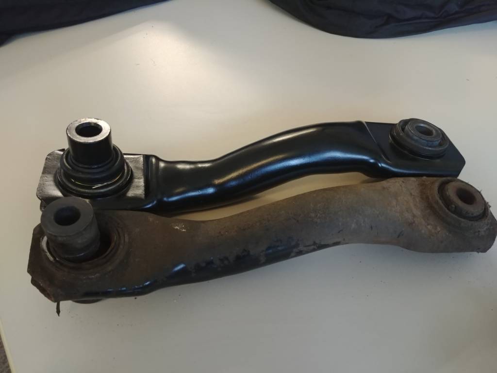

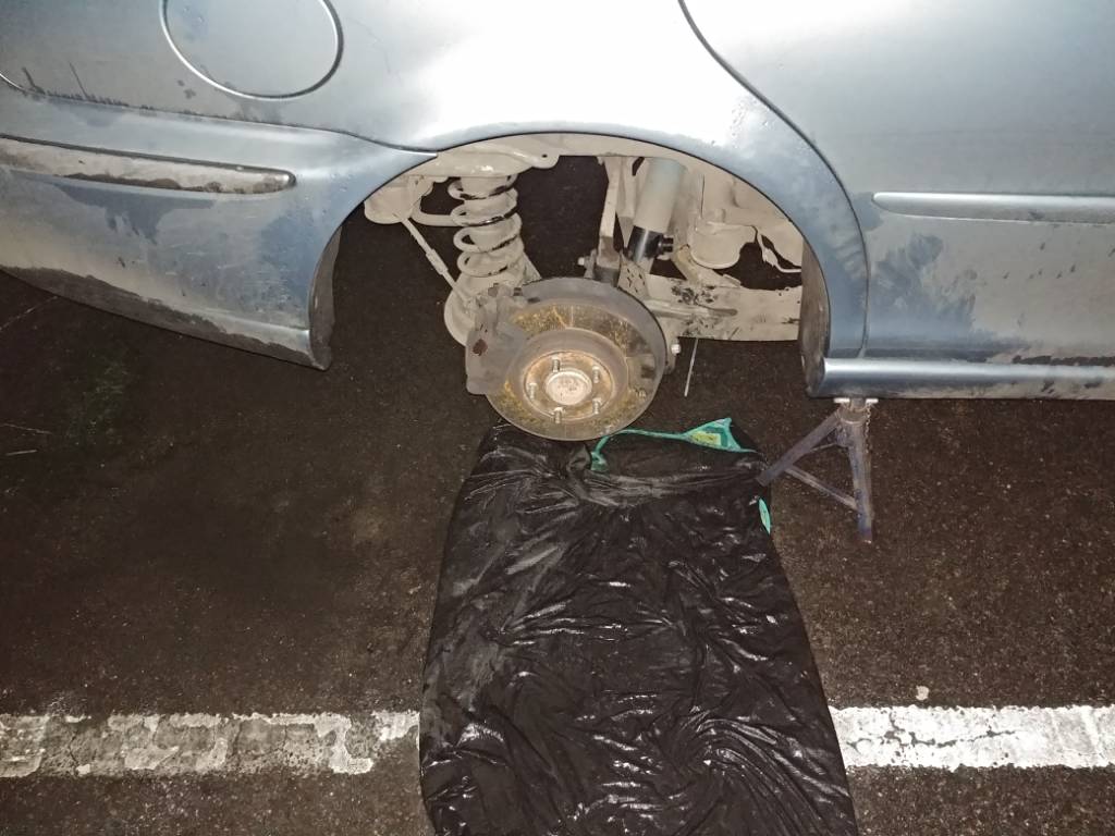

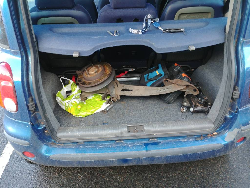

Sort of. The rear front lower control arms are worn to buggery and cause big negative camber and toe out. Burned through 6mm of tread on the inside of the rear tyres in 4 weeks. Went to replace them in my lunch hour and a bolt sheared off inside nut welded to the knuckle. I ended up having to take the whole knuckle and trailing arm off (pictured in back of bug) to take home so i could grind off the welds of the nut then bash out the remains of the bolt. Has been a hell of a saga to be honest. Spend an hr kneeling in a puddle this morning trying to put it back togther. Another half hr and I'll have it back on it's wheels for the first time in 3 weeks. Just got the other side to do then!20181220_124809.jpeg20181220_124749.jpeg20181221_071258.jpeg

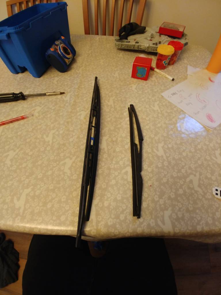

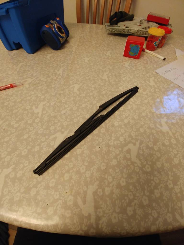

Quick bit of upcycling on the Multi, take one used but ok front wiper and one shagged rear one. Cut down and make good rear one. When I replaced the washer pump I must have put the wires the wrong way round. If you push the stalk forward you get front washers, rear wiper. Pull it back and you get rear washers but no front wipers (i don't think the front wipers come on automatically). Anyway I'll swap it back when I do the arch liner.20181222_154138.jpeg20181222_155121.jpeg
