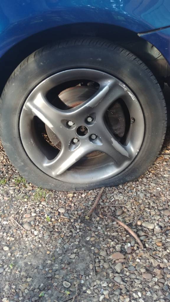

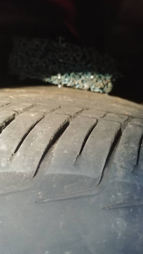

I should really learn to clean up after myself.
That's my rust removing drill attachment stuck into the tyre. :(
Luckily the tyres only flat at the bottom.

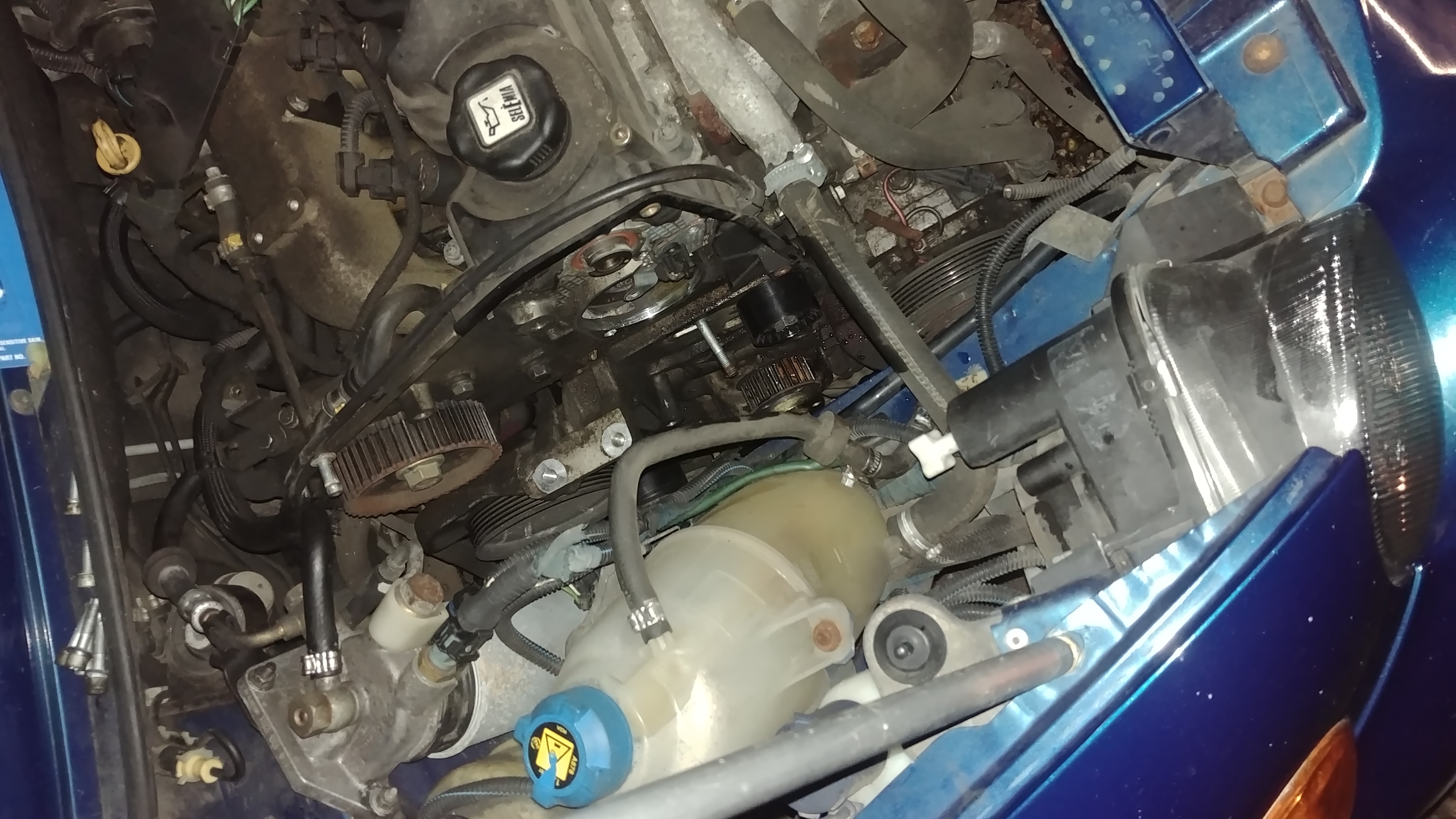

Also Alfa is busy doing Alfa things:

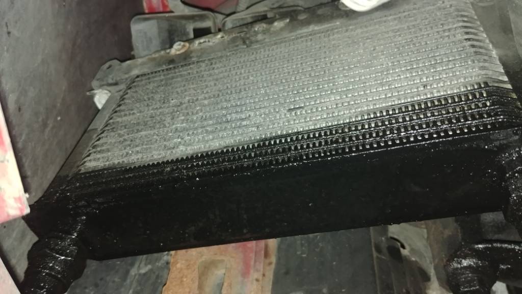

That's the oil cooler. Having a ponder what to do here...
It's got an oil cooler?! Where does that live?
Is it dropping new oil, or look like the leak's been there for a while?

It's got what we call at work a modene. It sandwiches between the oil filter and engine and diverts oil off to this cooler which is infront of the drivers side front wheel. No idea why a 147 needs it and a Multipla doesn't, sump capacity may be?
It looks to be fresh oil (well its jet black like every other dizzle burner) but I'm monitoring the oil level and i think its a weep not a gush.

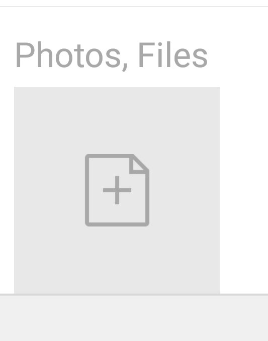

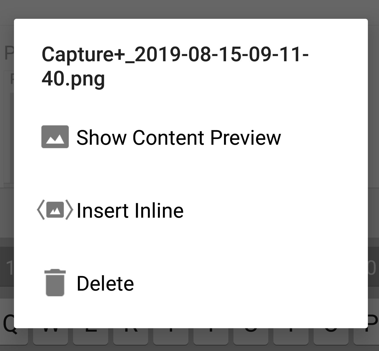

On mobile version I type some text and then tap the + button to add photos add files.
Then tap in the text where you want the pic to be and tap the uploaded image.
Tap insert line option and then carry on typing. Or type it all first and then upload all your pics and then insert them in the right places. If you dont insert into the text it just dumps them all at the end of the post in the upload order.

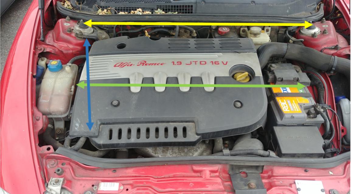

Right here is the Alfa:
1000mm between strut tops (Yellow)
900mm width of engine bay (Green)
560mm from the strut top face to the driveshaft centre (wheels on ground) (Blue)
Same dimensions on the Multipla (approx):
1150mm
930mm
550mm
Respectively.
So, will it fit in the hole? Yes.
Given the generous width perhaps the 2.4jtd is worth considering! [emoji41]
No seriously though i'm not going to do this swap. This particular Alfa may make a good donor because it's an ex CAT D, rough and rusty around all the edges and it needs a new clutch so the box has to come out anyway. I think the Polish legends were alluding to the point that the 147 must have a BCM. To do this swap *easily, you must have to basically re-shell the alfa with the Multipla anything else would require some Jedi level of Auto electrickery. Perhaps thats why they use the 156?
The 6spd box is worth a look though if its as easy as mix and matching the driveshafts. The engine might struggle to pull 6th without a remap though. 140ps should be possible and is plenty in the Alfa. 140ps in the Multipla would be hillarious!
The 2.4JTD is way too heavy (hell, the 1.9 is quite bad enough as it is). I reckon the 150bhp 16v is the way to go. I've been encouraged by finding out that the front track for the Multipla and the 147 are only a couple of mm different :) so I'm surprised that there's such a difference in the strut top centres.
I thought the Polish guy said that the ECU isn't tied up with the BCM, which makes things a lot simpler? Or was that the 156 as you mentioned, so use a 156 ECU for the 147 mechanicals!? Need to dig back through the threads.
I wonder if it would be simplest to take the whole 147 subframe, engine, 'box, wishbones, uprights etc (with the possible exception of the steering rack), graft the 147 turret tops into the Multipla and the box section that's on the back of the 'pla subframe onto the 147 one? Are you certain those dims between strut top centres are correct?

WMF, yep those dimesions are correct but approximate. The Alfas strut tops are completely different and look to be pointing inwards slightly. The Multiplas are much wider apart. Perhaps I can take some more photos with a stick for scale or something - I'll have a think.
No - that's fine! I just wanted to check that there wasn't a typo.
It may have something to do with the eccentric mounting of the springs that the Multipla employs.
The 147 has funny strut tops to accommodate a casting that sits on top of the struts that provides the mount for the top wishbone.

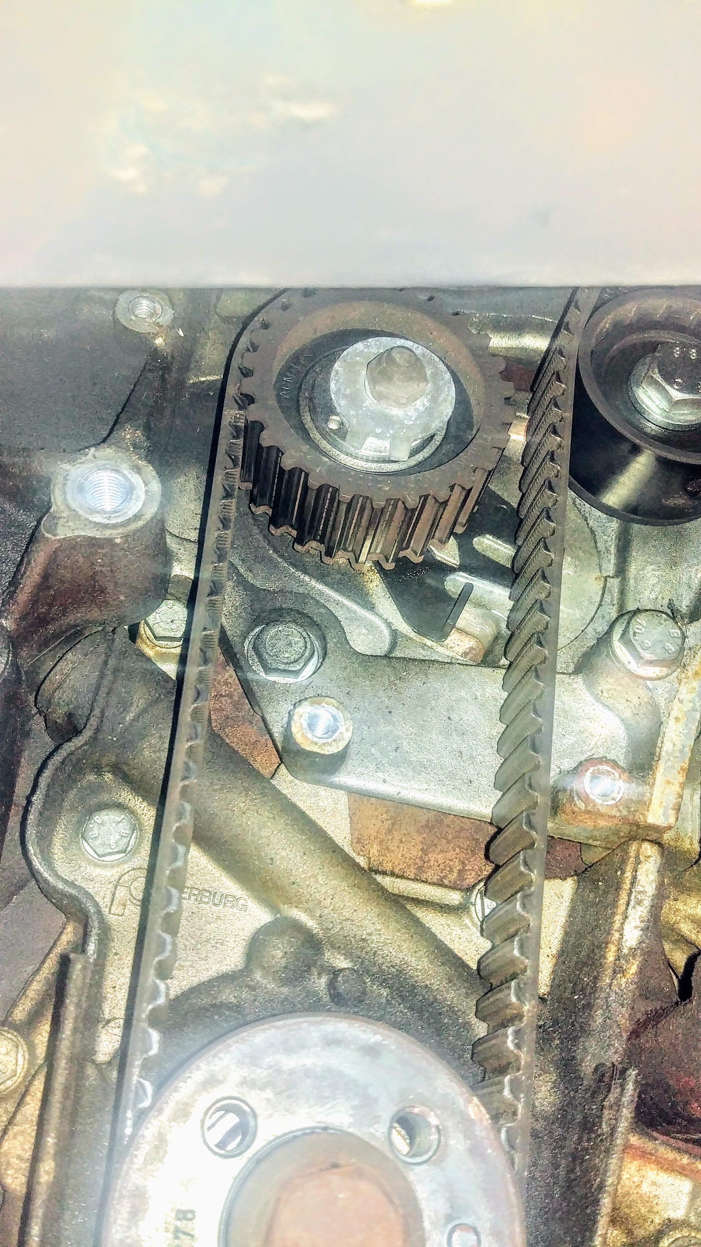

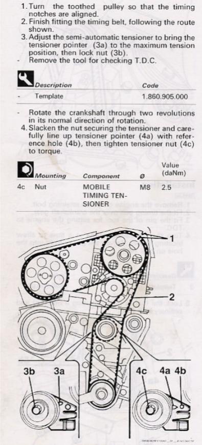

Summat that didn't make sense last night was the auto tensioner position. The correct procedure is to tension it to the max, 2 revs then set to a hole on the top of the tensioner bracket.
Photo below shows how I found mine. Looks to be on the lowest tension setting!
like my jeans during most of the job, the belt is showing lots of cracks too.

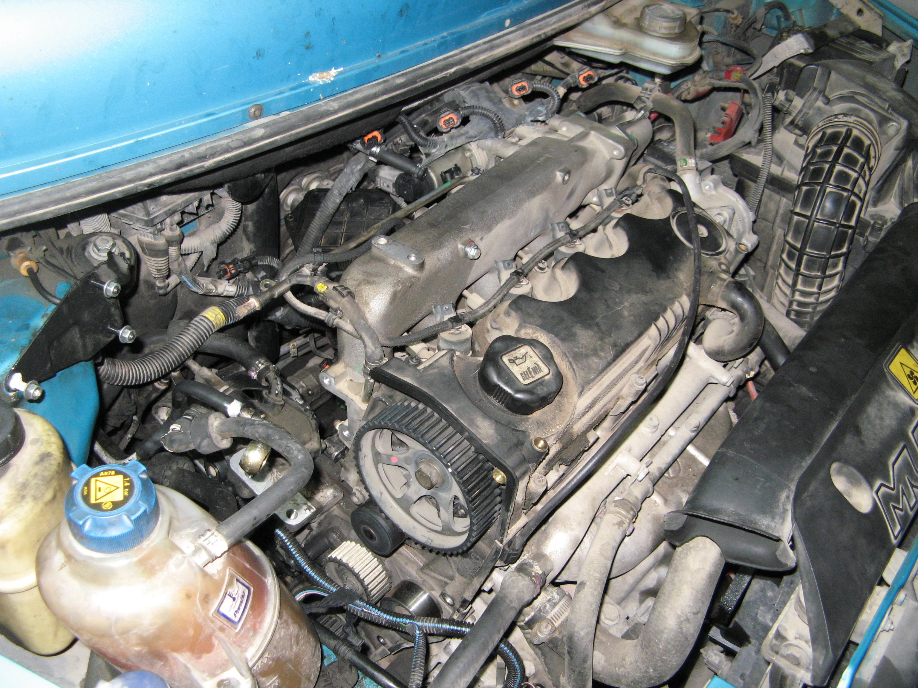

Little more progress last night. Ended up getting a T55 Torx bit and the offending top mount bolt was removed easy enough. There is no visible mark on the casing for the crank to be timed to, but the tool I bought does seem to lock it so that the cam is correctly timed. I pulled off the tensioner/idler/belt/camshaft pulley/camshaft sensor and finally the water pump after draining the coolant.
Should start putting it all back together tonight.
Looks as though the tensioner pulley pinch bolt had slackened itself off. Or wasn't tightened to torque in the first place.

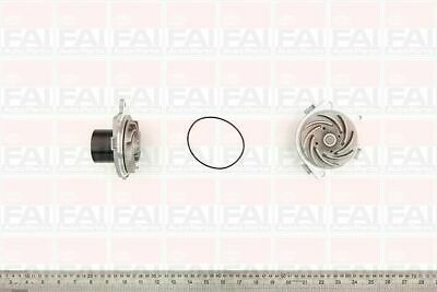

Has your new water pump got a plastic or a brass impeller?
Neither, it's metal but grey and cast - assume aluminium, it's made by FAI.
The one I took off is the Fiat original and plastic. To be honest it looked good but the O ring will never go back in the slot as it's expanded.
The rest of the timing kit is supposedly genuine FIAT service parts though the manufacturers are different to the ones I took off.
