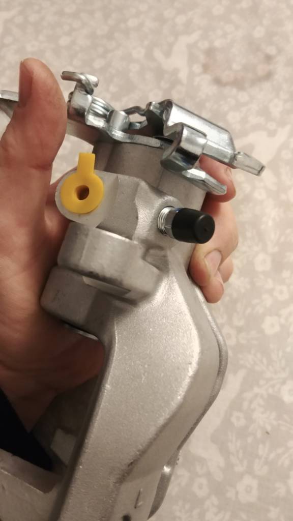

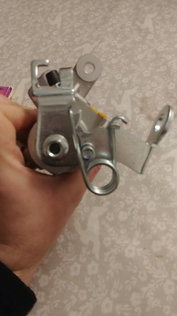

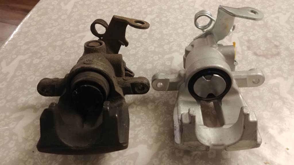

Decided to remove the passenger side caliper again and re-lube everything but it's still sticking. I've gone and ordered a cheap caliper off ebay and when that's fitted i'll strip down the old one and try to figure out what's wrong.
https://www.ebay.co.uk/itm/163694452076
£39 delivered.
Should have a go at fitting it tonight.
Well, I bled through quite a lot to try to ensure all the air was out but it was still a little spongey this morning. So much so that I had a small panic and thought that the reservoir level must have dropped below min but a quick check and top up said it was ok.
Main issue is that with it binding before, it's burnt through an entire set of pads on the nearside. Given the situation I had to cobble it back together with the best of the old. It's working (and importantly also releasing) but I think i'm going to have to get another set of pads for the rear and this caliper will have to come off for a 4th time! Also the bill for the rear brakes is over £100 now - blimey! Once I have the same thickness pads on both sides i'll adjust the handbrake but i'm pleased to say it does hold the car now.
