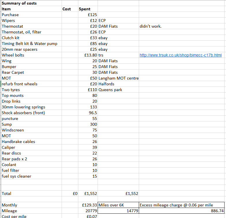

So as promised, how much have I spent in 12 months on the road:
I've covered 21K miles in that time. We've had 1 new Ford before and the excess mileage was 6p per mile, so at that rate it would have cost £887 just in mileage excess.

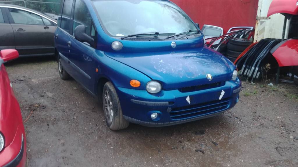

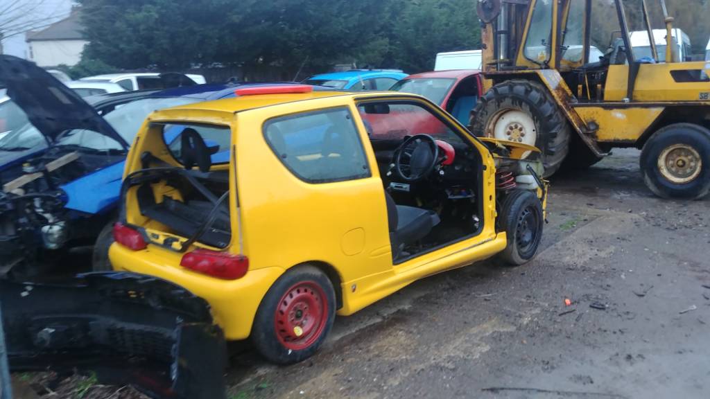

I've had a close look today - I think it's really only the bumper bar causing all of the grief. The bumper isn't even cracked. The slam panel will probably go back to shape with a bit of manhandling. My first thought was aquamarine too but I think he's in North East? I'm on Essex/suffolk border so not at all handy. I'll try to give DAM Fiats a shout today and visit the graveyard:
What a photo! One of yours? I'd love to make a trip to DAM Fiats but it's a long trek from here.
That photo is proof positive of just how little was changed under the skin by the squarenose facelift.

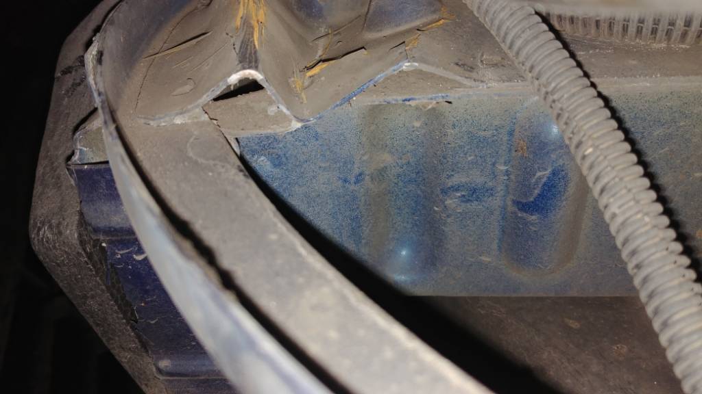

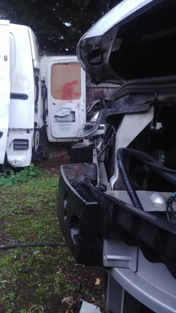

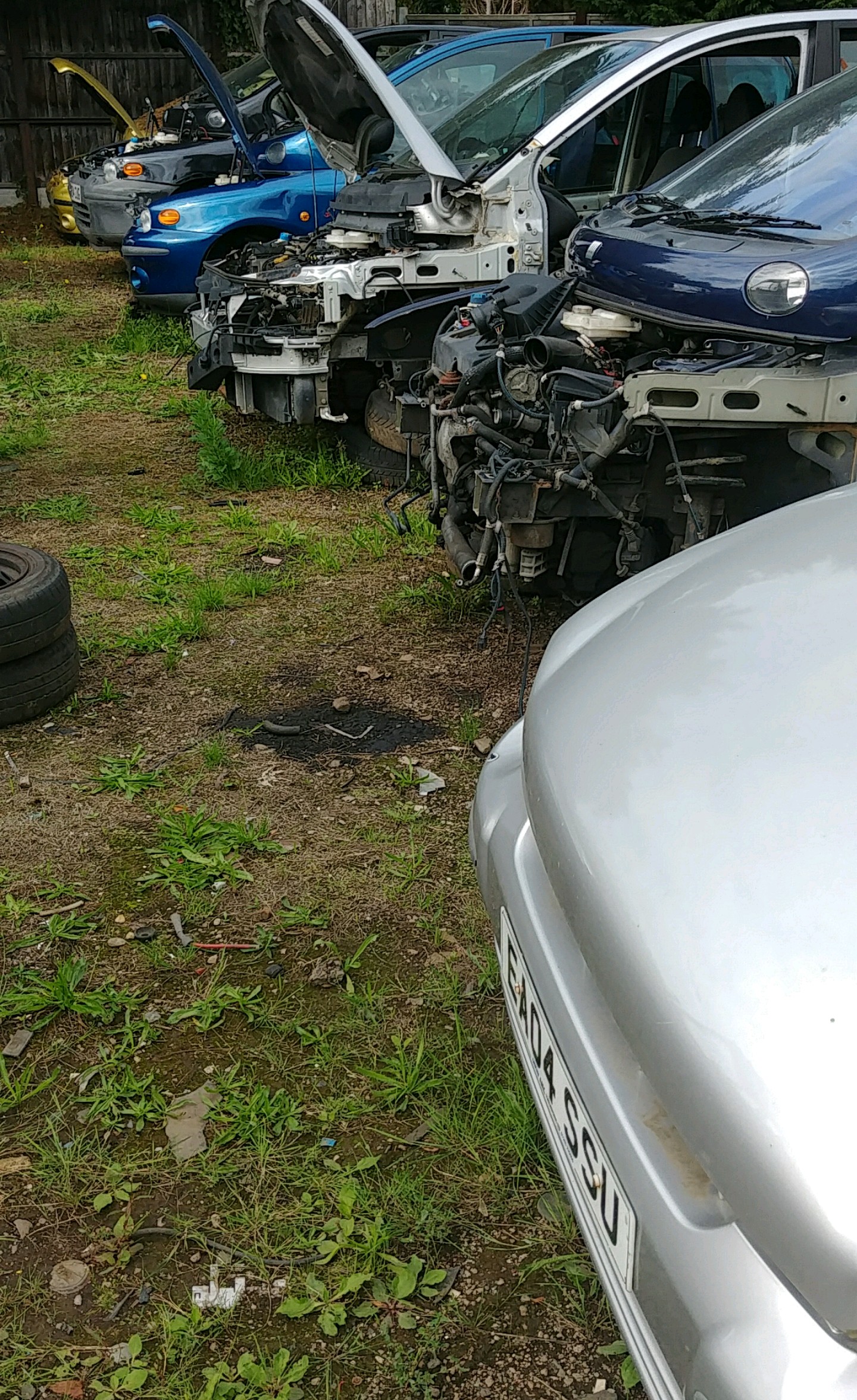

The graveyard pictured in post #214 is no more but there were two bugs left. Took some photos of the square nose.
Think the bumps and dips on the chassis legs are the crumple zones. Jon says he usually drills out the spot welds from the legs onto the front cross member and then ideally welds in the donor cross member. He said nuts & bolts would probably suffice. Going to try and get round to getting the bumper off on the weekend and see the extent of the damage on my bug. Oh and this was the roundnose.

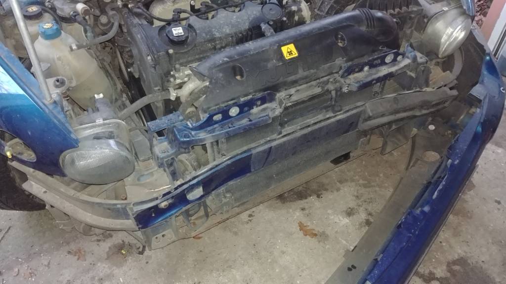

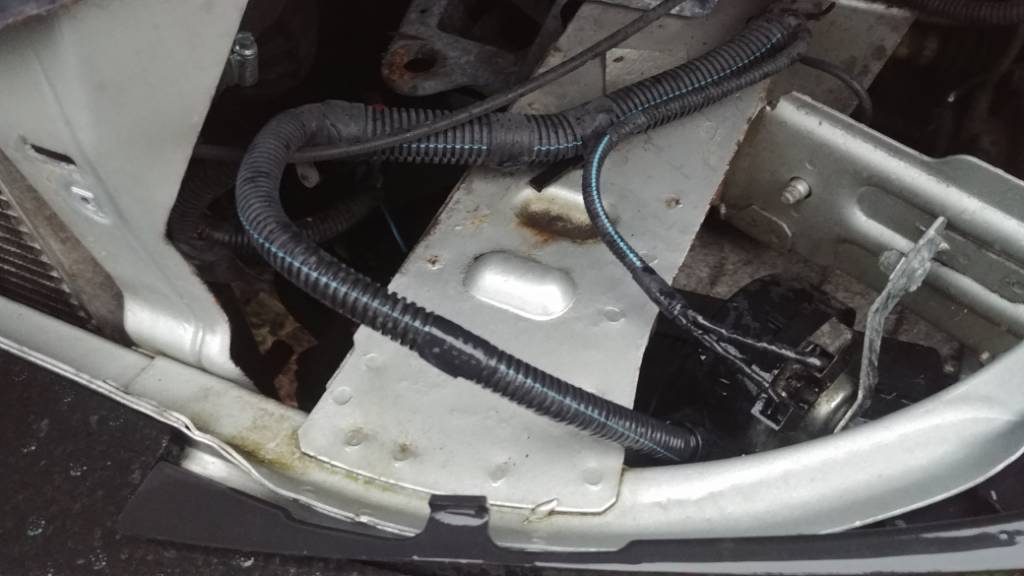

Quick update on this.

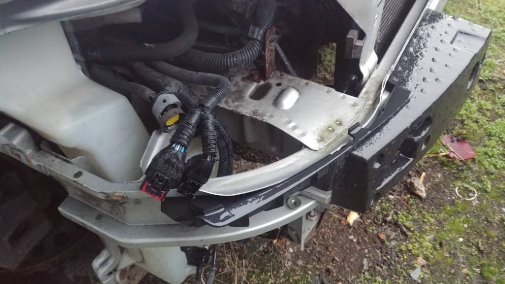

Dropped the frony bumper to assess the damage.
The centre section of the front cross member is properly bent in and squeezing the radiator pack.
The areas around the chassis legs don't look pretty either;
However I'm still wondering what the best course of action is. I can get a cross member off DAM fiats but there's a lot of work in swapping it over. Considering cutting out the centre section and making a simple bolt in bar to go between the chassis legs.
I think I'll try cutting out the middle first and see if that makes the front end all floppy or if it still retains it's racing rigidity.
