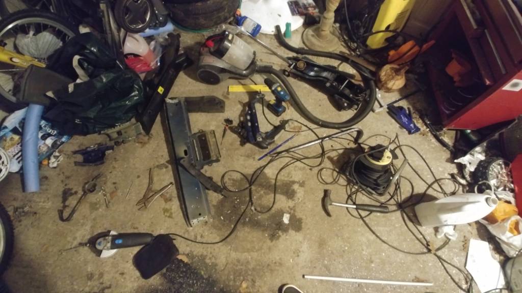

I had a couple of hours this weekend so I dropped the front bumper again. Started with a hacksaw, then angle grinder, but ended up drilling out the spot welds and removed the entire centre section of the cross member. The bumper sits nicer and the rad is no longer squeezed against the turbo. Infact I had to pull the fan out entirely.
I'm going to pause any more fiddling for a bit as the virbration at idle has gone and the top hose is no longer kinked so cooling shouldn't be an issue. As you say though i'll drill out some more spot welds on the chassis legs and bash the rest into shape.

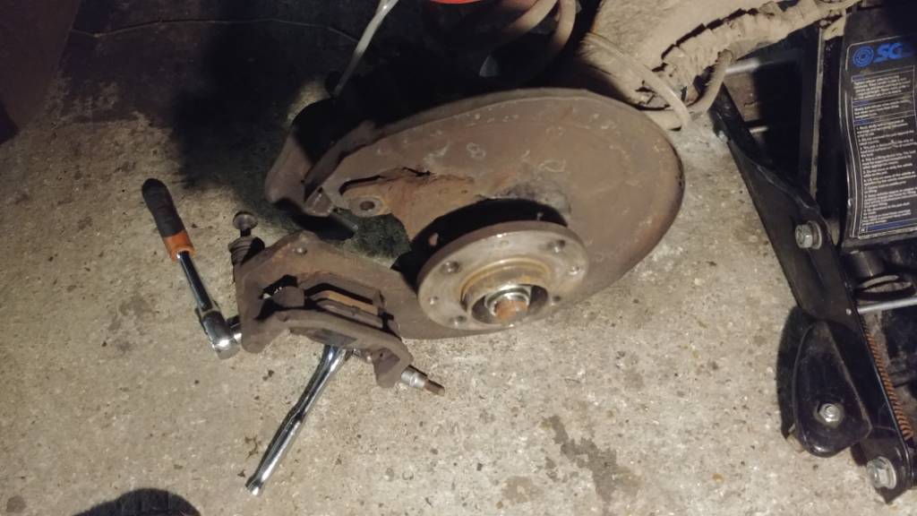

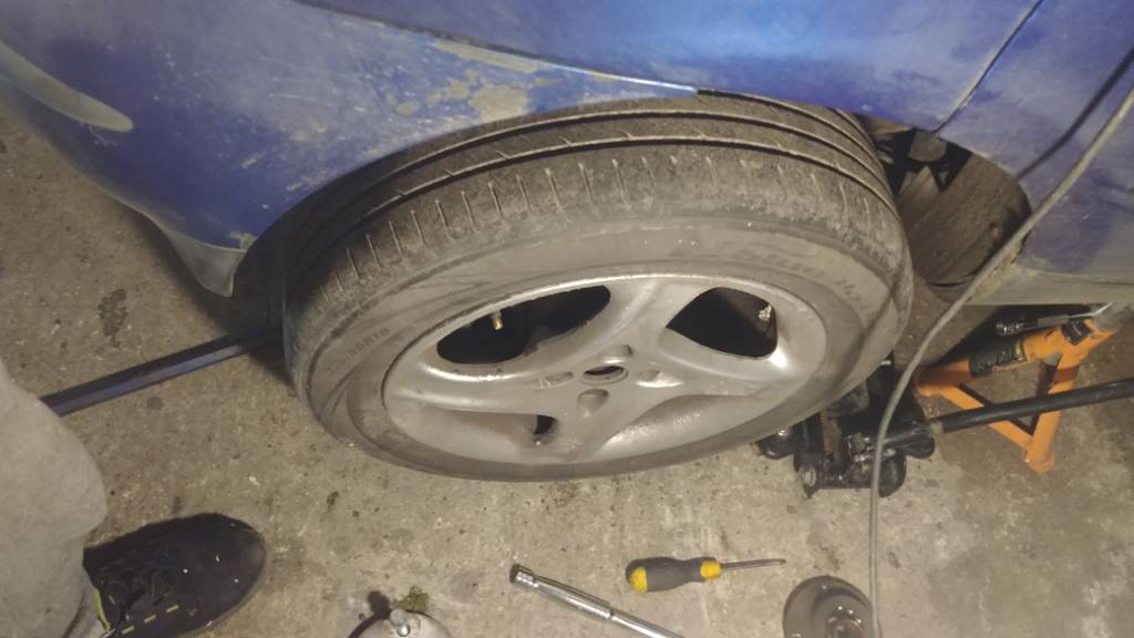

Wheel off, caliper off, loosen caliper carrier bolts, remove one bolt and swing the caliper carrier to the side to remove the rear disc. knock off dust cap with a screwdriver and hammer.

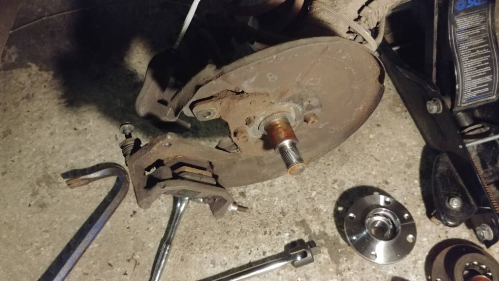

Remove nut with a breaker bar. Remove flange/hub by hooking a crow bar behind the flange and wacking it from behind.

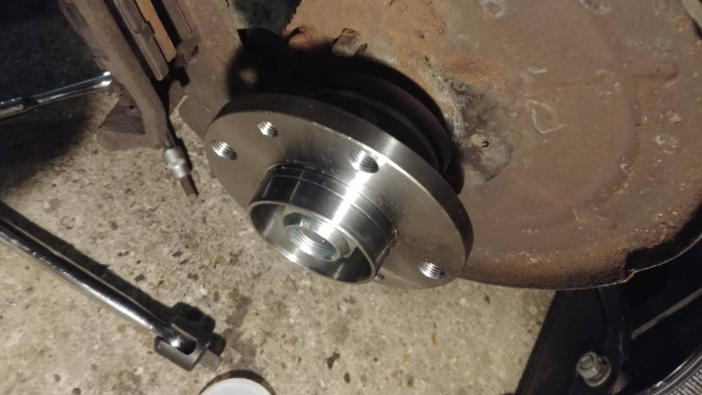

Cleaned off the shaft, added a little grease and tried to slide the new one on.

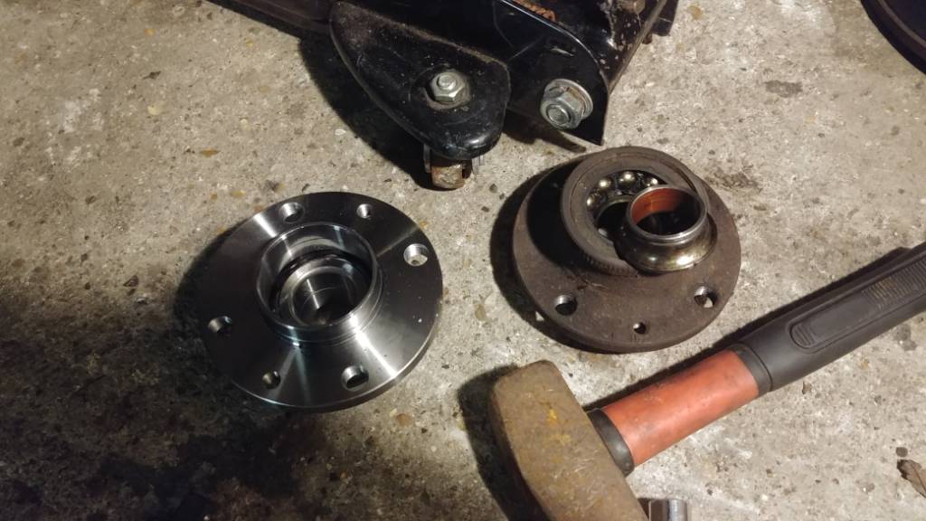

New & old side by side:
The outer race began to bind so rather than risk separating it all I put the fat washer back on and the nut and gently wound it on until the hub was fully home.

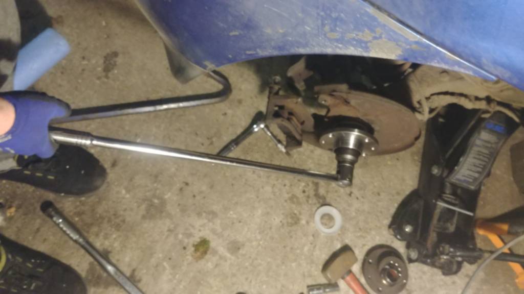

My torque wrench only went up to 210Nm but it needed 210ftlbs. So went back to breaker bar and added a calibrated amount of angle (guessed).
BIG GUNS
Finally added my spacers and a considerably nicer looking wheel - well I gotta to put the new bearing through it's paces!
Verdict tomorrow - it's been sounding like I have the Luftwaffe on my tail all week!
Well, the wheel bearing is silent - WIN!
