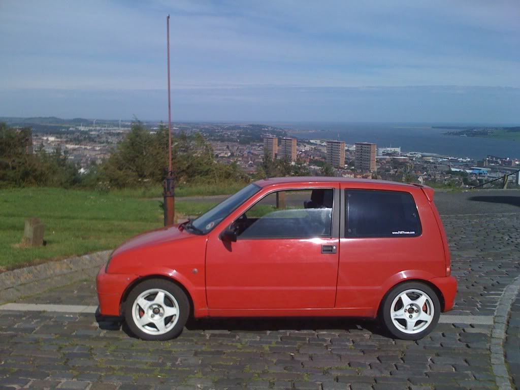

a few pics :D ignore the glove on the breather, it's just a temp stopper until i get some hose sorted :D

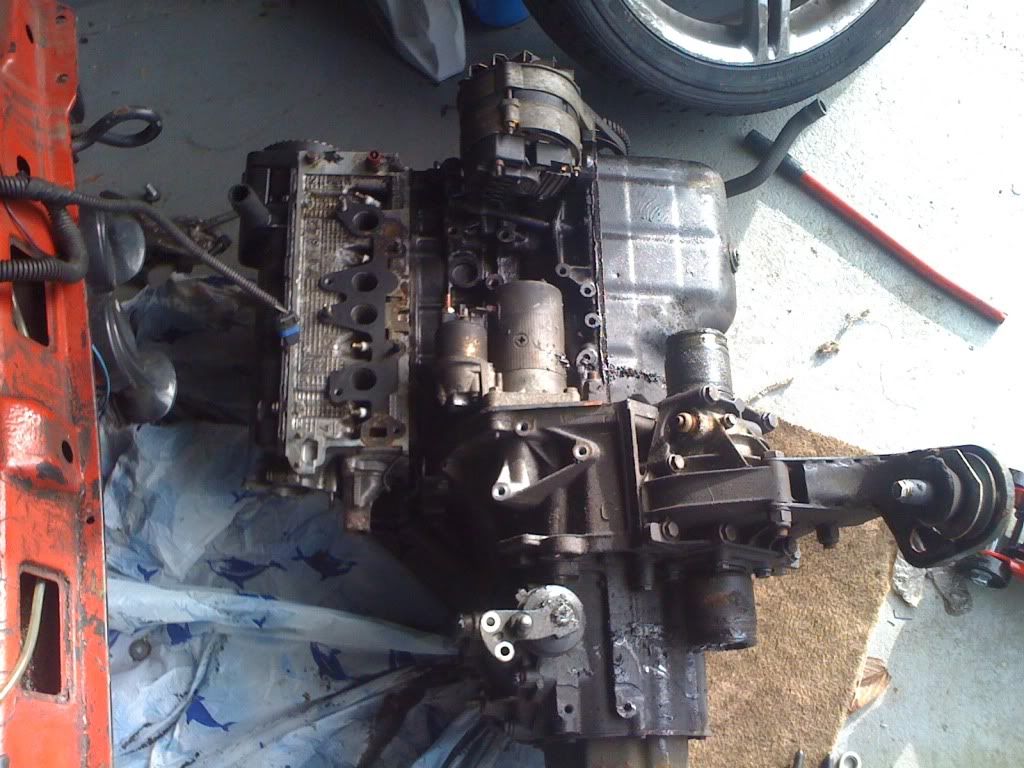

tiny update, got a couple of hours on it today, engine is more or less ready to drop out
all i need to do is remove the shafts, unplug the starter and alternator wiring then undo the 2 remaining mounts :) no more that 20 minutes work

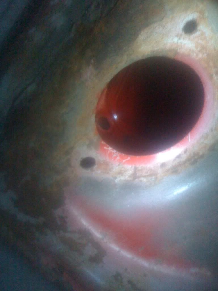

on a side note, glad i spotted this when i removed the drivers side strut today
that's it already wire brushed back a good bit, a bit more then a good dollop of protection is required me thinks, just been caught in time IMO, it's probably 6 months to a year away from becoming a major problem as is, treated it will be easily good for another 10 years
