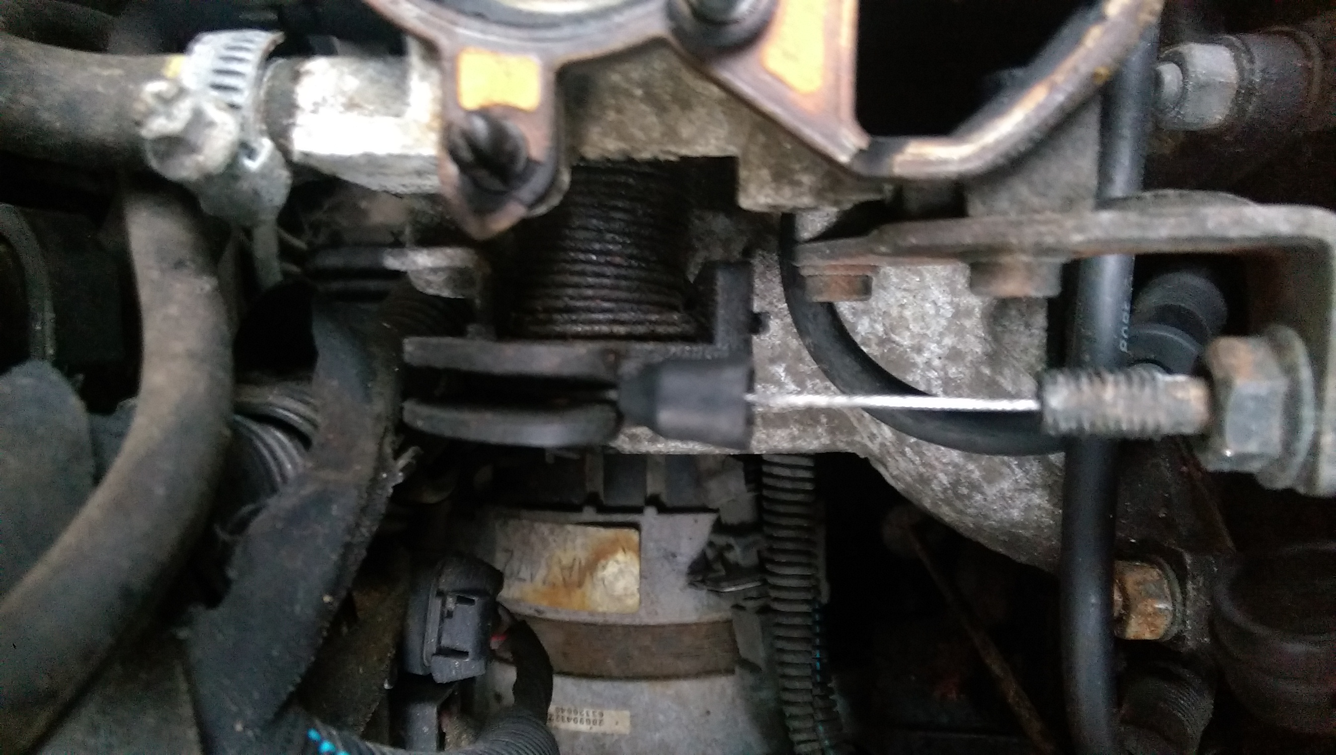

Shark bait is having trouble starting due to its idle control valve being stuck so when starting I have to play with the throttle to get it too start pain in the backside once I get it started I have to hold the revs at 2000 or it will stall so yesterday I went to remove the icv to find someone has stripped the torx on the harder of the bolts so I've dismantled the throttle body and I'm going to try hacksaw a slit to get a flat head in or drill the head off remove icv then get the rest of the bolt out pain in the backside lol on another note I really need a new exhaust for it cause it's stupid loud atm hahaha
[attachment=3:if4xybxt]IMAG0741.jpg[/attachment:if4xybxt]
[attachment=2:if4xybxt]IMAG0740.jpg[/attachment:if4xybxt]
[attachment=1:if4xybxt]IMAG0739.jpg[/attachment:if4xybxt]
[attachment=0:if4xybxt]IMAG0738.jpg[/attachment:if4xybxt]

Yeah you do, find a scrapyard, open your tool box and see what falls inside it. You might get lucky :cool: :lol:
From experience, old icv's on them don't really work properly again once they've been messed with. The 2 cheap options are to leave it be in the TB but soak it in wd40 and wiggle very gently back and forward with a small screwdriver whilst still blasting it with WD, or change the throttle body for another 2nd hand one. They don't fail much tbh so i'd just chance another from a scrappy.
When you get £'s, i recommend buying a vag com obd adapter, a 3 pin fiat/alfa to vag com adapter and downloading IAW scan. You'll then be able to monitor what the sensors are all doing and what the icv is doing etc.
Option 1 is on the cards atm no Scrappy's round me have a cinquecento sporting in atm or a sei so gubbed atm basically if your option docent work then wait till I get cash and buy a new tb got offered a new one with manifold posted for 35 quid lol
