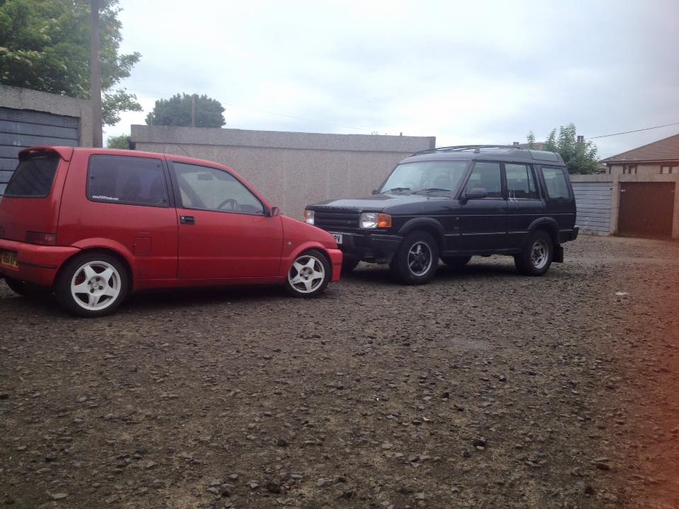

Well the cinq is off the road again, 2 weeks mot left and it needs a lot of tinkering before it goes near a test centre, so it shall receive attention. Mostly leaks needing stopped and brakes needing rebuilt.
Land rover..... just came up local at too cheap a price to ignore. (I.e no matter how **** it is, i've effectively bought an engine with a free Land Rover attached to it....which probably tells you a lot about it!) If it's not saveable then i'll not lose a penny. It's also half the cost of the Cinq to insure and is giving me the same mpg :lol: Very late 1994 300tdi.
Issues? Rust....... I need to arrange a date for it with the local welder and will let him have a poke around at it. From what i can see the sills look ok, the inner structure is fine, boot floor etc all good, Body mounts ok, Chassis seems fine. Both outer rear arches are needing welded, a patch on the passenger B pillar needs done and whilst the front inner arches look fine from the inside the front bumper corners have a bracket that extends up the way to bolt onto the inner wings... and mine aren't attached to anything so i suspect they are crumbling from the front back. Probably the rear crossmember needs looked at too as there's a small hole under the boot door. Also the back passenger door is effectively in 2 parts as the outer skin isn't completely attached to the inner skin but hey.... i'll just rivet that one together, slap some black hammerite over the rivets and hope nobody notices :D
Mechanically it's ok aside from a couple of oil leaks, electrically it's a disaster :lol: More italian than an italian, my personal favourite quirk is the sidelights that just switch themselves on and off again at complete random intervals.
