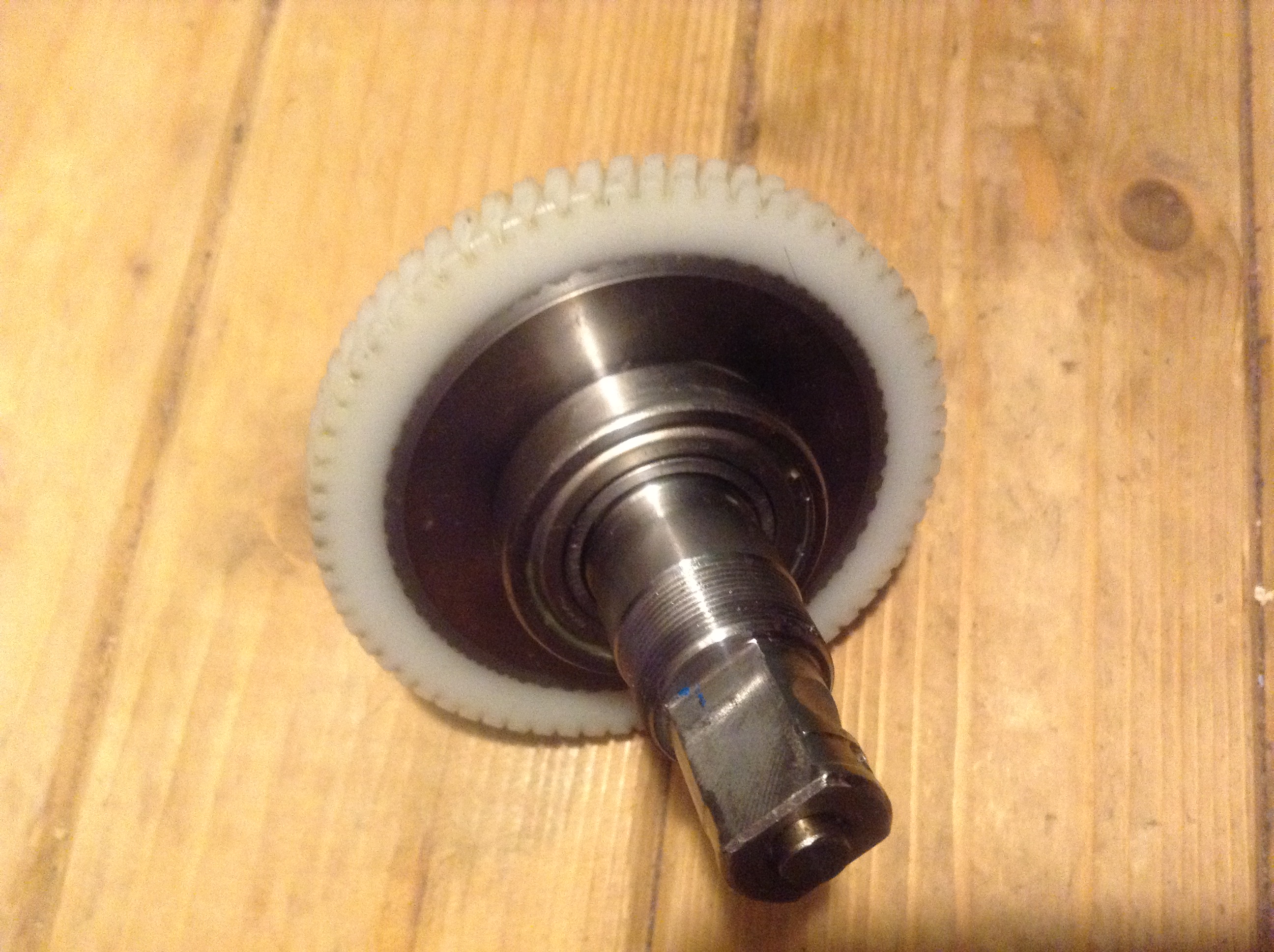

Question I have is does anyone know how to remove the top bearing in the steering column. (1077)
I'm sure I can work it out but sometimes it just makes it easier if someone else has been there before.

I removed that bearing once using 2 crowbars. I placed 1 like in the picture, then placed the bearing on top of crowbar (the tip of crowbar between bearing and plate), place the 2nd crowbar on top and then tappet them gentley with a hammer. The tips of crowbars slides in starting to push the bearing out. You have that way the first space inbetween bearing and plate, next you can use an extractor or something to pull the bearing out completley.

I've got it out. I drifted the shaft out with a hammer and a pound coin to protect the shaft.
I then turned the shaft around and used it as a drift to press the bearing out once I'd Brent the tabs out.
But about that the bearing head no numbers on it. Just "made in France"
Ok have to take it to a bearing specialist....
So I've taken the bearing to a bearing shop and they tell me they can't get one to replace it. It's a unusual size. Fiat don't sell it... Only the whole steering column for almost ,,£600.
I've trying a few bearing places and they all seem to say the same thing.
So, of anyone knows where I can get hold of a bearing for the top of a 1077 steering column please shout out.
Internal dimension. 22mm
External dimension. 36mm
Thickness of width. 10.3mm (although 11 or 12 would be fine)
Thanks....
I looked for the spare ones I have (I have put them in a good place), I thought to send you one... But unfortunately they are different size:
Internal dimension. 25mm
External dimension. 47mm
Width. 12mm
You should look for one in a scrape yard, but if you find the same column, I think you'll have to insist so they sell you only the bearing, otherwise they'll probably try to sell you entire column. And if you can't convince them to sell just the bearing, I think a sh column shouldn't be so expensive.

It does look the same. It looks exactly the same. That's a bit strange.
Here is a picture with part of the spare one I have, the inside bearing on the shaft. I got this column to use the sensor, but it was not working in the end, was even worse than the broken one I had (the computer and little motor are good). I bought a new one and it works very good. But my column is exactly the same size as this other one.
I mesured again and the bearing's sizes are the ones I put earlier.
The chassis/body is the same, 188.
