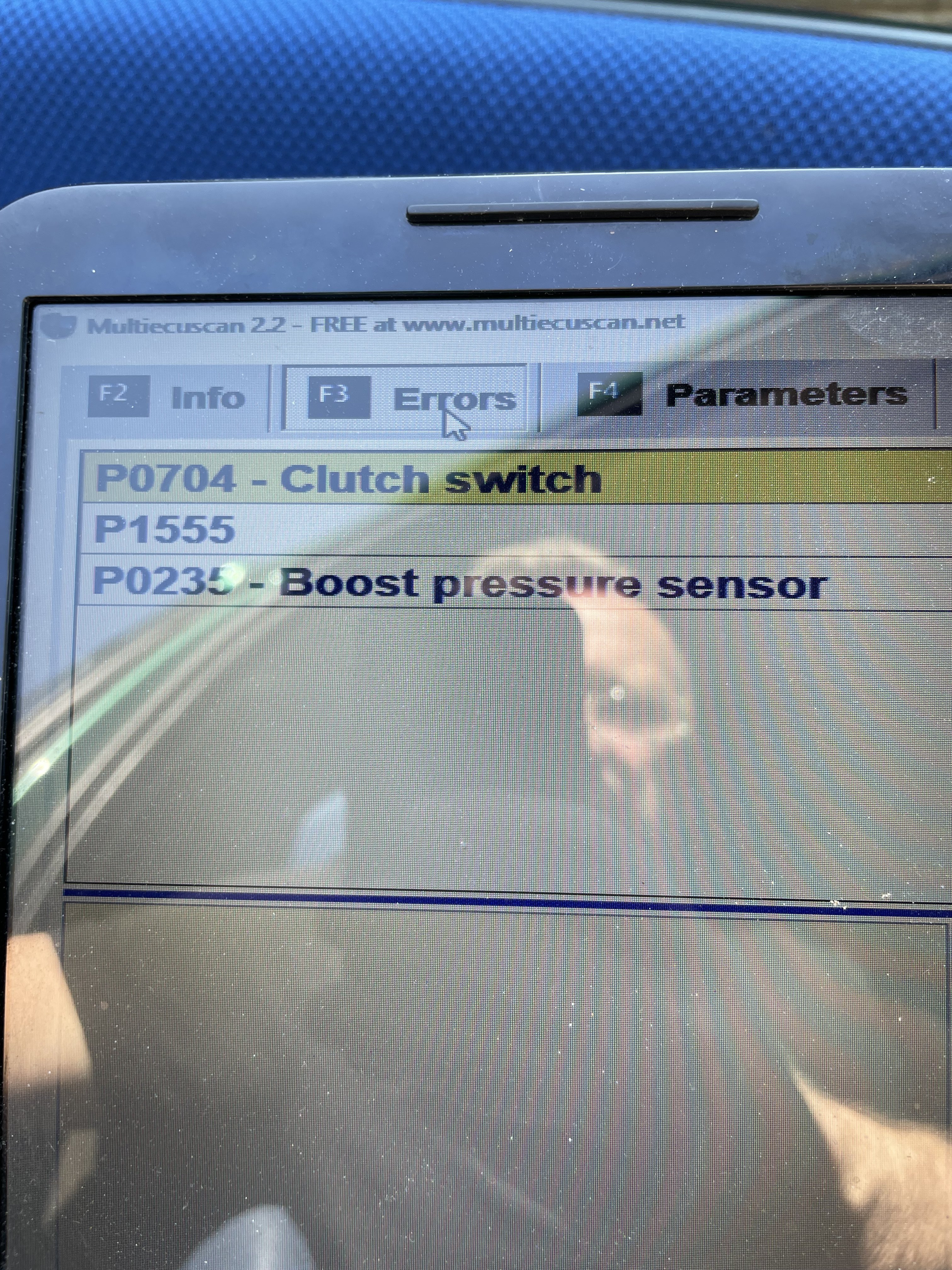

Got a Punto mk2-2001, 1.2 8V. Turning full right at the parking lot my steering warning light came on. Hooked up Multiecuscan and got P0704, P0235 and P1555. Erasing fault codes didnt work. Any ideas on how to proceed and what to swap?
SEARCH the codes on here
In Advanced 😉
You may find the fix for a 188 punto
What kind of "boost" (in 1,2 8V) do you have? :confused:
Select the right car, ECU (engine) type. Then we can "diagnose" it (maybe).
If you are using pirated soft., try FES (not MES - it has some weird "copy protection" features, not working at all or reporting wrong data).
Ahh! I’ll dig that out later this week. Just got towed to a workshop after it just died on the road. Cranks, starts for 2 seconds and then dies. Typical immobilizer problem, right?
Finally back with the specs.
Its a magneti marelli/IAW 4AF/4EF/59F/5AF EOBD Injection. Codes was read with multiecuscan 2.2 and apropiate ELM327.
