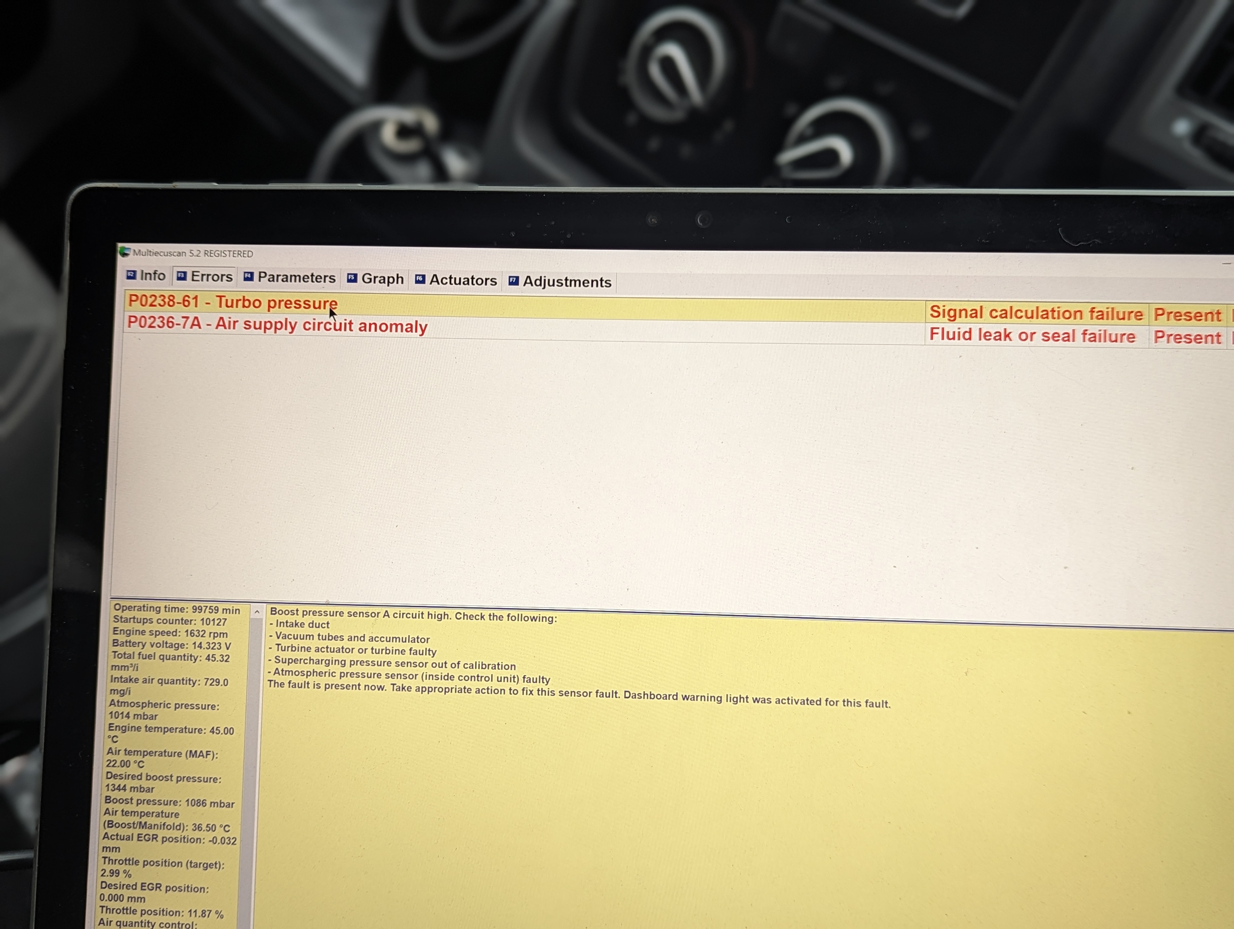

Hi all, first post! Ducato 2017, twin EGR. Got the following codes - po236-7a and po236-61, limp mode and the check engine light on. Just waiting on a new MAP sensor and boost solenoid. No splits on the hoses, exhaust isn't sooty. Do either of these two components look likely? And, side note, what absolute spoon put the map sensor there - I've lost skin by the inch.
