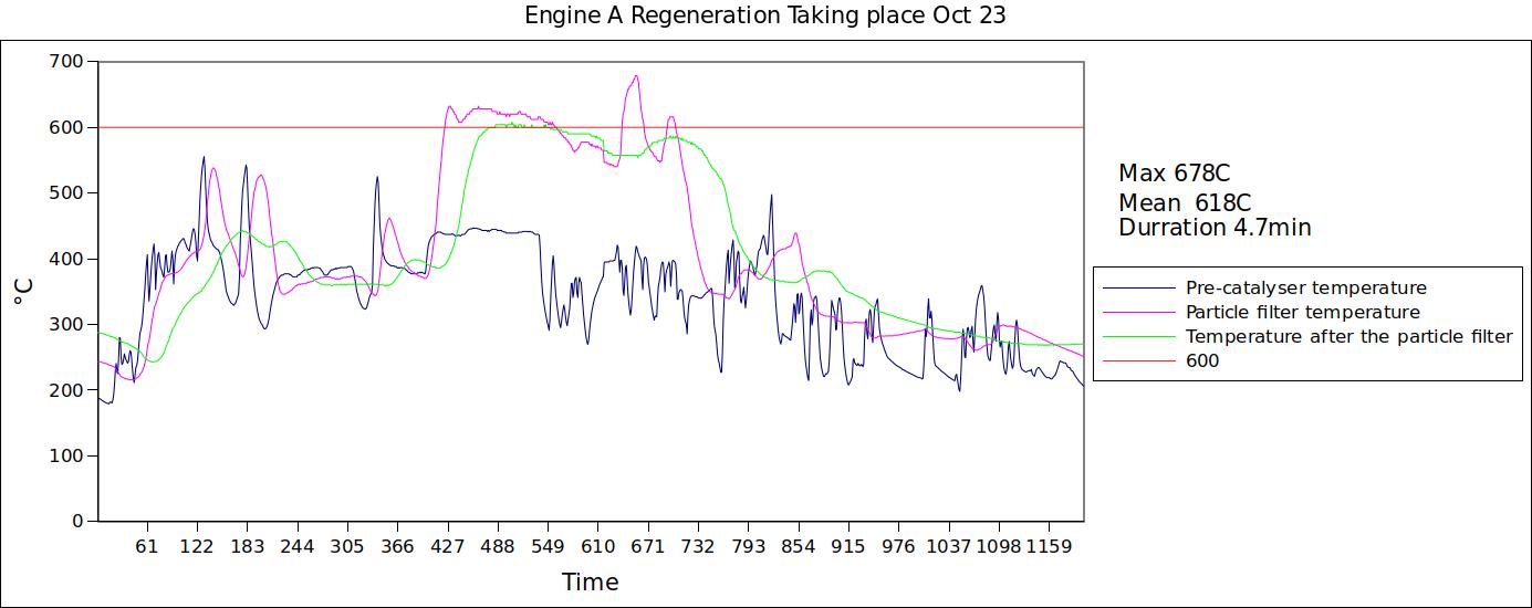

Bellow is the only example iv'e got of this precise graph. the DPF temperatues durring a regen. There is a way to capture it when it happens but is not very predictable. This example may not be too typical as it was interupted by stoping in a layby saving the data starting a new file and going again (the engine was not stopped) i was unaware a regen was happenning. Could the max actually get upto 700C, 690 at least in your case
I've monitored (but not logged) all 30+ regens on my 27,000 mile twin EGR model thus far and high 600s are indeed commonplace. Yesterday's regen peaked at 690 but I've seen 725 degrees briefly before now. V28 manual, squeaky clean exhaust.
Thanks Steve, usefull to know but ive always had "show me the data " ringing in my years. If you could log a few examples id be happy as a pig in . 27,000 mile 30-40 regens =700-900 mile between regens , the highest ive heard of, interesting info adds to the knowledge base, thanks again.
