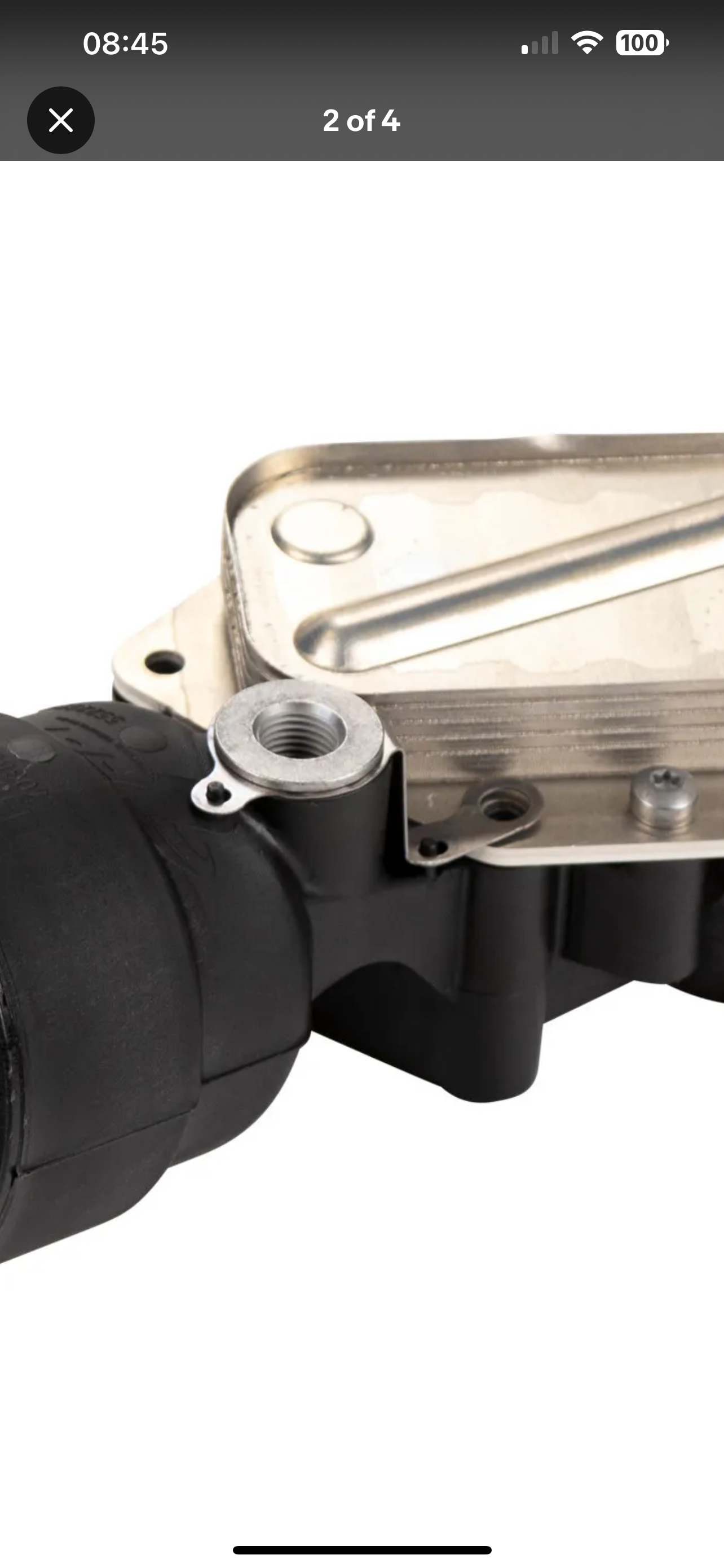

No just cleaned the area under the pressure switch and the longer bolt that goes through the metal that earth's the pressure switch to the engine. If you get a multimeter and test the continuity between the metal part of the switch and the top of the engine to see if it's getting a connection to the engine 👍

Here’s a pic of a new oil housing i see what you mean now
Here’s a pic of a new oil housing i see what you mean now View attachment 437742
