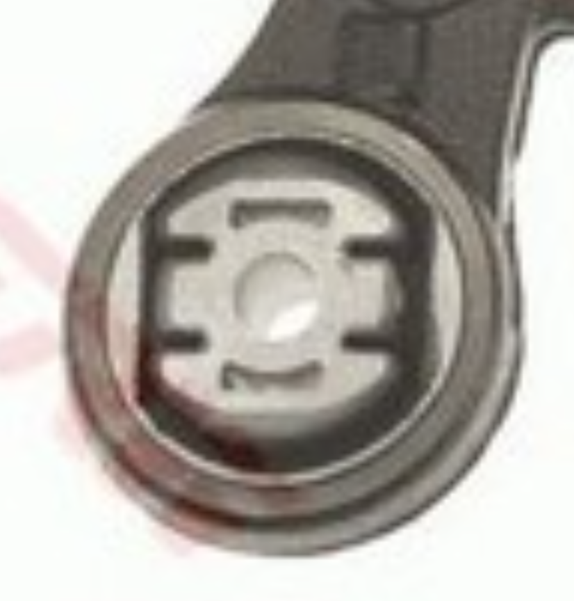

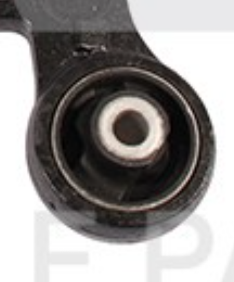

Look at the suspension arm rear bush
Is it
A
Or
B

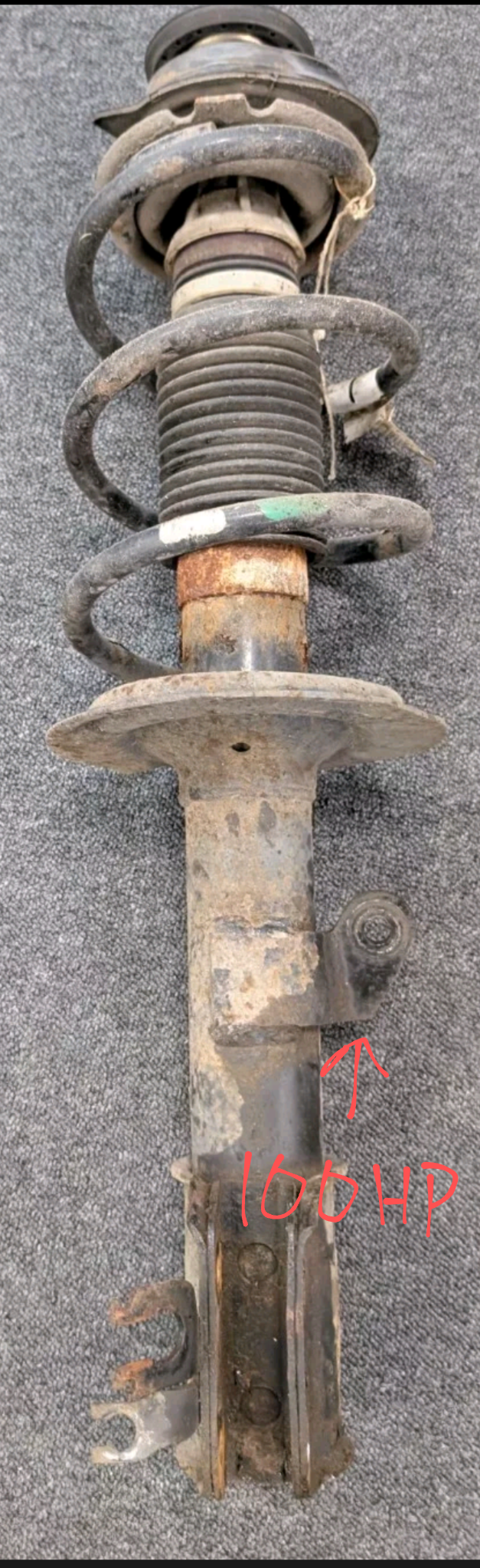

Owners often are keeping the 100HP running by using standard panda parts instead of the more expensive and unique parts
Arms, springs, bump stop, and top mount are different to the standard 1.1 or 1.2
@irc has converted a 100HP back to original, due to mismatch parts, not sure what was involved, some parts are quite difficult to tell apart, as far as I remember there was quite a big difference in the handling
I have done two and I have kept back a full set of parts for a third which I will get round to starting one day.
Best way is to extract all of the correct part numbers from EPER, and then find OEM suppliers for each part.
Trouble is, some parts have been on restricted supply for some time, and are starting to become unavailable permanently now.
Something else to watch out for is that many of the "box shipper" type suppliers don't seem to understand that there's a big difference between the 100hp and any other Panda with a 1.4 engine (like the Natural Power), so will happily direct you to parts that are wrong.
I think the difference in handling and driveability from using the correct parts is worth the effort.

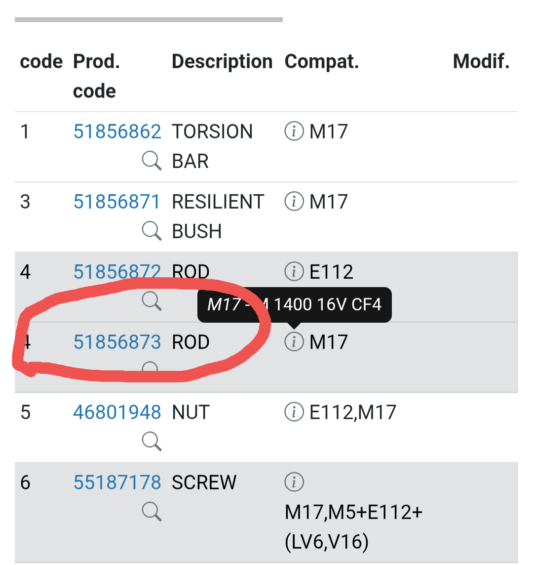

20mm internal diameter does not sound right for a 100HP
1mm per side on a 22mm bar
Not surprised they have started to wear
0.25mm sounds better to me
A couple of sheets of paper per side
Bushes come in 19.5, 20.5 and 21.5
I assume 20mm is refering to the standard 1.1/1.2 ARB size
You can spend hours taking screenshots and quoting manuals. It's not real, what is real is on the car. I've owned and worked on over ten of these cars standard an modified. Seen all sorts of combinations of bushes, links, springs, struts, arms etc etc. Tried all combinations of the above too including adjustable drops, even abarth parts.
The opposite droplinks fit properly and stand a chance of lasting longer than three miles. The others don't. Might be why they changed them.

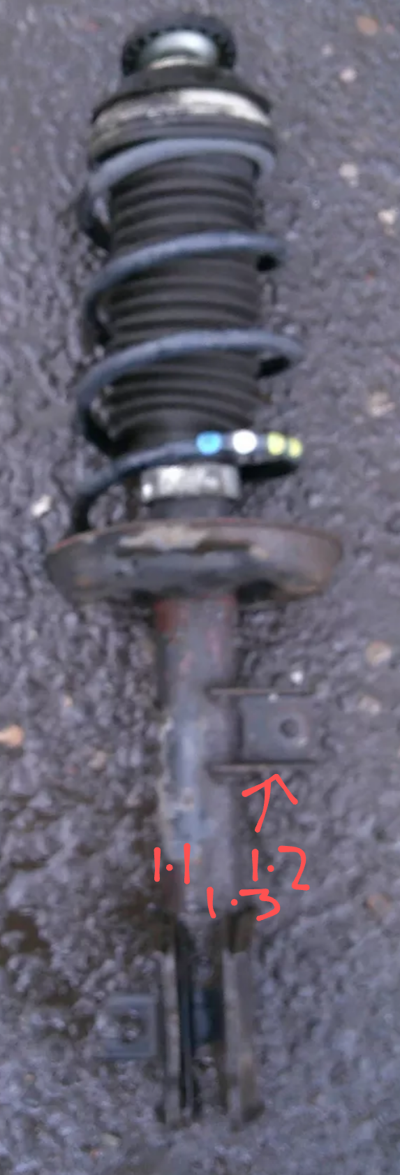

If you fit 100HP struts
you fit 100HP drop links
If you fit 1.1/1.2/1.3
You fit 1.1/1.2/1.3 drop links
Very early on in this thread it was established the wrong struts were fitted
Every part of the suspension on the 100HP is unique rear bush, strut, spring, top mount and drop link
And the attachment for the drop links is in a different plane
If a garage fitted the wrong struts without telling the customer, the answer isn't correct the problem by fitting the wrong drop links, it needs to go back and and given an opportunity to rectify the problem
Getting the correct parts is getting costly, you can give someone the option of a cheaper alternative, say a from a 1.3, but it will not be as good as originally designed otherwise Fiat would have just fitted them in the first place
