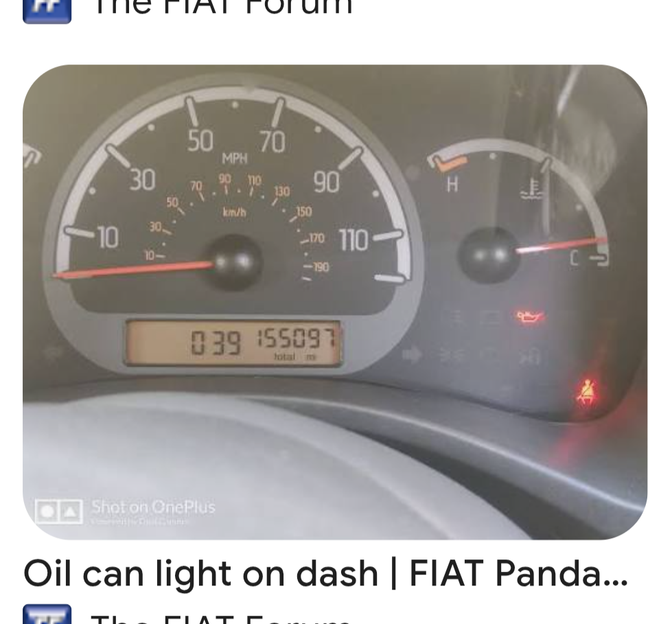

I don't see the oil can or battery coming on and staying on
Usually indicates a faulty block ground
Start with the tests above
Or a visual check under the battery tray
Leave the fuses for now, it's possible to introduce a new fault, let's deal with what we can see
Power and grounds will also effect the airbag but I am ignoring this for now as its more than likely be part of the same issue
This is the oil can that should comes on and stays on untill it's been cranking
There's only one wire going to it, and it uses block ground
It's highly likely block ground is your only problem
Thanks koalar ;) the oil can is staying on the display so next is the block ground and starter voltage.
What am I missing
I don't see them on in your video
Both should stay on at ignition on and cranking
At least untill there enough oil pressure built up, engine turning over, which isn't hapening
Oil and battery should be on and here ?

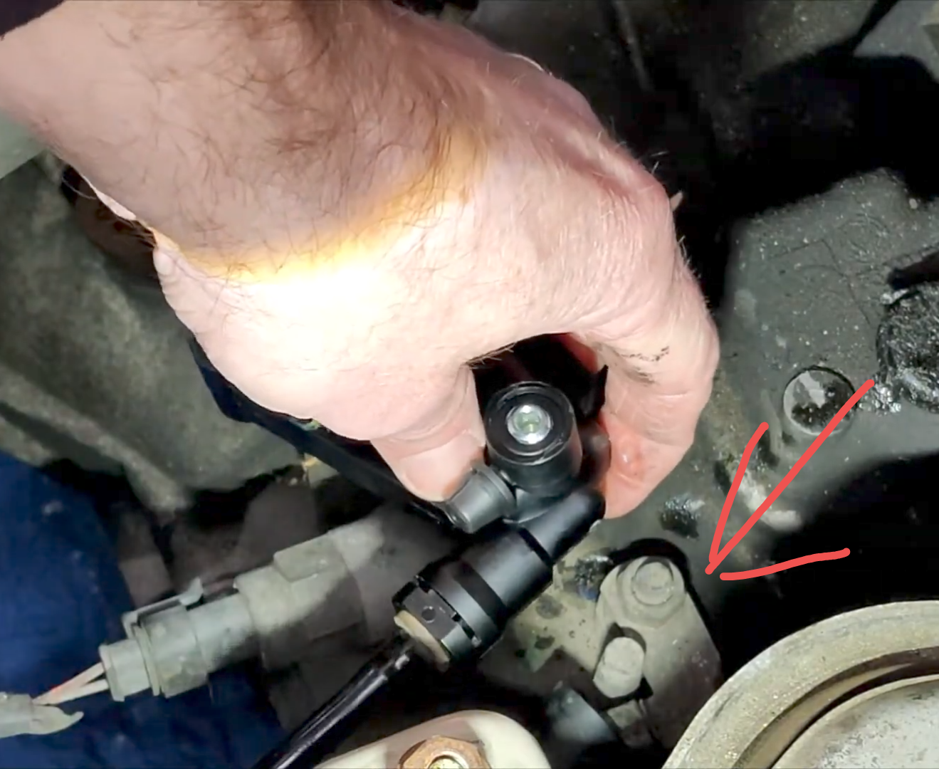

It highly likely to be the cable attached to the gearbox

This cable under the battery tray is likely
I couldn't locate the earth strap under the battery tray, mine seems to have a different layout.i put a jump lead from the negative to the block and the car tried to start, what do you think of this??

Looks like the cable disintegrated to me
Pretty sure if you look at the passenger side chassis rail there will be a wire rotten throgh
It's hard to get a good contact with jump leads
Drives side engine mount I find is the easiest place
Which is why is diagnosed them via the method in links in post 7
But if you replace the cable and you should be good to go
Like this one
Thanks for all the help guys 👍 much appreciated. I bought an earth strap in a motor factors this morning and once fitted, the car started better than it has in a long time 👍
