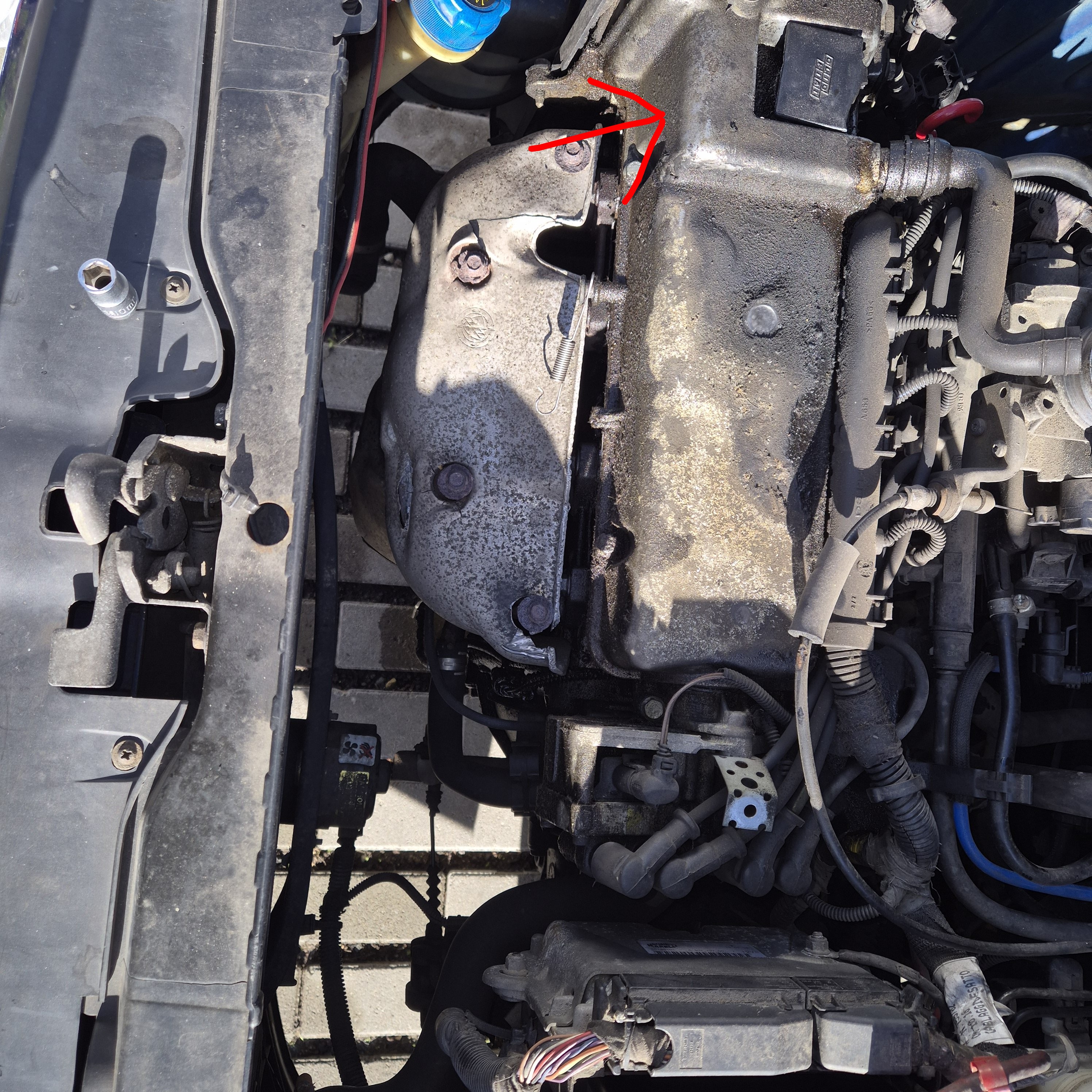

i would appreciate it if you could maybe help give me guidance on how fix /clean the rest because the oil and the plastic burn smell, maybe new wires or whatever, so i can get my car and engine in better condition please.
many thanks !
2005 it probably leaking from several areas
I can see this pipe is leaking and or split
It a matter of starting at the top and cleaning and waiting to see where fresh oil is coming
Worth checking inside the bell housing before spending any money, as a leak inside here will need the gearbox down, most other things are fairly simple
Also check the gear selector,
Worth checking as low oil in the gearbox can become expensive
There's an o ring behind the coils that prone to leak
