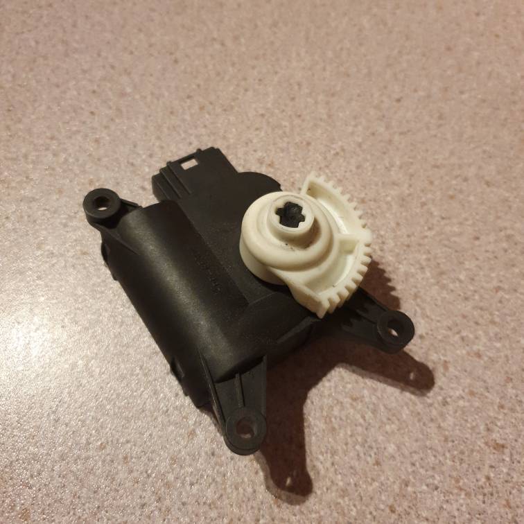

Cheers but unfortunately the actuator itself works perfectly - it's the small plastic shaft it acts on to open/close the hot air flap that has the issue. It's completely snapped off meaning the heating permanently sits on cold. Handy for the colder months ahead.
From previous posts it looks to be an inherent problem with the climate control that either requires the whole interior to be stripped apart and the heater itself replaced at a cost of 1k in parts or a bit of a bodge attempted.
I know what I'll be doing.
I'm going to have a look at possibly fixing this with the trick in this topic. Access is a bit of an issue but we'll see how it goes.
https://www.fiatforum.com/panda/297997-panda-100hp-no-hot-air-heater-5.html
Oh man, looks like it's quite a common issue, something to look forward to :confused:
Looks like this is an important tip:
If you have a working climate controlled system you should avoid enabling the heater while the fan is on. The amount of torque required to change the "flap" is high which likely leads to the common failures we are seeing here.
Keep it always in "auto"mode instead of fiddling with it.
Just did three of those gears on my son in laws Bravo together with my son (pics in the Bravosection).
It was a real pain in the lower behind (and that's an understatement).
gr J

Auto mode would constly work the flaps to keep the cabin temps correct so If anything would put more stress into the system
But it would do so in a controlled, logical way.
I've had several Fiat's with climate control, always on full auto and never had a problem.
The original cogs by the way are terrible quality. They seem to be two parts glued together. The new ones (off E-Bay) we put in the Bravo were 3D-printed sturdy ones.
