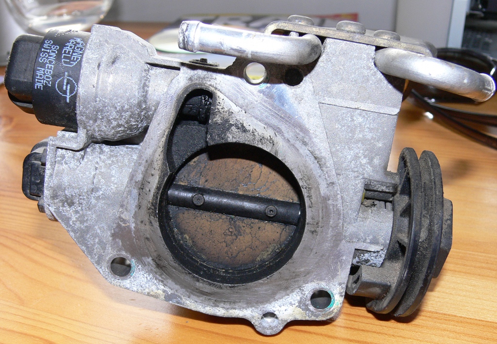

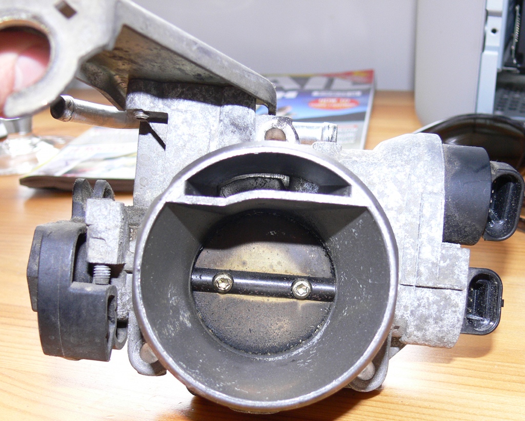

i think the engine is choked at higher RPM due to the small 1242 16v TB, or it might just be the ignition timing.

You might try the 48mm Dell'Orto TB off the K Series: looks easy enough to fit (see Aaron) and you can pick up the aluminium ones for £30 or so. Come from the right city in the right country, too!
Or, just fit this, 48mm throttle body, which is literally a bolt on replacement, and electrically identical. As the meer cat says "simples".
PS. Its not in use cough cough PM cough :p
