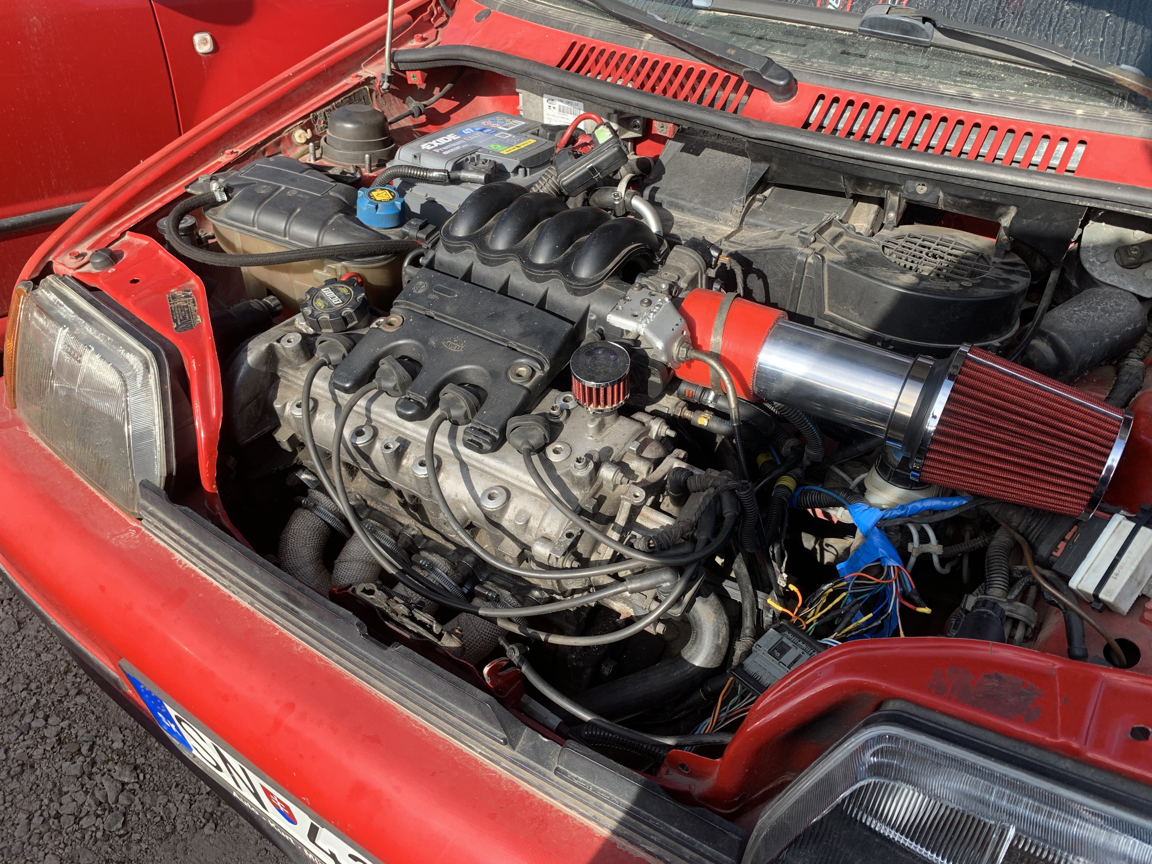

Hi guys, I did an engine swap on cinq sporting some time ago to a 1.2 16v engine from punto mk2. I got a manifold and throttle body from mk1 and ignition coils from cinquecento engine. The thing is, the car starts, but it appears as it has a bad air fuel mixture or bad ignition timing. It is misfiring and doesnt idle right. The fuel pressure is about 3 bars on ignition and drops slightly when car is started. Water temp gauge is not working for some reason it just jumps to 130 on ignition and drops to 0 on start even if the car is hot. Has anybody had same issues? I will try to attach some photos and videos. Hopefully someone can help me.. Cheers
In the video where car idles around 1k rpm the engine is about 80 or 90 degrees warm.
In the video where car dies engine is cold.
Temp gauge is wired from cinqs green/white to puntos green/white cable on D4 connector.

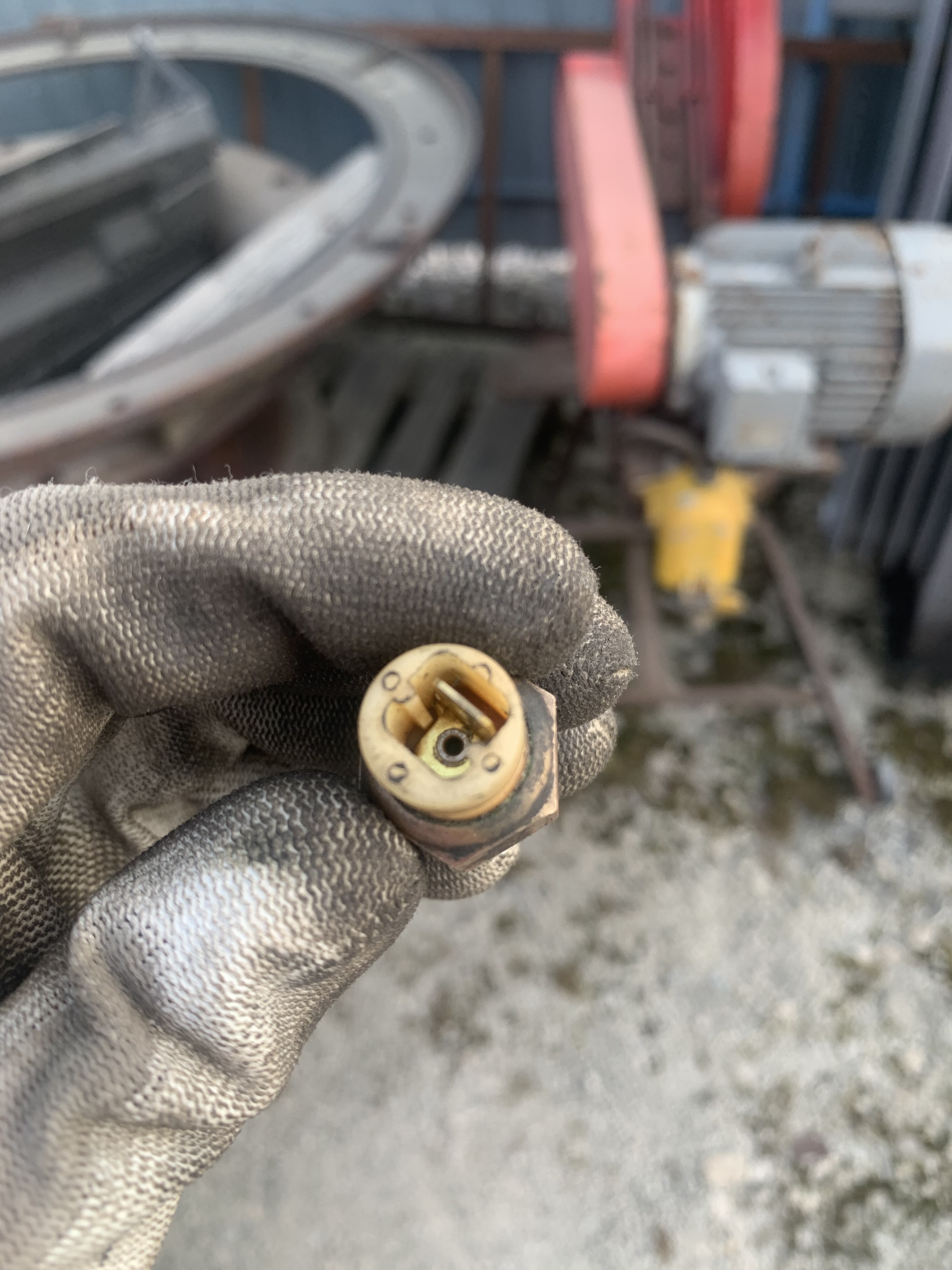

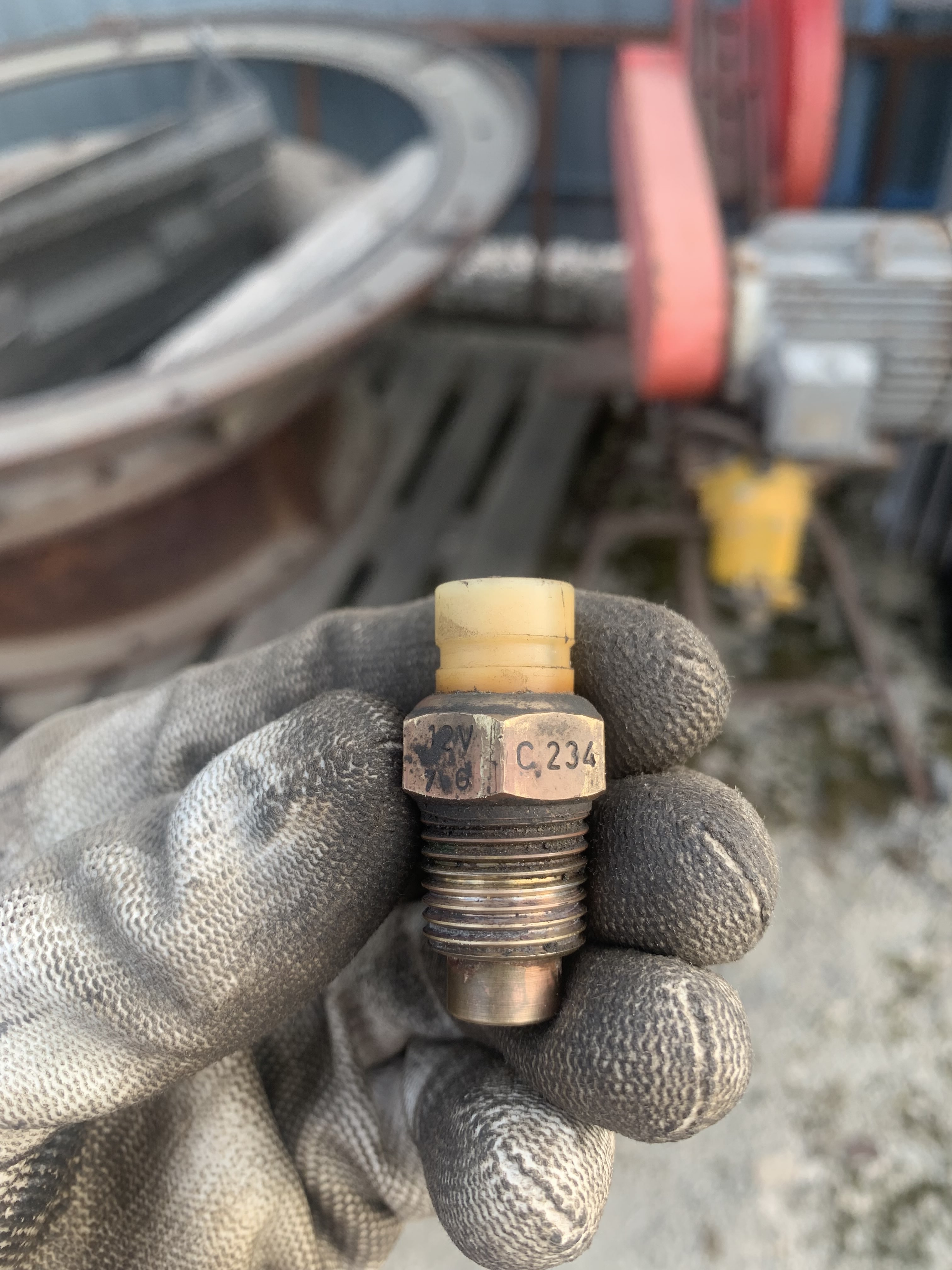

New knowledge: Cinquecento engine appearently has 2 coolant temp sensors. One for signal to the ECU and the other for dashboard. As I mentioned earlier, I dont have 1 grey white wire connected from the punto loom (single pin), and this wire could just be for the second temp sensor that is sending signal to the ECU. Cinquecento loom has green white wire (dashboard signal) as the single pin connector and punto loom has green white wire attached to the two pin blue connector.
I forgot to take the battery with me today so i couldnt test it. I will try to connect second sensor and update this thread for anybody who reads this lol.
I havent seen this piece of information anywhere on swap guides so it might be atleast a bit useful for someone.
