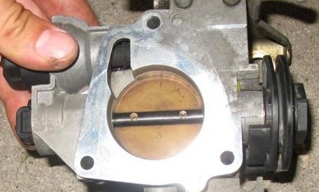

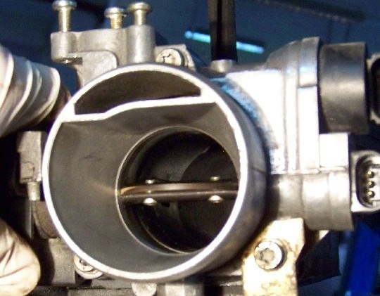

Got that 48mm TB from a 1.6 16v Bravo/a, ta mate ;)

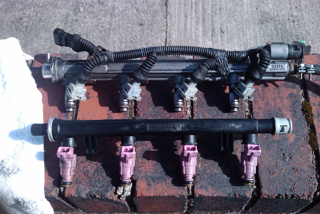

Also Kristian tipped me off that if you get the fuel rail off a brava 1.2 16v, and mount it onto the mk1 sporting inlet manifold.. you can use the injectors that come stock with the 1368cc stilo / panda / 500 engine. These injectors are the same physical size as the ones used on the abarth, and on the t-jets. The only option prior to this was spending around £80 per injector for some injectors from a Ducati Monster.
TB's
stilo 1368cc 16v injector (pink) vs punto 1242cc 16v injector
stilo injectors fitted into 1242 16v brava fuel rail vs mk1 1242 16v punto sporting fuel rail and injectors.

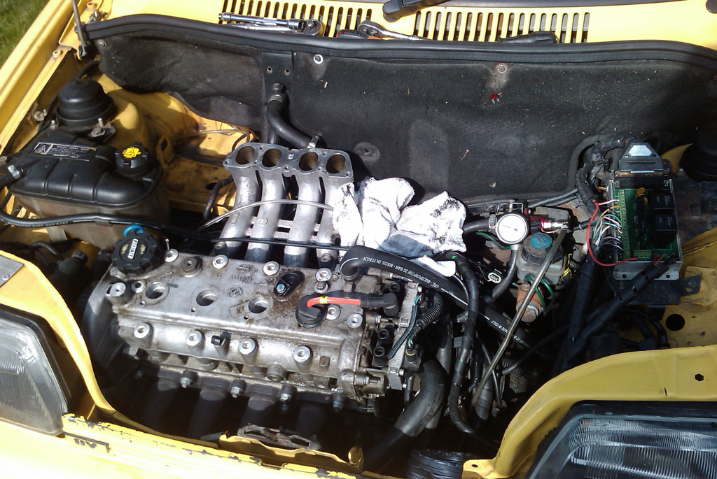

all goes in 'ere;
the new injectors dont seat as far into the ports as i'd like, but they do seal to the manifold. Might look into re-jigging the holes.

might work on the p75 setup, i've got a p75 manifold in the garage i'll have a a look and see if the old 16v fuel rail will fit it. if you were to use the same setup as me you'd need an external fuel reg as there is not one on the modern plastic fuel rails.
Can't see the fuel rail working as the P75, surely, has uneven spacing between the injectors as do all the 8v MPIs,
(Here's one I butchered earlier, shown with the P75 injector and a pico type out of an MPI.)
while the spacing on the 16v are even (1 bank of 4). But it should be possible to mount the injectors (maybe with a little modification to the mounting lugs). Depending on the ECU you're using you may have issues with the impedence of earlier and later injectors.

I have some Monster injectors I got for £25 each......... But early K series injectors are said to be fine up to 200bhp (look for a K Series with an alloy throttle body) and should be obtainable from a scrappy near you for peanuts.

REgarding the dpeth of the injectors into the holes, should be easy enough to modify, but it is purely the o-ring that provides all of the sealing, so should be ok. Get hold of some t-jet ones and the nozzle will be sitting a lot closer to the valve anyway :D

it's all fitted and running, fueling is way out atm and currently busy sorting a last minute move to Sheffield, so not had the time to sort it.
