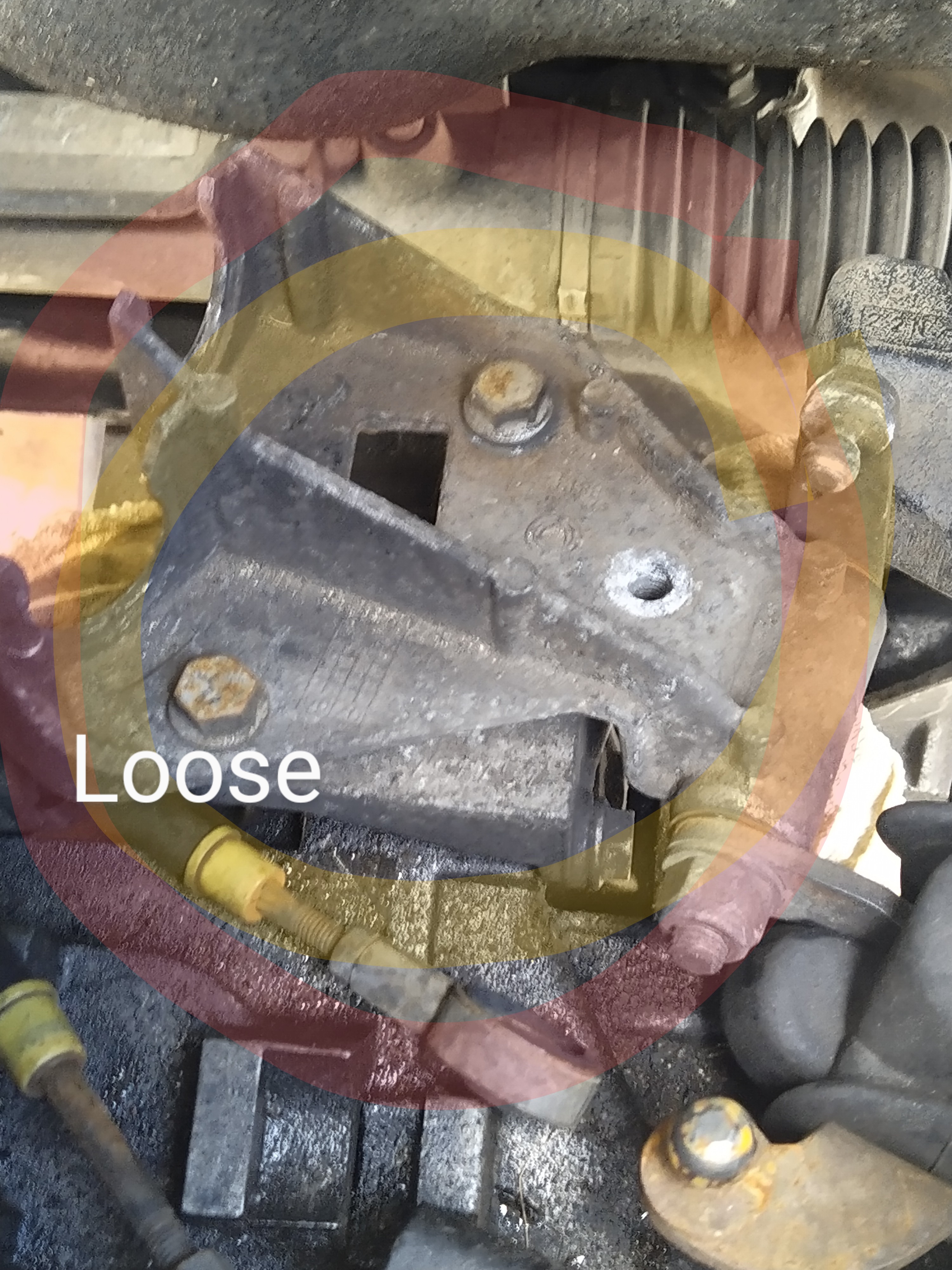

Hi all . Feb march 22 used this forum and it's members to replace a clutch in my Fiat Fiorino 1.3 multijet diesel van 77000 on clock . So new clutch has done 2000 mostly short trips. Went to Wouldham from Cornwall ,long trip , clutch started slipping so bad could not take off in 1st and 2nd. It would blast along happily in third or fourth. It eventually burnt clutch out and had to be recovered to Cornwall. Van now up and I am working on it. but rain stop play today. So had a look and have a spare release bearing. However I think I initially rejected it cos it looked wrong . Can someone tell me , by looking at photo if it will work new one on left has nib sticking down .one on right old backplate shows (useen ) nib at other end. More info and photos available if needed
