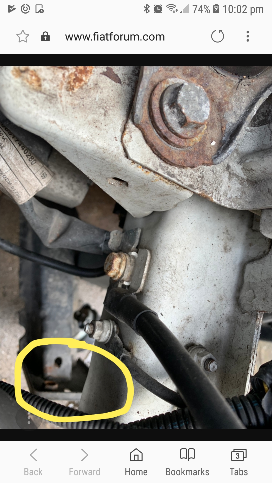

In case anyone comes across this post in future this is the location of the earth leads on the chassis rail
Ha Ha Ha!!
It seems the joke and £27 for a new earth strap is on me....!!!
Car failed to start again this morning without the clutch being depressed....oh no I thought...back to square one.
However after reading the manual I found this...
Apply the parking brake, place the shift lever in NEUTRAL,
and press the clutch pedal before starting the
vehicle. This vehicle is equipped with a clutch interlocking
ignition system. It will not start unless the clutch
pedal is pressed to the floor.
So it seems the car starting without the clutch being pressed....is the anomaly here and not the other way around!
Maybe I will leave it as it is and stop fiddling!!!
