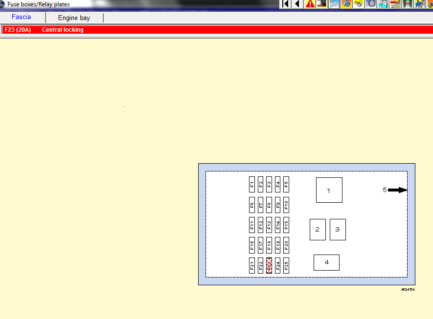

First place I'll check then, do you happen to know which fuse number this is?

here

ok, update on this..I have just got the key working, I messed around with the contacts and new battery and eventually the light now flashes and it attempts to lock the car but even when i press it the car locks wouldn't budge..so as suggested i checked the fuse which was F38 and there was no fuse in it (well done s and b ;), so I looked up the correct amp of fuse in haynes and i replaced this fuse and I thought a job well done...until when i turn the key now both doors do respond but they immediately unlock themselves, this is the same with the remoter central locking..they just keep unlocking themselves..so now i see why they pulled the fuse in the 1st place (n)
