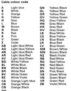

Can someone tell me where are located "connector blocks"?

go to that link provided by koalar and select wiring diagram. It shows you i think the colour codes and pinouts for the door connectors which you can open to test if the d097 connectors are working. The haynes version does not show the door connectors.

I checked that already, but I don't know what it should be like. I got approximately -12V on both wires, and when I lock/unlock the car, it briefly goes to 0V while the doors are locking/unlocking, then returns to -12V.
I have found wires but this is useful in future, thanks!
