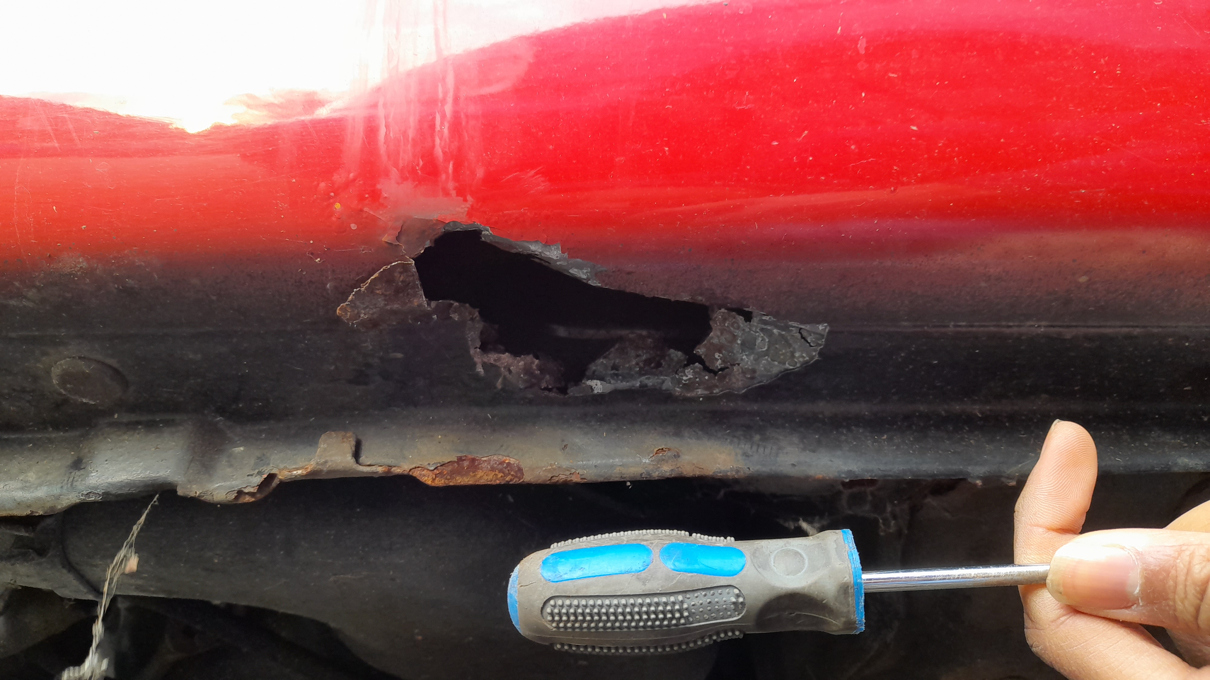

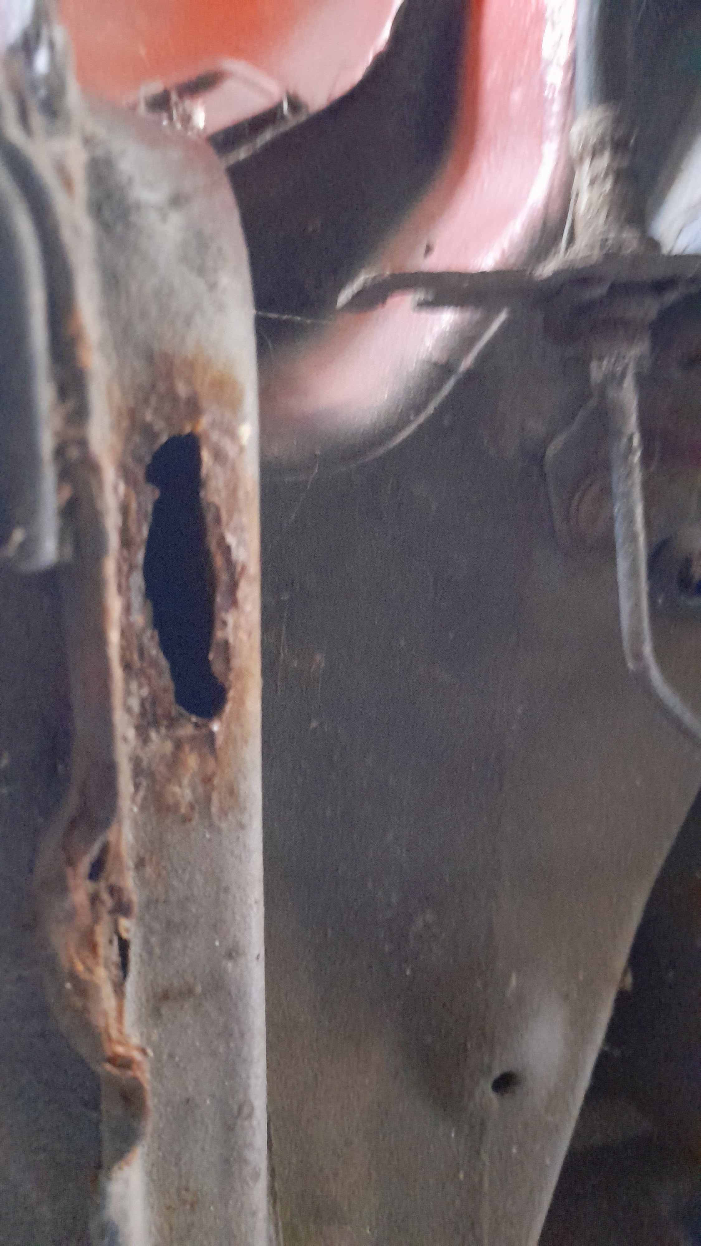

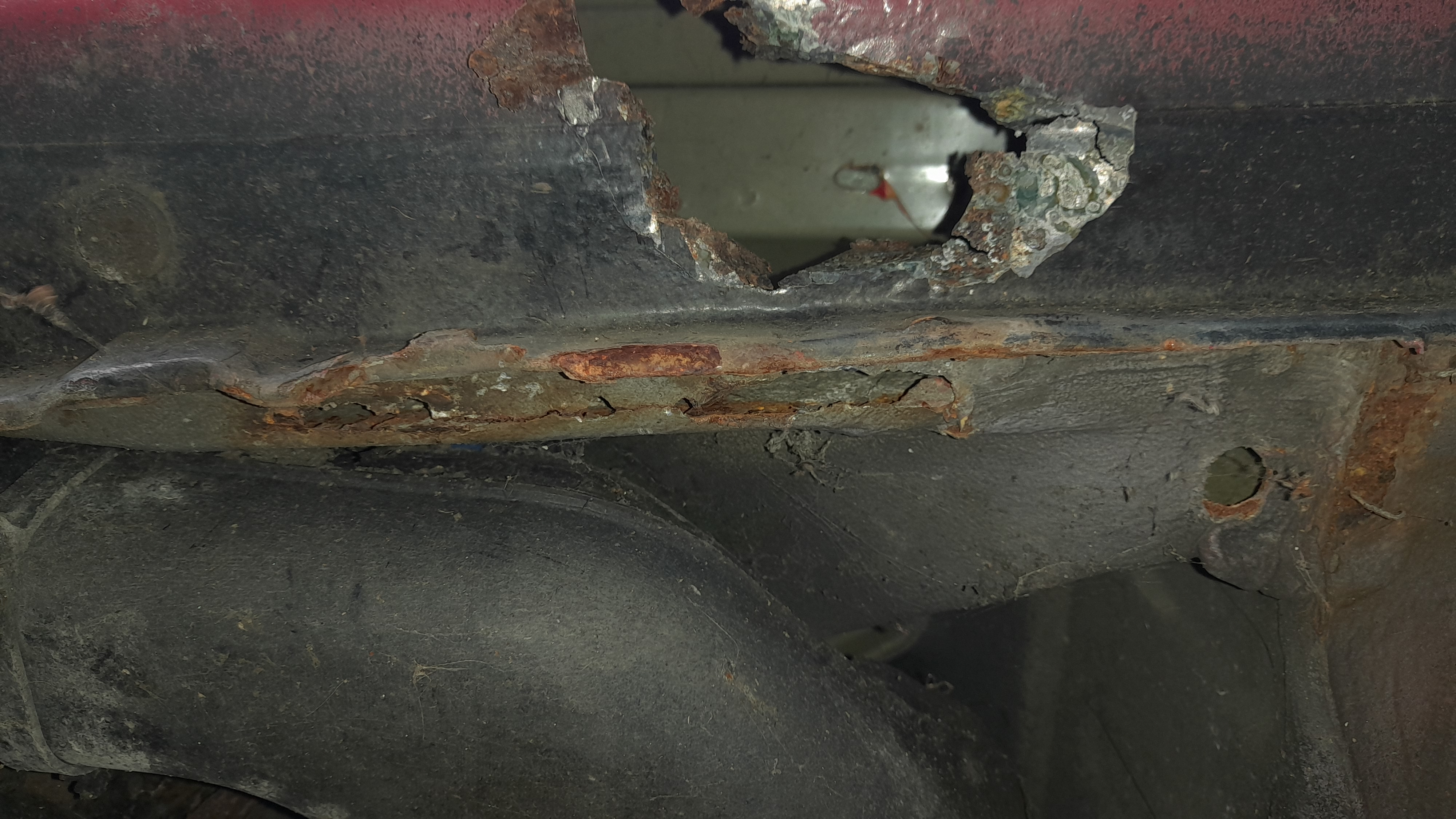

sooo i went underneath to do some work and discovered this... both reals rusted all the way through lol. the passenger side is much smaller then the drivers side gosh, how much would this cost to fix. I've looked everywhere else and looks okay but I think water got in and sat here...
The gist here is that, the rust you see it the bit that has gone through. There are probably many other areas that are badly rusted just not leaving holes and what tends to happen is you get one bit patched and another hole appears within a few months or following another winter.
Mk2 puntos also tend to rust badly near the seat belt anchor points and the top bolt of the rear shocks if the sills look like that then other areas are probably pretty bad

It’s just how much bigger the holes get when you put a welding torch near them??? 🤷 I’m sure you’ll find a mobile welder (every town has one, you know the sort) that’ll tackle it, and providing you don’t want it looking factory fresh a couple of hundred quid should do it, but there’s always the risk you’ll open a can of worms by doing so!
