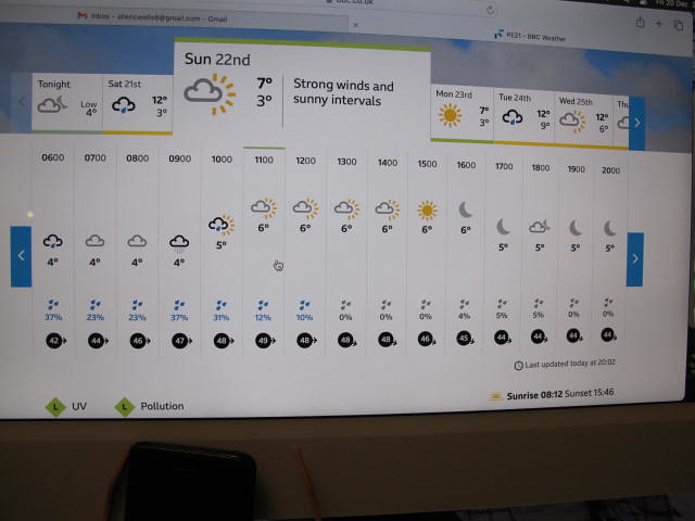

View attachment 457166IMG_0037 by https://www.flickr.com/photos/150639903@N08/, on Flickr
That's why I live in Torbay, just a bit windy.;)
Sun 22 Dec GMT1 hr 3 hr
HourWindAvg.GustTemp.Rain 3h CloudPress.
00:00W28 mphto44 mph8 °C0.1 mm98 %1014 mb
03:00W30 mphto49 mph7 °C0.3 mm74 %1013 mb
06:00WNW29 mphto46 mph6 °C0.2 mm89 %1014 mb
09:00WNW29 mphto45 mph6 °C0.1 mm54 %1015 mb
12:00WNW30 mphto47 mph6 °C0.1 mm42 %1016 mb
15:00NW29 mphto41 mph6 °C0 mm34 %1017 mb
18:00NW24 mphto38 mph6 °C0 mm60 %1020 mb
21:00NW26 mphto40 mph
