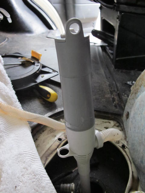

The transfer pump I have runs on 2 LR20 1.5 volt batteries , The part that goes in the fuel tank the the fuel is coming out of is
Hard plastic about 50cm long the it has a flexible see through hose with a automatic shut off valve so you are not able to over fill

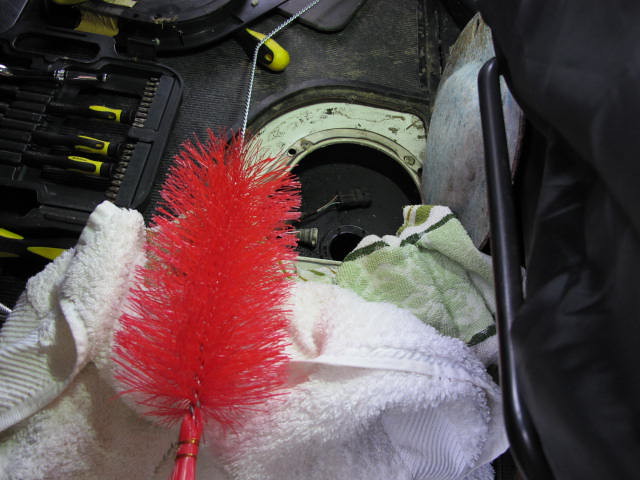

The brush arrived at 3.30 pm . A bit late to start now , No rain predicted for Sunday , I will crack on then

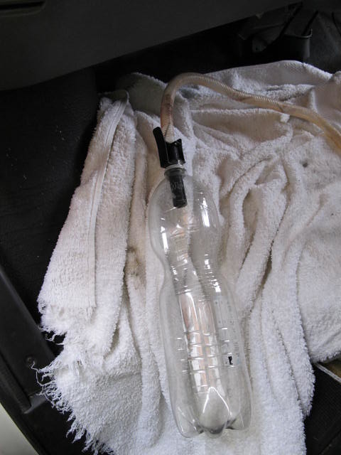

Also when pumping the ( Old ) diesel out I have decided to see if I can view it , Will deploy special tool number 667/ 1
A empty 2 ltr plastic lemonade bottle :)
Is that what used to be described as "the motorists friend" for long journeys;)
Some more progress today , Put the brush to use with a 5 minute swish around ,
54205716296_09dcfd02b8_z.jpgIMG_0024 by https://www.flickr.com/photos/150639903@N08/, on Flickr

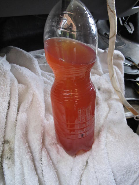

The pumped out around 22 / 24 ltrs of red diesel with my transfer pump, Very red . :eek:
54205959138_5052ac6d23_z.jpgIMG_0025 by https://www.flickr.com/photos/150639903@N08/, on Flickr

12 x 2 ltr bottles
54205959143_5080db8bf9_z.jpgIMG_0027 by https://www.flickr.com/photos/150639903@N08/, on Flickr
View attachment 456931IMG_0024 by https://www.flickr.com/photos/150639903@N08/, on Flickr
View attachment 456932IMG_0025 by https://www.flickr.com/photos/150639903@N08/, on Flickr

12 x 2 ltr bottles
View attachment 456934IMG_0027 by https://www.flickr.com/photos/150639903@N08/, on Flickr
