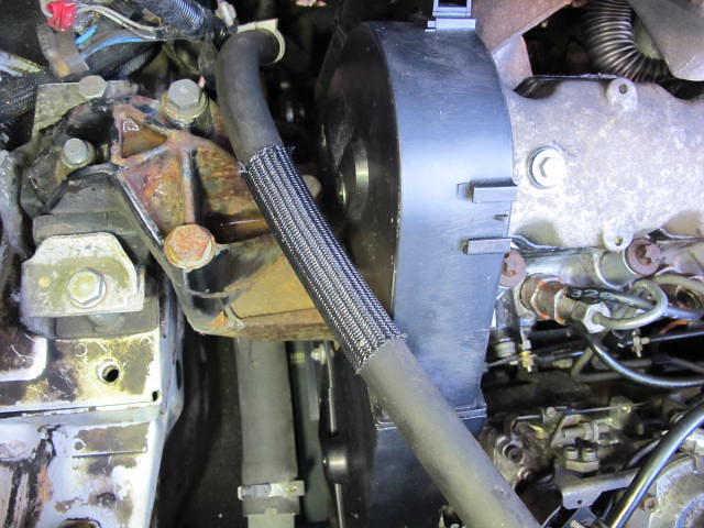

After a £420 recovery I now have it at home and trying to find the fault , It was a bit slow cranking over so I put the battery on charge over night , It the cranked faster , It occasionally tried to start with the odd cough , but did not start, I cracked the injector pipes and gave it a good crank standing by the drivers door so I could not see if any or how much fuel had sprayed out , When around the front it was a bit wet but not whet I was expecting , Did this twice until the battery was low again so stopped trying , This model does not have a key fob just a std metal key so I assume no electronics ? . I was a mechanic for 25 years but that was 30 years ago and I only did petrol engines, Anyone remember Hometune ? That was me with 3 vans covering east London and some parts of Essex , I hope to see out my remaining years with some time away travelling the UK but not in a van that won't run, So HEEEEELP :oops:😂 and I will even say Please 😉
54183576623_f789bedb27_z.jpgIMG_0004 by https://www.flickr.com/photos/150639903@N08/, on Flickr
54183300116_e86a0d18db_z.jpgIMG_0005 by https://www.flickr.com/photos/150639903@N08/, on Flickr

A photo of engine and injector pump may help clarify what version, plus engine Series number from Vin plate.

What type of fuel filter and primer does it have?
I'm with Mike, but will add make sure fuel can be drawn from the fuel tank to the engine bay. Fingers crossed it is the Peugeot engine, plus has a squeeze bulb fuel primer.
Photos of engine, fuel filter etc please

From a quick look at the photos, it looks like the Peugeot 1.9 XUD engine often used in things like 305s etc.
Like you I can't see a primer bulb in photos. Many of that model had a push button type primer on top of filter housing, if not the squeeze outboard motor tank type, both were prone to sucking in air and causing breakdowns as they age.
