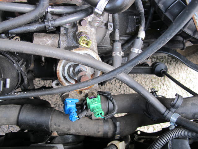

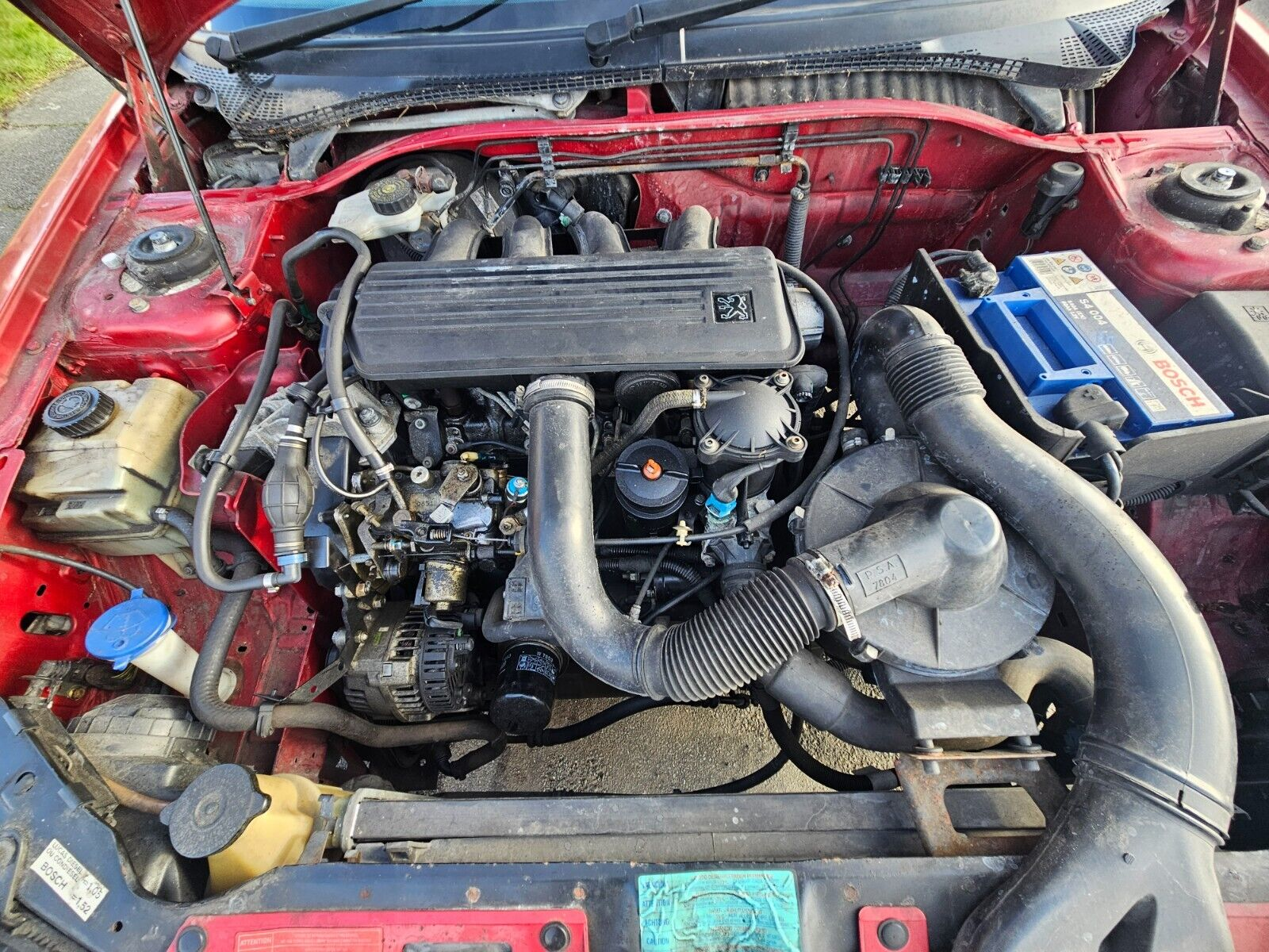

The Citroen BX with this engine had the button on the top of the filter. You knew it was good if itwent hard after 3 orso pushes. The grey rubber bellow prime on this in one of the pics above is not of a type ive seen before. I wouldnt trust it an inch. The BX relied on the diesel pump to suck fuel from the tank as you describe. The primer was vital. Peugeot 406 had an in line bulb that was great but vulnerable to long term perishing and air leaks. Any air leak on the fuel supply line will stop starting or make running bad. I had my share of trouble for a while. I would consider a known good filter head of another design. I would also rig a fuel supply with gravity on its side and try that as you suggest. Reverse blow the fuel lines back to the tank. Drain the tank and start with clean fuel. I think.my issue was the filter head sucking air. Its a very long time back though.

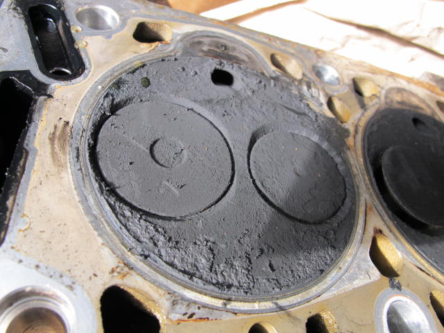

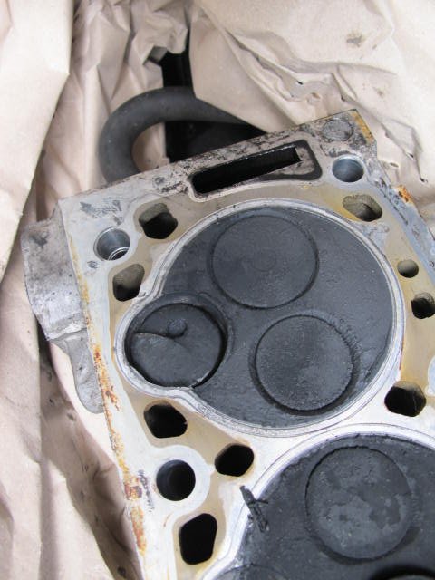

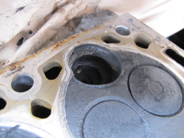

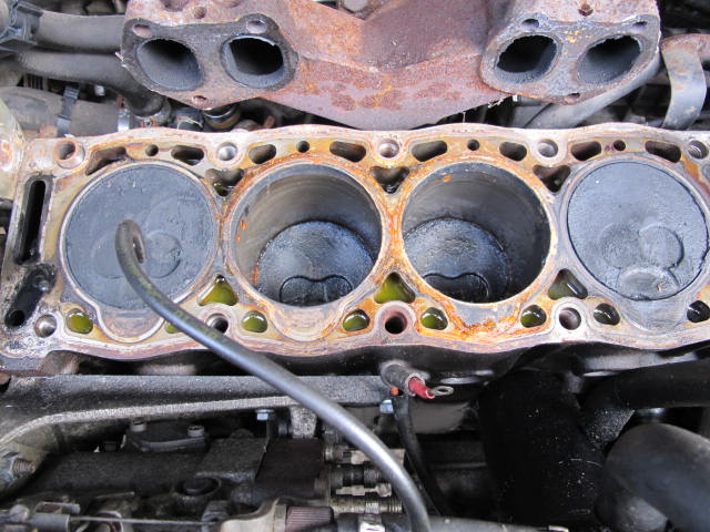

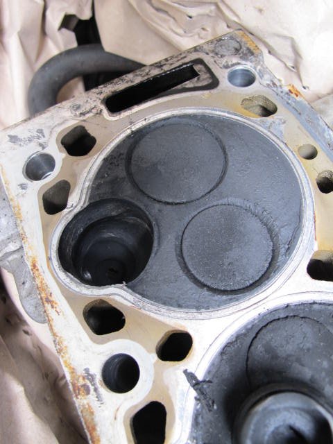

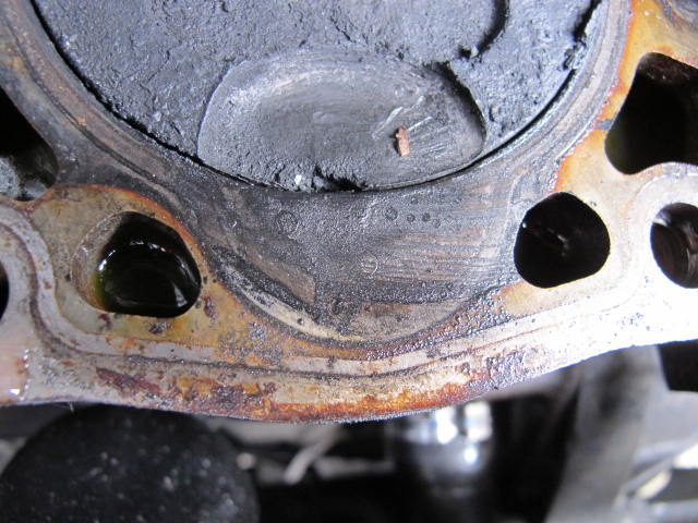

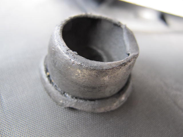

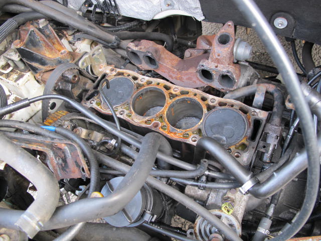

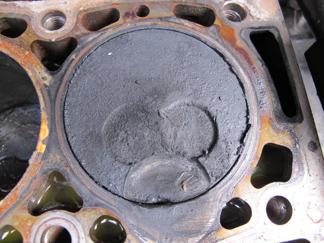

Some images of the mess

Looking at the photos even if you had a good cylinder head and new pistons etc. The damage to the cylinder block where the loose swirl chamber has worn the block would need skimming flat and then the piston height even with thicker gasket if available would probably be too close to cylinder head.
I have rebuilt Direct Injection diesel engines with the indents in the head and piston where broken valves have marked them and have recovered with maybe one conrod and a set of piston rings in a honed bore for it to run well, but the swirl chamber marks in block will be a problem for most engineers.:(
