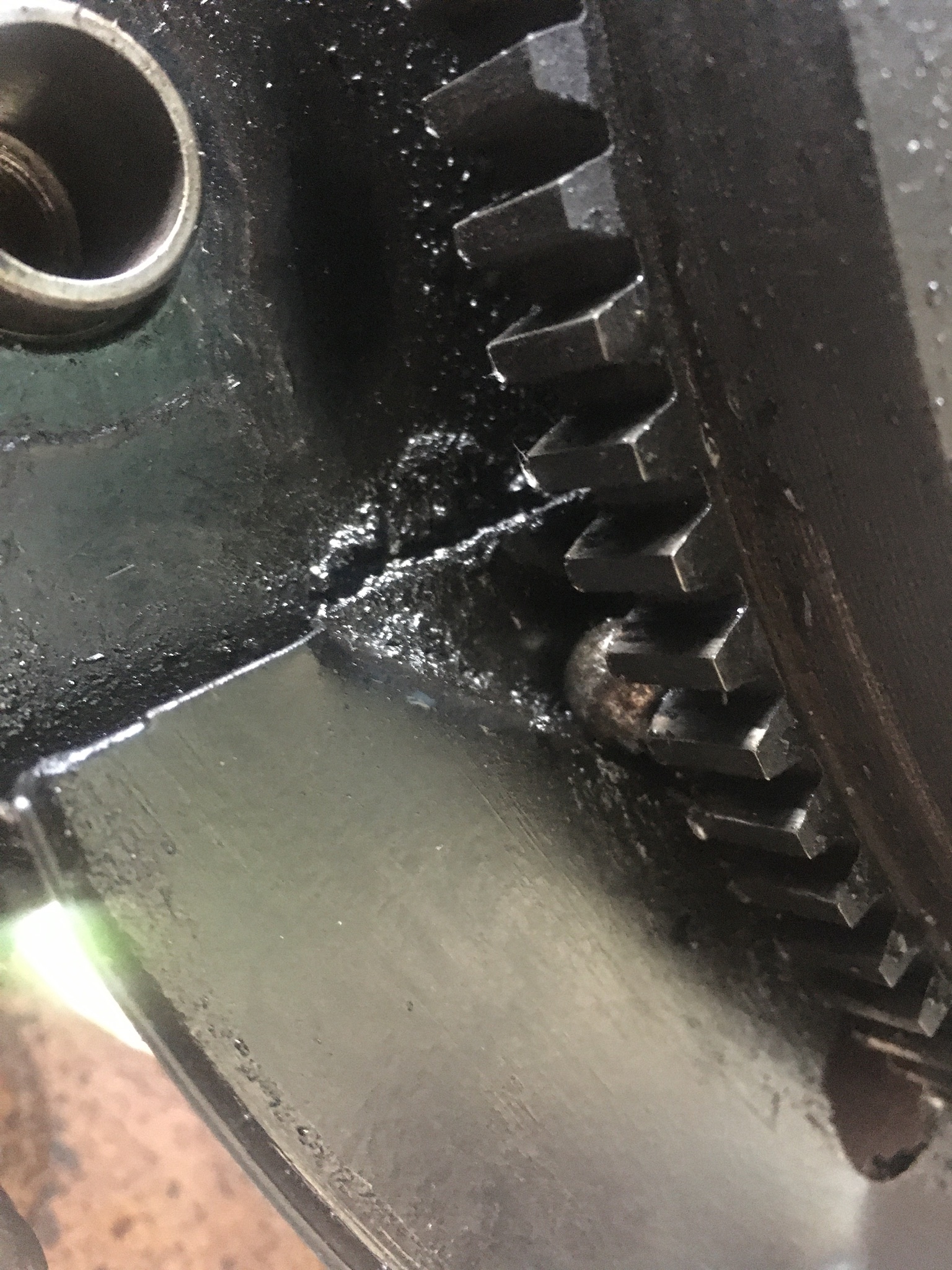

still leaking from sump seal, don't want to have to cut it all off again, any leak stop additives recommended? probably only works on seals not sealing compounds, looks like it's going back to a garage..
Need a bit more info
I suspect the replacement sump wasn’t quite the correct shape
It’s not unusual for pattern parts not to fit 100% without a bit of fettling first
Can you photo the leak. We might be able to sort something if it’s at the edge.
Thought i had put enough sealant on, i'll look under when the ground dries out a bit, can see the track coming from the flywheel end.
seemed snug when offered up dry, and all the holes lined up like a dream.
no leaks topside, seals where ok before, not saying much i know, but would be a bigger job again, gearbox unlikely, would mainly leak off the gearbox, lowest point. drips coming off the sump close to the plug, and that's tight and sealed.

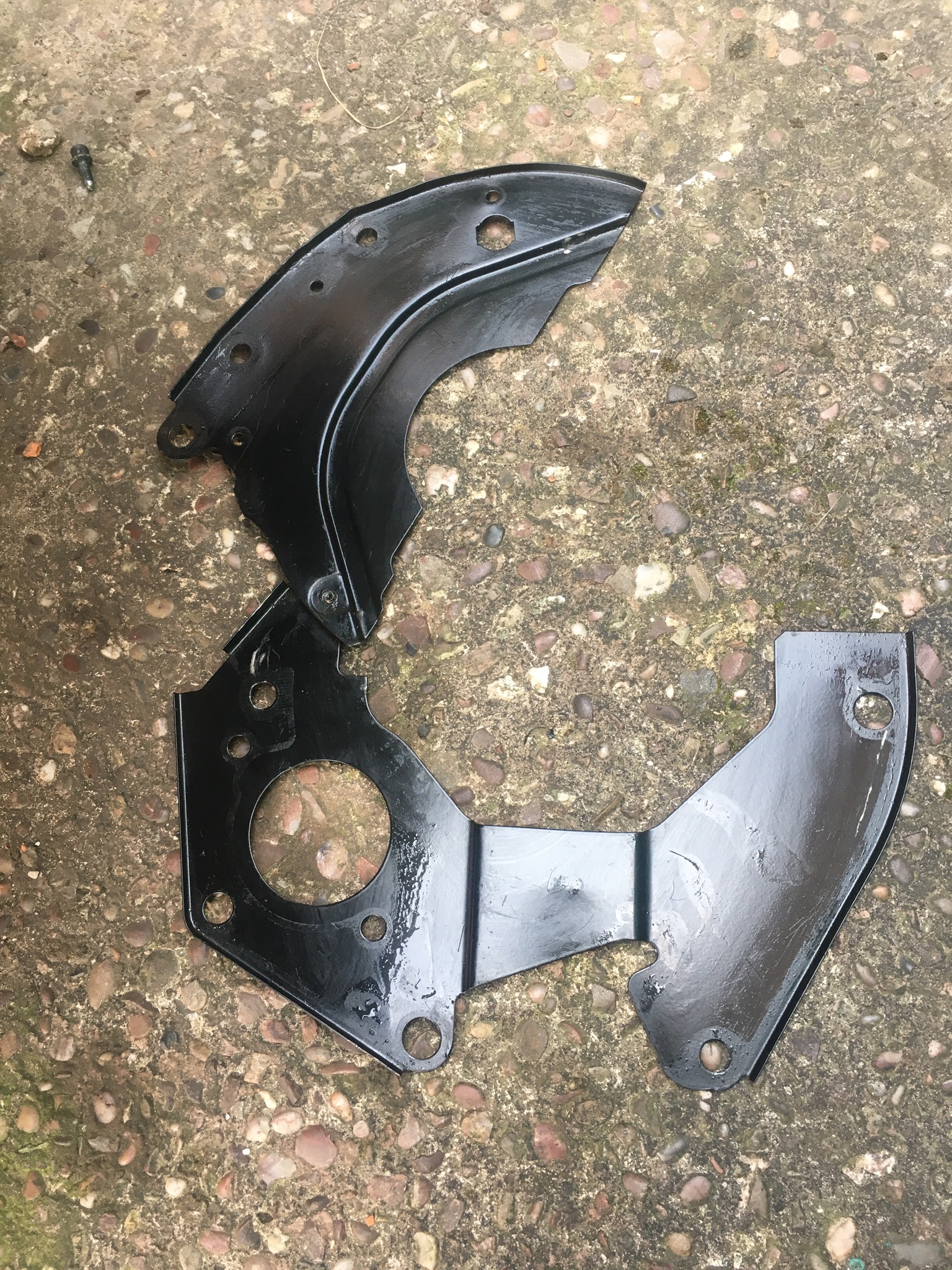

It can run down the inside of the bell housing and come out next to the sump
Here the covers from mine
But I don’t have a pic with them in situation

i hope not, that means the cars be scrap for me
There a very quick test If oil is escaping from the input/main bearing

I find it strange the new sump is leaking from the same place as the old. Although any failure in fit is likely to be around the curved sections.
Post a photo
Poke a finger through the inspection hole
