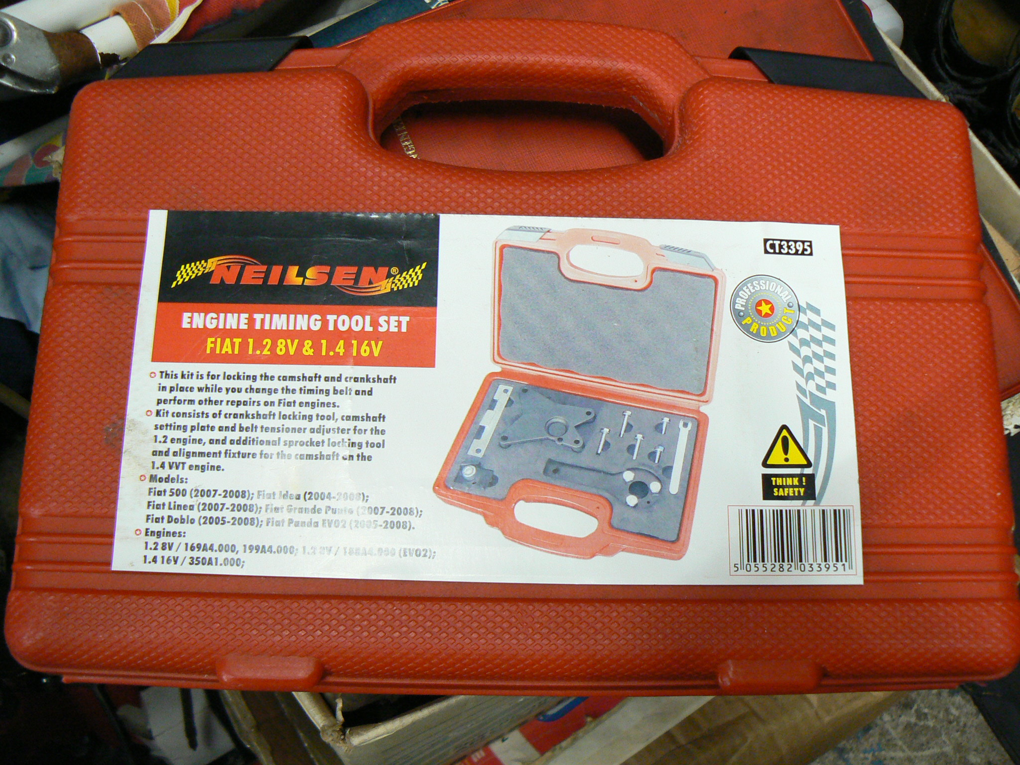

It's a Neilsen branded kit which I bought because I've got some other stuff of theirs and I find it robust gear (probably made in China though? Mind you there's some good stuff made in China these days!) - not in the same class as my old Britool stuff, but very acceptable for serious DIY tasks.

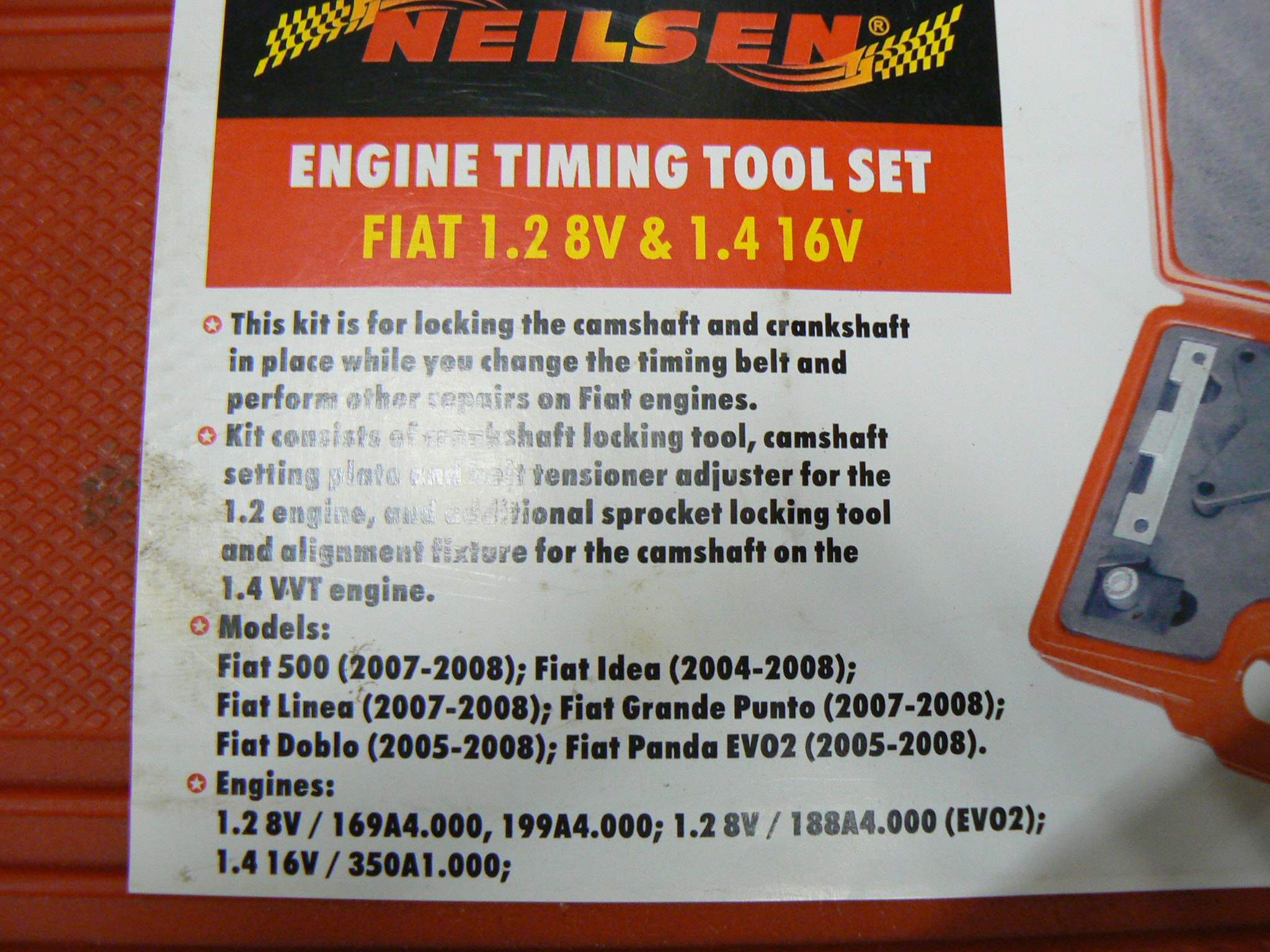

Here's the application recommendations in close up:
You'll notice it says it's suitable for the 16 valve and I notice many other versions of this kit (with differing brand names) make the same claim but I don't think it's right?

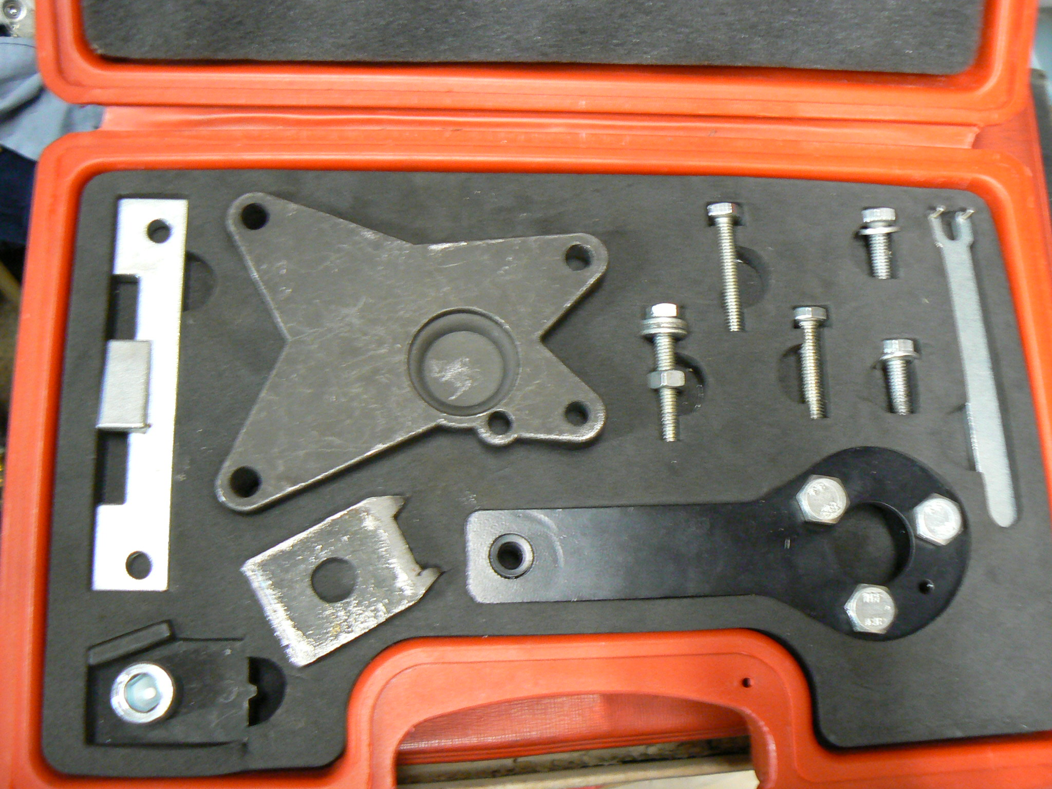

When you open the box you'll see this:

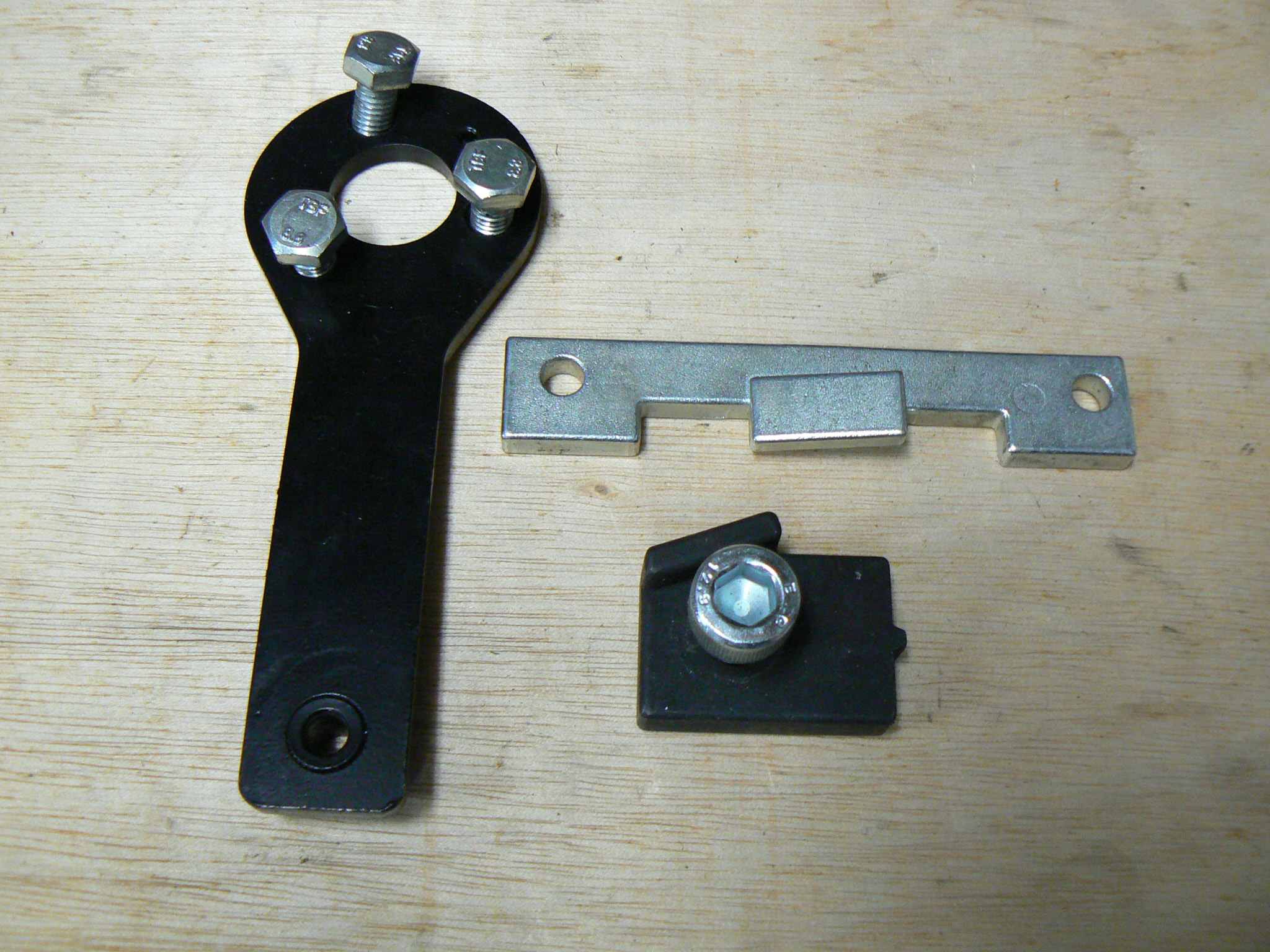

If we take these components first:
The "dumbell" shaped black thing is for locking up the crankshaft - by the way it locks the crank with all 4 pistons at "half mast" that is to say half way up/down the cylinders. The earlier engines, much earlier than ours, were timed by marks on the pulley and oil pump casing which set Nos 1 and 4 at TDC.
The silver bar with the offset "slug" is for locking the cam on it's back end (ie opposite end of the head from the pulley end so you need to remove the cam cover to do this.) The slot on the cam which it fits into is slightly offset so fit this locking bar first as you are likely to need to turn the crankshaft to get it to line up. Having done that then see if the dumbell fits onto the crankshaft. The crank pulley has a wee "pip" (you can actually see it before you remove the aux belt pulley (phonic wheel) so make sure that pip goes into the wee hole on the dumbell. The hole on the end of the dumbell's arm lines up with the belt guard's securing screw hole and you use that guard screw through this hole to complete the locking up. If you have correctly fitted the cam locking tool and then find the crank locking tool doesn't line up than your timing is out!
The wee black "widget" with the big allen bolt and wee tooth on it's right side is for locking the camshaft pulley to stop it rotating when tightening it if you have had to slacken it's retaining screw (this lives under the sealing screw in the middle of the VVT pulley centre. So the screw you see in the centre of the VVT pulley is just a sealing plug (with O ring seal) which you remove (rag needed under it to catch oil spill) to gain access to the pulley retaining bolt which is actually inside the pulley. If you have to slacken this bolt - probably a big Torx - then the wee black widget is used to lock the pulley and you'll need to hold the cam - don't rely on the silver locking tool, you need to remove it - when you tighten down the pulley bolt (70nm if I remember?) If you leave the silver tool in place and the cam moves at all during tightening, you may shear off the lug on the back of the cam!

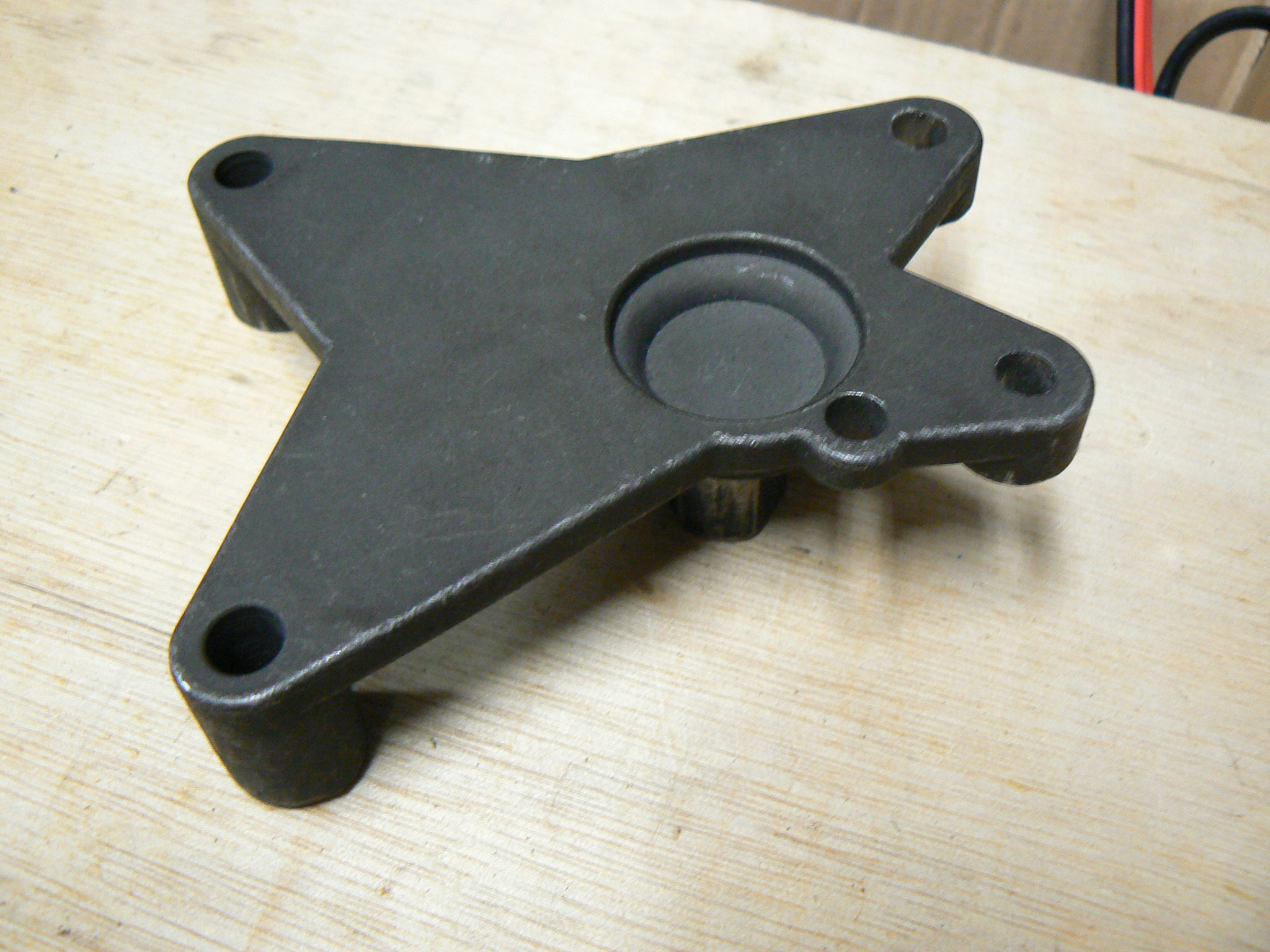

You'll no doubt have seen there's another big lump of metal:
This gets screwed to the rear face of the cam cover/cylinder head to keep them aligned as you tighten down the cam cover retaining bolts. I have to say I really couldn't see the point of this when I was doing my wee 1.2 Panda but realised what it's all about when I did my boy's Punto 1.4 8valve. It's all about setting up the cam sensor clearance. On my 1.2 the cam sensor reads off the cam sprocket (call it pulley if you like) somit's positioned on the "front" end, pulley end, of the cam cover. My boy's Punto has the cam sensor on the "back" end of the cam cover so the cover needs to be very precisely located fore and aft to achieve the correct gap between the end of the sensor and the slotted flange on the cam which it "reads" from. By the way, when you buy your new cam cover gasket - and it's a good idea to get a new one as they are known to leak with age - make sure you get a kit which includes the 4 wee O ring seals for the oil feed holes in the cover which feed the cam journals and VVT solenoid valve. Mine were as hard as old boots! Also, the gasket seals pretty well on it's straight runs but a wee bit of silicon sealant at all the corners works wonders.

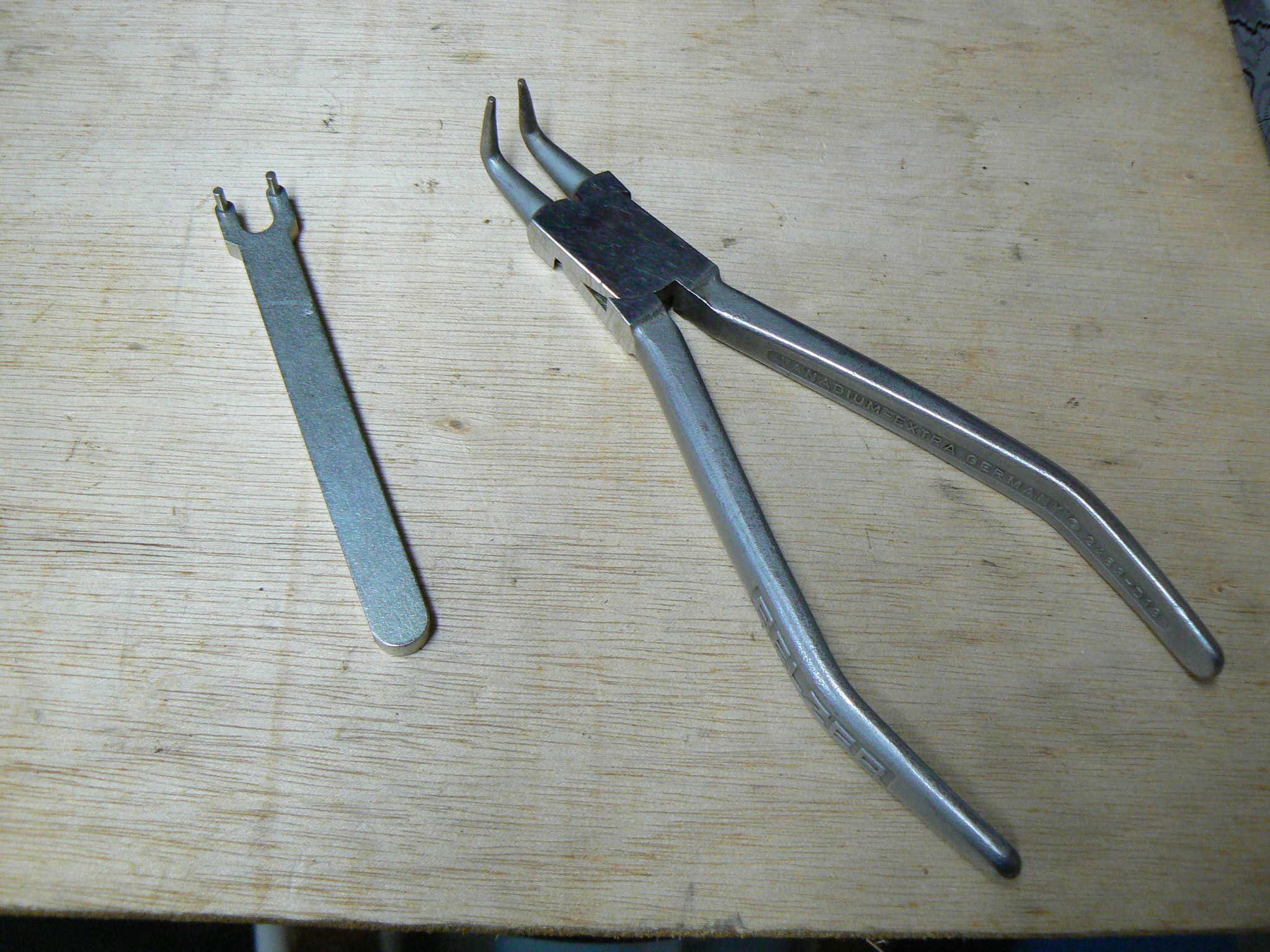

You'll have noticed the wee two pronged tool too? It's the one on the left here:
It fits the spring loaded belt tensioning bearing assembly so you can easily rotate it to apply tension. Many people have attested to it's fragility and have found the wee pins shear off. Mine's been Ok so far, but if you do break it a pairof right angle circlip pliers (see on the right) do the job just as well.
