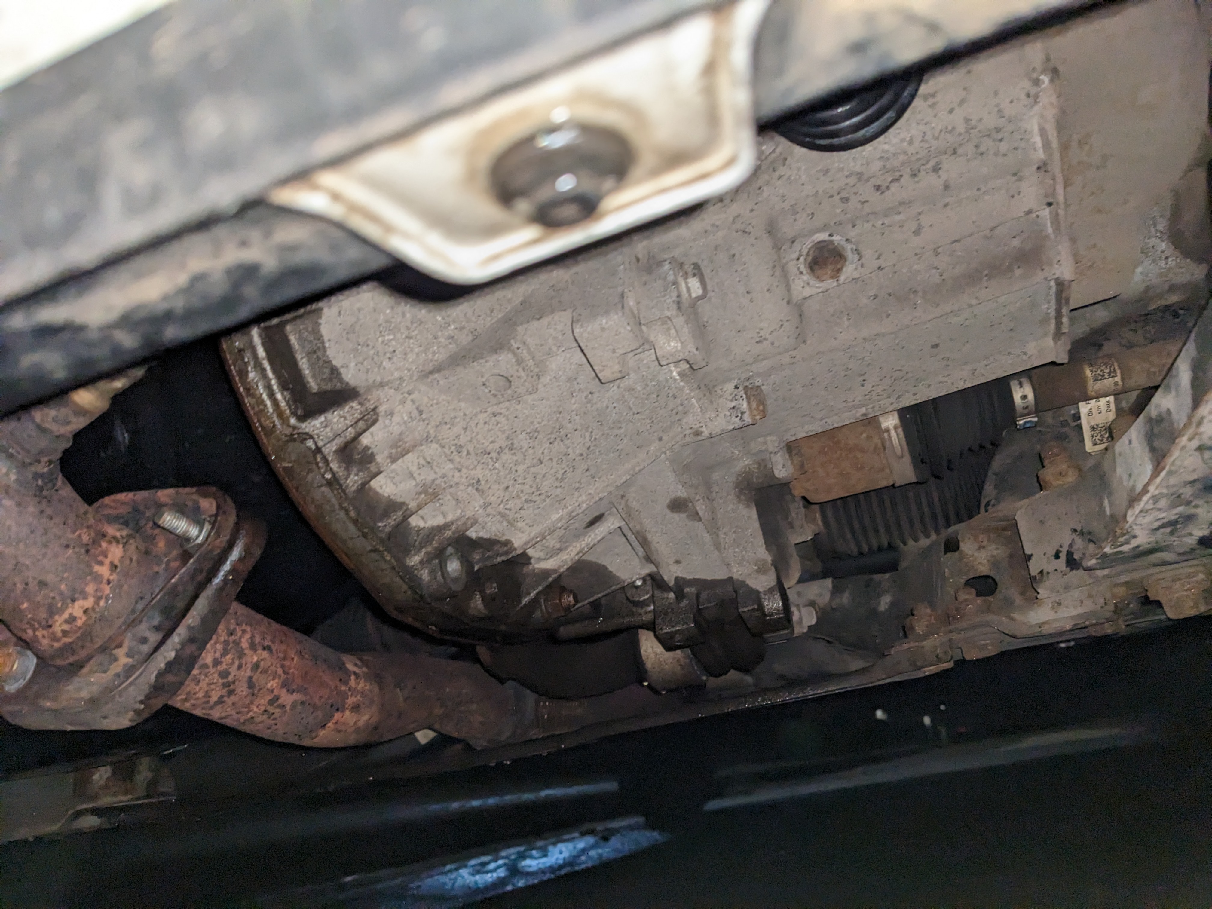

looking serious, dry when the sump was done,
I don't know the 1.2 engine but I do see oil on the exhaust clamp as well as the engine/gearbox casting. Since the two are not physically connected this says to me its dripping down from somewhere also it will burn off the exhaust quickly when running so this is leaking when engine off and cold? Is there a valve cover leak that occurred when VVT was being "sorted"? Twisted gasket?
My first Panda was a 2005 4x4 with the earlier (non VVT) 1.2 engine. It developed an oil leak from the rocker cover rubber seal at the gearbox end of the engine which led to oil dripping as you see. I replaced the seal three times with non Fiat parts, better each time but never right. In the end I bought the genuine Fiat part and the leak stopped. Is this your issue?
I've used gasket maker silicone (black or orange Permatex) on the valve cover gasket (rocker cover) and I've had zero leaks even with a cheap spare part gasket from Corteco. I probably used a little too much and some of it probably made its way into the bottom of the sump but there's no leaks. 💡 Less is more when using silicone.

Silicon sealant in the corners, applied sparingly, is the way I do it. Used genuine and factor supplied gaskets and not had any leaks

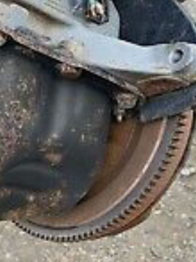

looking wet inside the bell housing, probability high of crank end seal being away.., rocker cover dry except around filler. not looking good..
not covered, clutch dust with a bit of oil, would expect more if the seal had failed.. not enough to clean the dust off, could be splashes onto the fly wheel.
No oil inside the bellhousing except at the bottom. It’s likely the input and main seals are fine

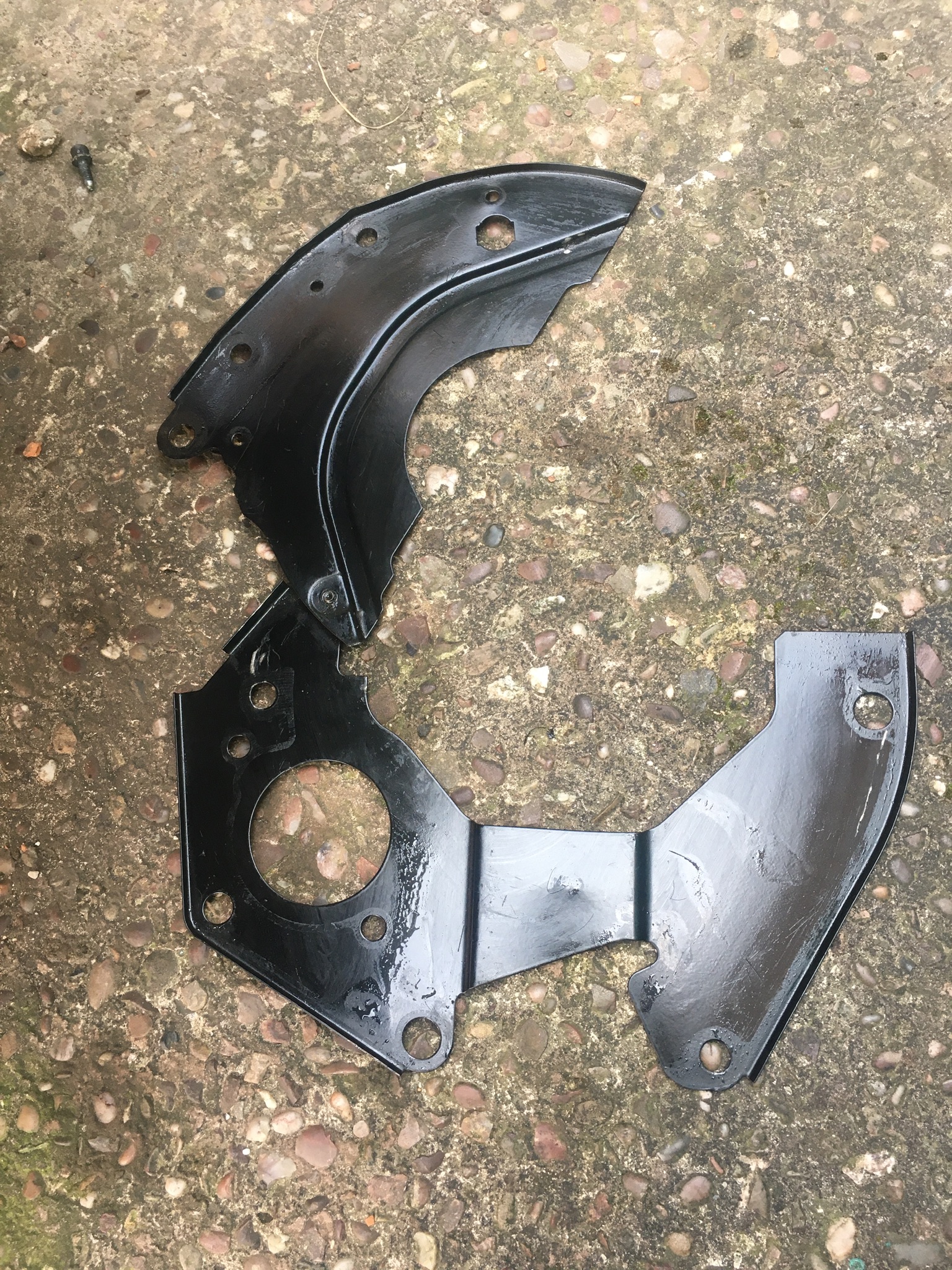

Being trying to think of an easy next step
I think the only option is to remove
These
And visible check if the oil is only below the level of the sump joint
i know the plate well, had to by a straight 19mm spanner especially for the stay bar, couldn't get a socket on because the exhaust was still attached at the time..
