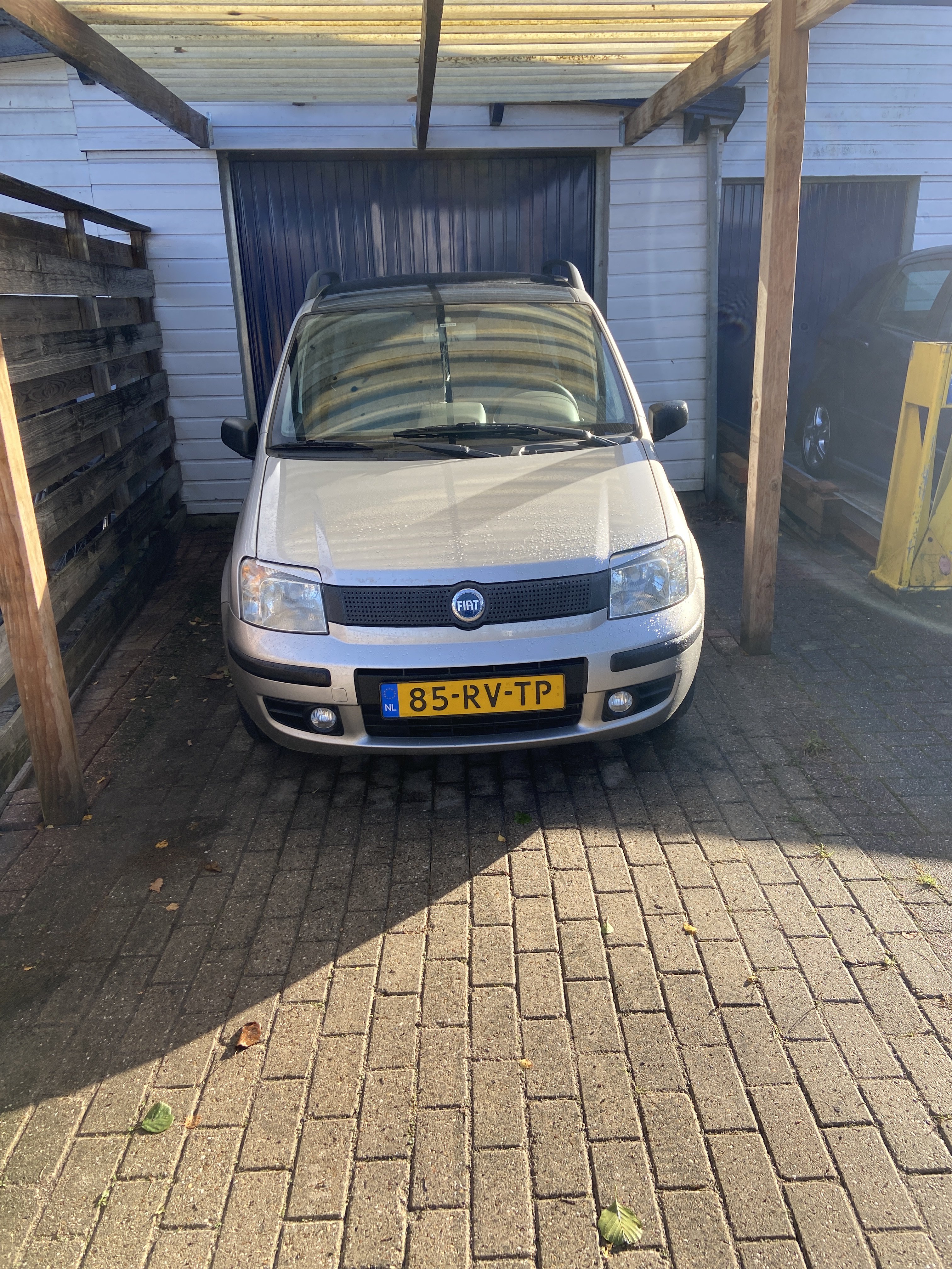

If the plastic has gone cloudy then the lacquer has failed. Only solution is to sand them down and polish.
Make sure to use a good quality UV protective headlight coating, otherwise it will quickly fade again.
