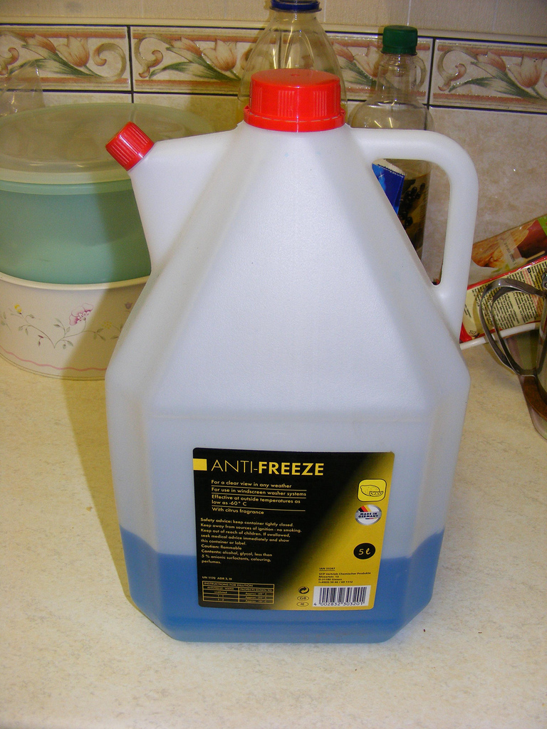

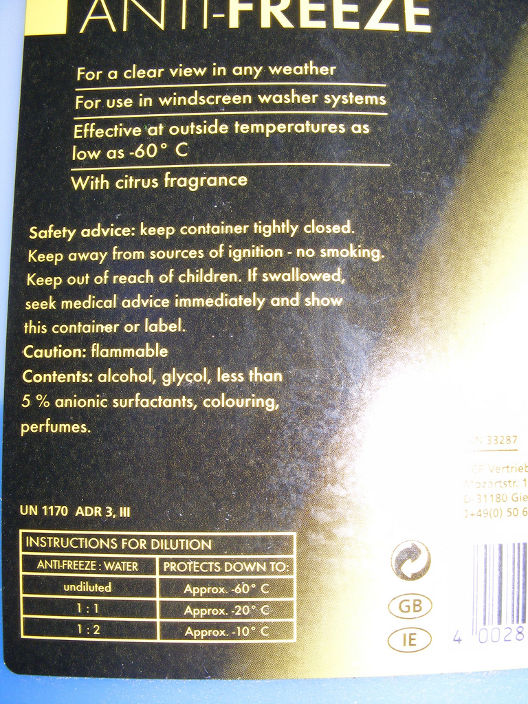

get yourself to lidl they have winterscreen wash in at the moment £4.99 for 5 ltrs i have been diluting it 1 ltr with 4 water not had it freeze in any cars yet and its been down to -8 or so on a couple of nights
