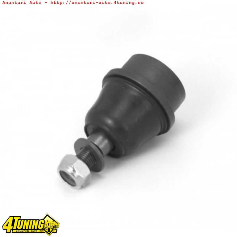

A pivot is what I wanted to say, I don't know if it goes by another name.
This kind of thing:
jackwhoo
Well-known member
Apr 8, 2017
4,753
I think it is a translation issue Jack, thank you.
This kind of thing:
Lower ball joint to us in uk :)
If worn they tend to knock rather than rumble like a failing wheel bearing.

Yes, that can happen but another case is when the rubber is worn out and gets cracked, dust and sand gets inside to the ball and it squeaks just like a worn out bearing.
