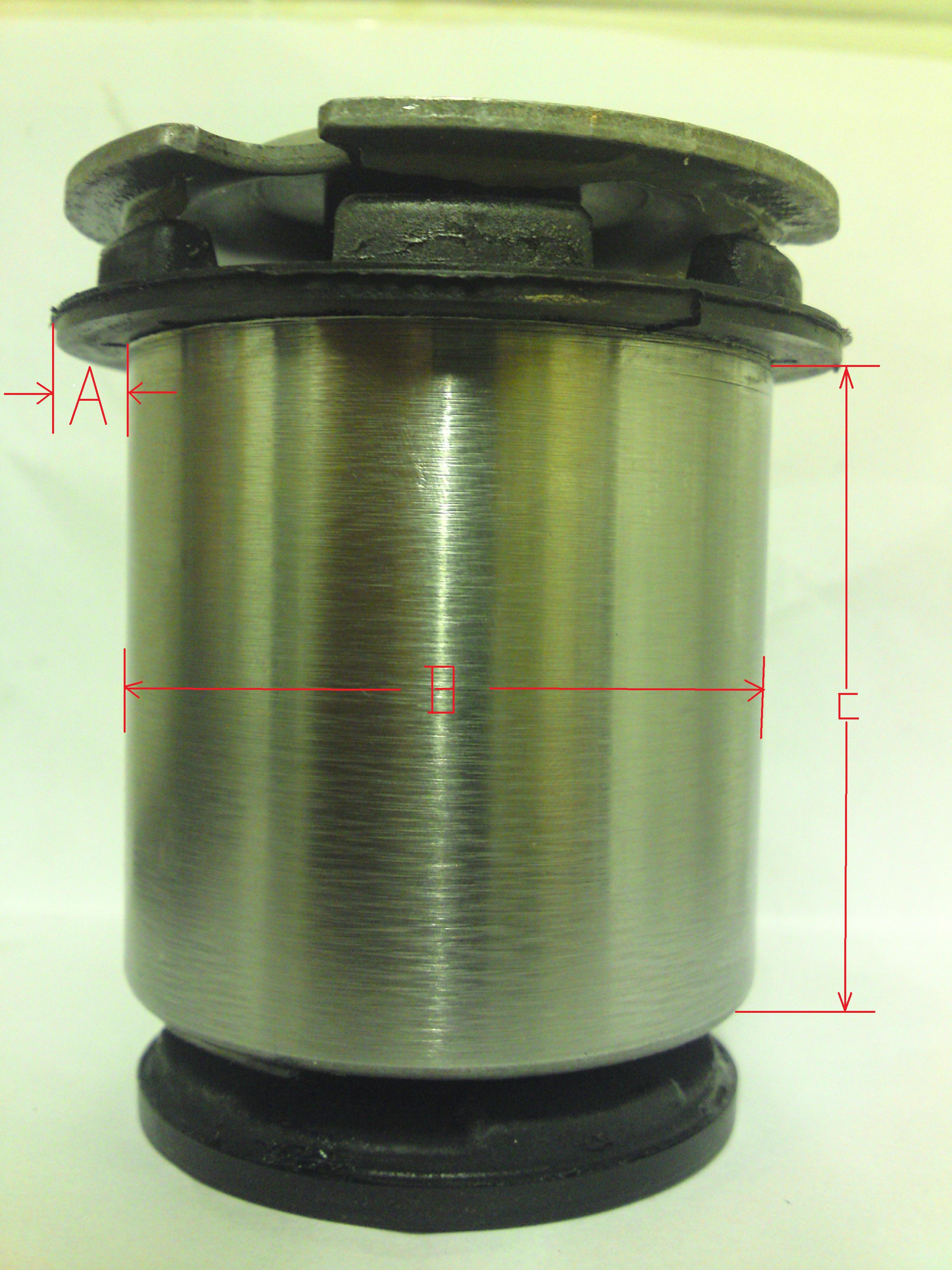

Not sure if it will be usefull to anyone but just took a photo of one of the bushes I've had machined down and here's some approximate dimensions.
A = 6mm
B = 67mm
C = 66mm

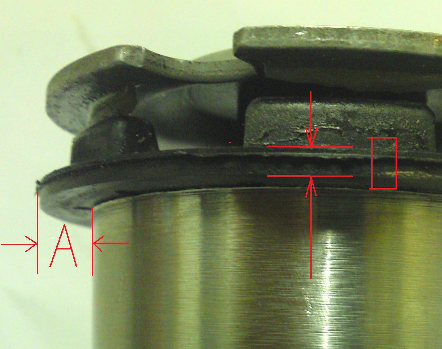

Thanks for that. The more information the better. Where is the 2mm lip and what are these "shoulders" measurements that the poster was referring to? Any ideas?
No idea. I saw the same post but was unable to find a 2mm lip anywhere.
My only guess was he ment the thickness of the shoulder? :confused:
"D" in the photo.

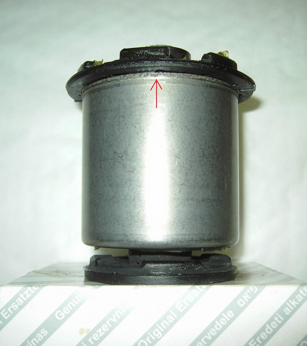

Both of my bushes have a small (approx 2mm) ridge just below the lip. I suspect it's formed during the manufacturing process of pressing the lip. This could be what the poster was referring to.
It's height above the main metal body of the bush in minimal. I can just feel it with a fingernail but if there isn't a corresponding rebate or chamfer around the inside of the axle housing, I'll file it off.

There was nothing on mine, checked them myself. I'll check my friends bushes Friday and see if his has the 2mm lip. No arrow printed on mine either. :confused:
Could the bushes be manufactured by more than one company? Different companies = different end products?
Hi,
Looking at davrens photo of the bush that "lip" is due to manufacturing from where the body of the bush was drawn from a flat blank. It is known in toolmaking as a pinch trim!
Cheers,
I suspect they're manufactured by more than one company and by different machines within the companies.

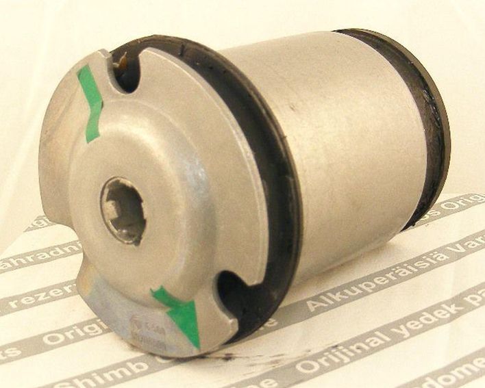

The arrow lines up with the small cut-out in the end of the bush. You can confirm it by comparing it with a picture of a bush with the arrow.
You can just see the half round cut-out at the 4:30 clock position on the end plate of the arrowed bush, the arrow points exactly in line with the cut-out.

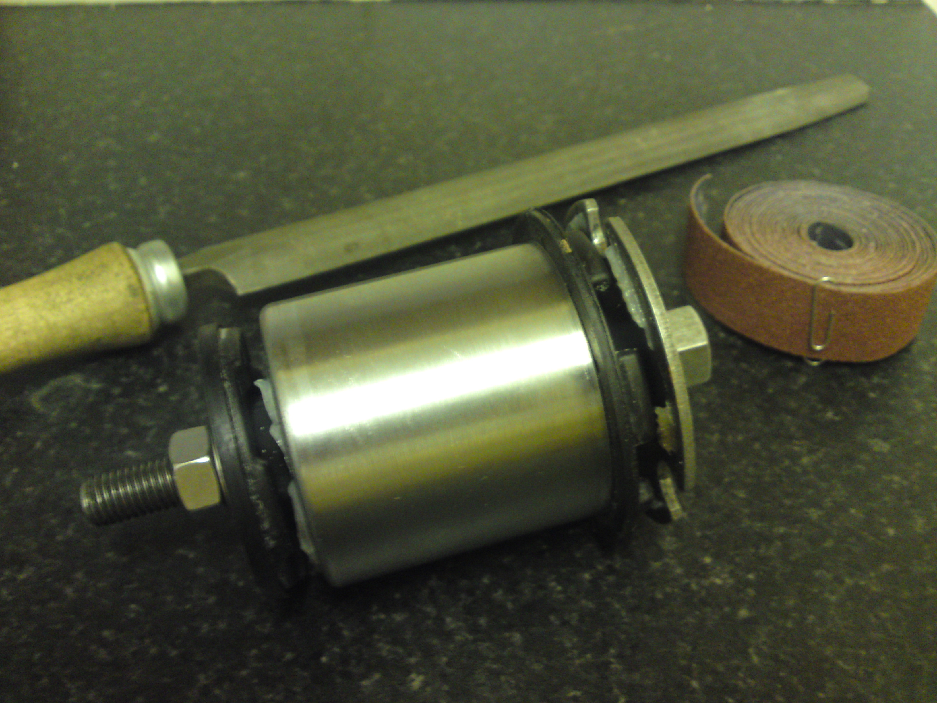

I intend to machine the bushes with a clearance of .05mm - .08mm (bear with me!!). I will then use loctite 660 and glue the bushes in.
That looks a very interesting approach - could be the key to the problem, if someone can supply skimmed bushes.
I had mine machined, reducing the size by 0.15mm. But as the sizes of the bore in the subframe can vary with age and model there is no deffinative size to reduce the bushes to. A DIY approach could be used, lock up a bolt or althread through the bush and then hold it in a drill. While spinning the bush a file or emery cloth could be used to reduce the bush size to a more managable fit. I'm not sure reducing the interference fit to 0 would be a good idea?
