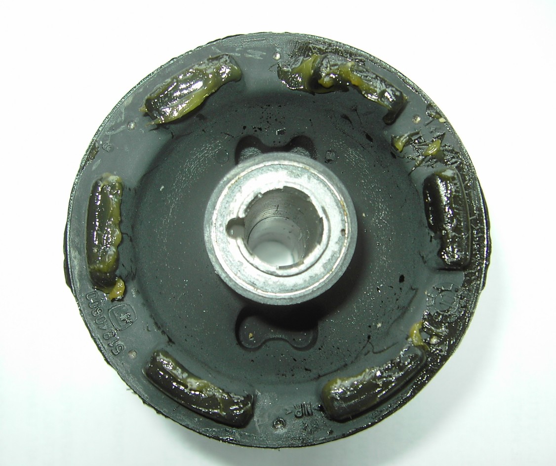

This end on picture of a new bush with the metal plate removed shows two hollows in the rubber. The small cut-out in the center tube is the direction the arrow would point to, so the two hollows would be top and bottom when the bush was fitted to the car.

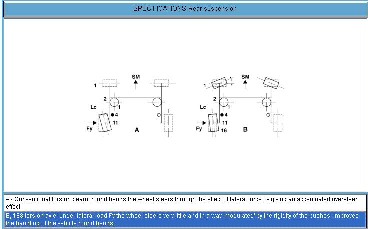

I would think it's the angular lateral movement of the beam when cornering that needs to be firmly controlled and not allowed to go wild so that's why the bump stops are aligned in that axis. Then even when the bush fails and loses all its oil there would still be yaw control of the beam in corners and the flapping and knocking free movement of the beam would be just in the vertical plane
That's why, when the bushes fail, people talk of a banging at the back on bumps rather than a loss of control of the rear end
The unusual design of the rear subframe is designed to tighten up the rear of the car during cornering. I was given the Truck of a Skateboard as a simplified example of what the rear subframe does on a Stilo. The bushes are the most important part of this clever design. The stops/buffers and chambers need to be in particular positions to allow this to happen correctly. So the orientation of the bushes when being fitted is critical to the performance of the rear end of the car, whether that be its ability to silence uneven roads, cornering or just how long the bushes last.

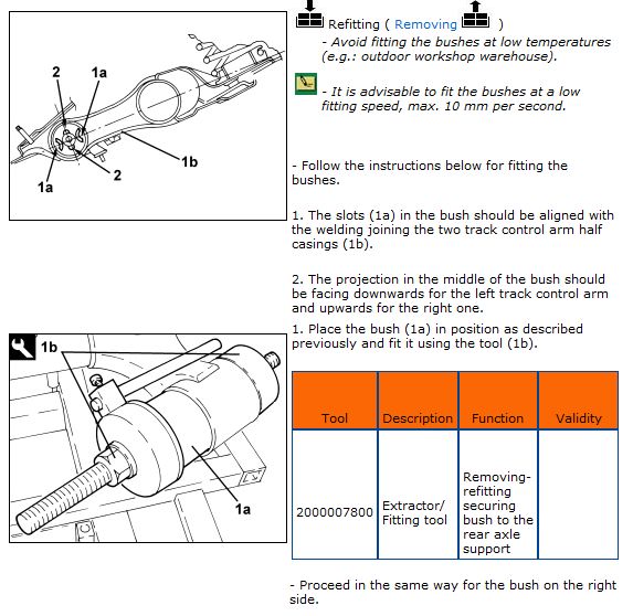

This is similar to the instructions in the Grande Punto eLEARN except that it says the small cut-out in the center of the bush should point down for the left bush and up for the right bush. This means the GP bush would be fitted 90° different to the Stilo bush. :confused:
I'm beginning to think that although the GP and Stilo bushes are the same now, they may not have been the same when the GP eLEARN was published. This could also explain why the GP tool I bought appears to be of no use to the current Stilo bush.
